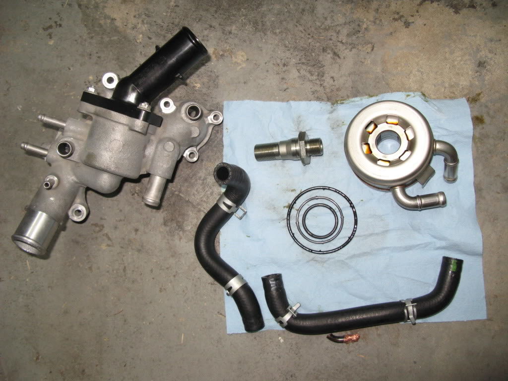

  12. Mar 13, 2010 at 8:18 PM
    SpaceMonkey
    SpaceMonkey [OP] Well-Known Member
    Apr 12, 2009
    #15886
    600
    Houston, Tx
    06 PreRunner
    Here is a pic. Is there anything missing?
  13. Mar 13, 2010 at 8:43 PM
    Coupe
    Coupe Well-Known Member
    Feb 10, 2009
    #13485
    2,043
    Houston, Texas
    08 X-Runner
    Lots baby!
    That looks complete.
    Good Buy.
    You will need to swap out the thermostat. As I remember you have an X-1.
    I suggest you use the Toyota silicone for this and you it on both sides of the thermostat.

    Thanks Coupe! I'll PM the seller. Where can I pick up toyota silicone?
  15. Mar 13, 2010 at 8:53 PM
    Coupe
    Feb 10, 2009
    #13485
    2,043
    Houston, Texas
    08 X-Runner
    Lots baby!
    The dealer.
    Torspd hooked me up with it.
    A lot of people have leaking problems with the X-1 thermostat. The people that use the Toyota stuff (apply it both sides of the thermostat) do not have problems.
    I used it. So far so good.
