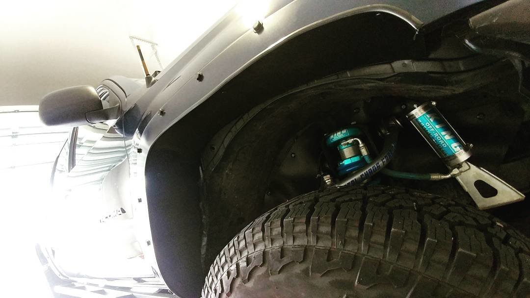

    When I cut for 35's I made a set from some plastic sheeting i bought on Amazon.
    Cut tabs out of original fender and bent over for mounting holes.
    Made templates out of cardboard. Cut the plastic to match. Used a heatgun to better mold in place.
    Stainless steel HW. Use some edging material to fill in imperfections, and but against the inside of the flare.
    Time consuming but it works. No loud aluminum getting hit by gravel.

    Fuck paying $500 for liners lmfao. I bought a sheet of HDPE. Here's an old shitty pic of when I did mine
