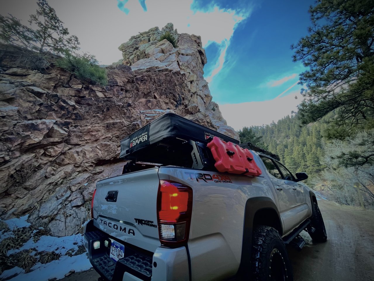

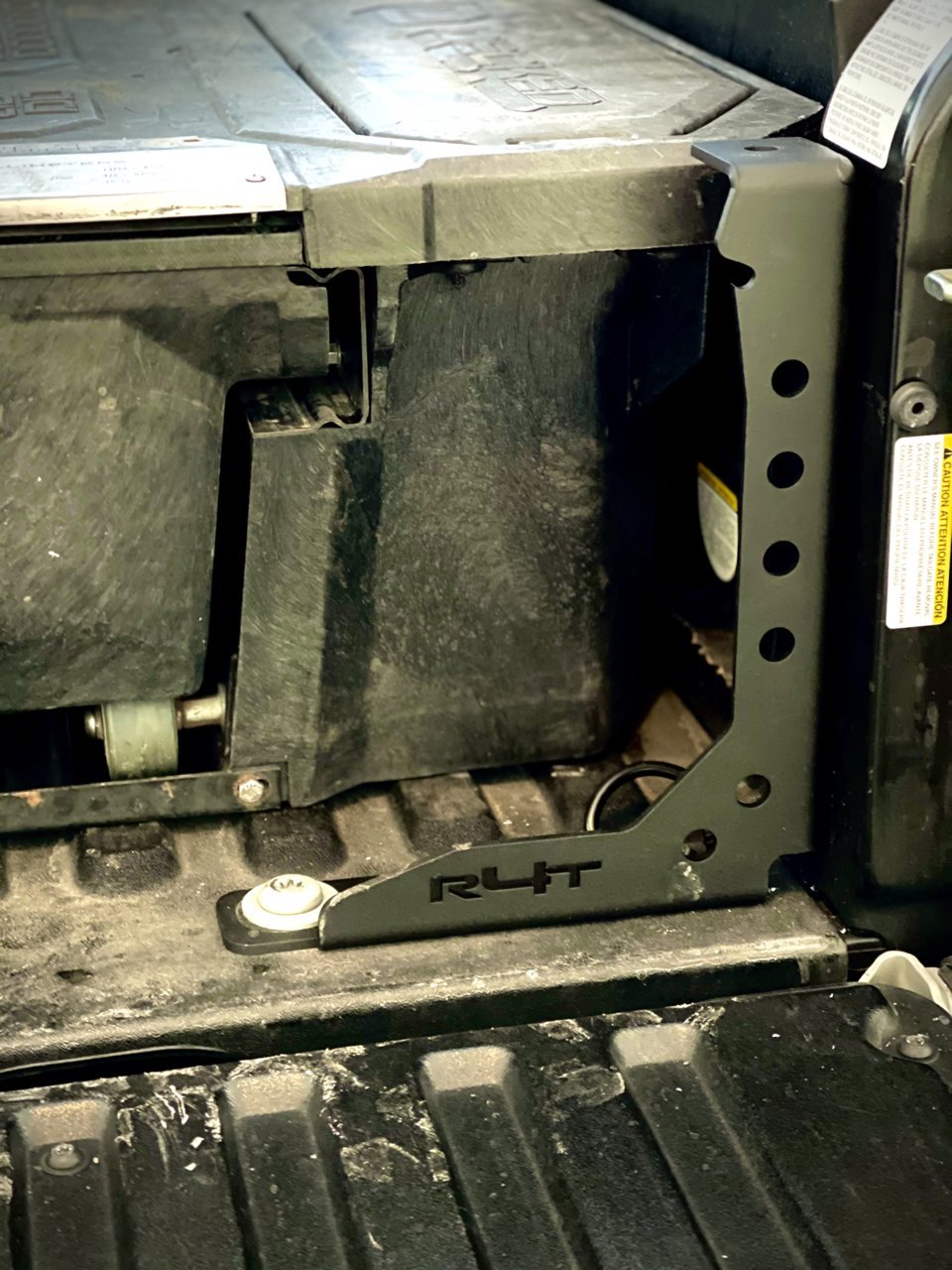

    @runnin4tacos bed stiffeners on today. Feel pretty beefy.
    Just snowed in Colorado so the bed is a bit ... “moist”

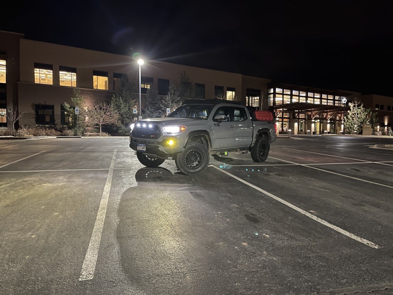

    Also swapped the CaliRaised pods for @Baja Designs Squadron Pros (clear).
    To be fair, the CaliRaised are a great bang for the buck light kit. But 2,500 vs 4,900 lumens is a needed jump.

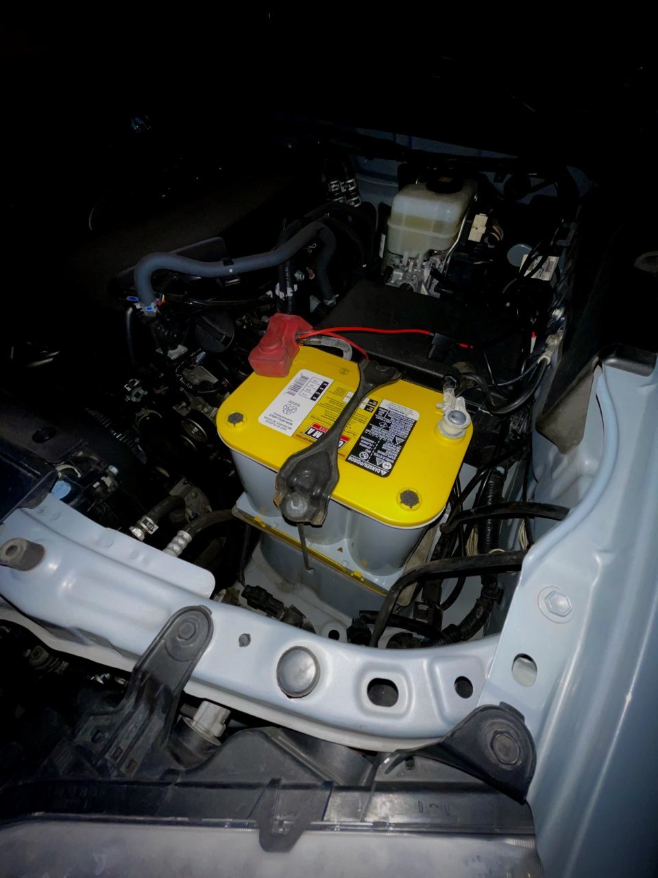

    Power Tray came in and added an Optima YellowTop AGM battery and an MWD decal.

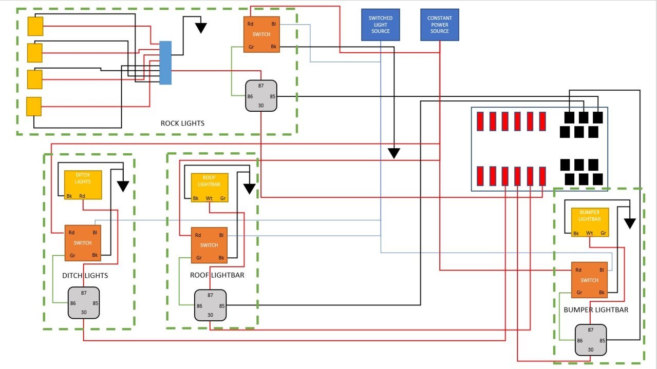

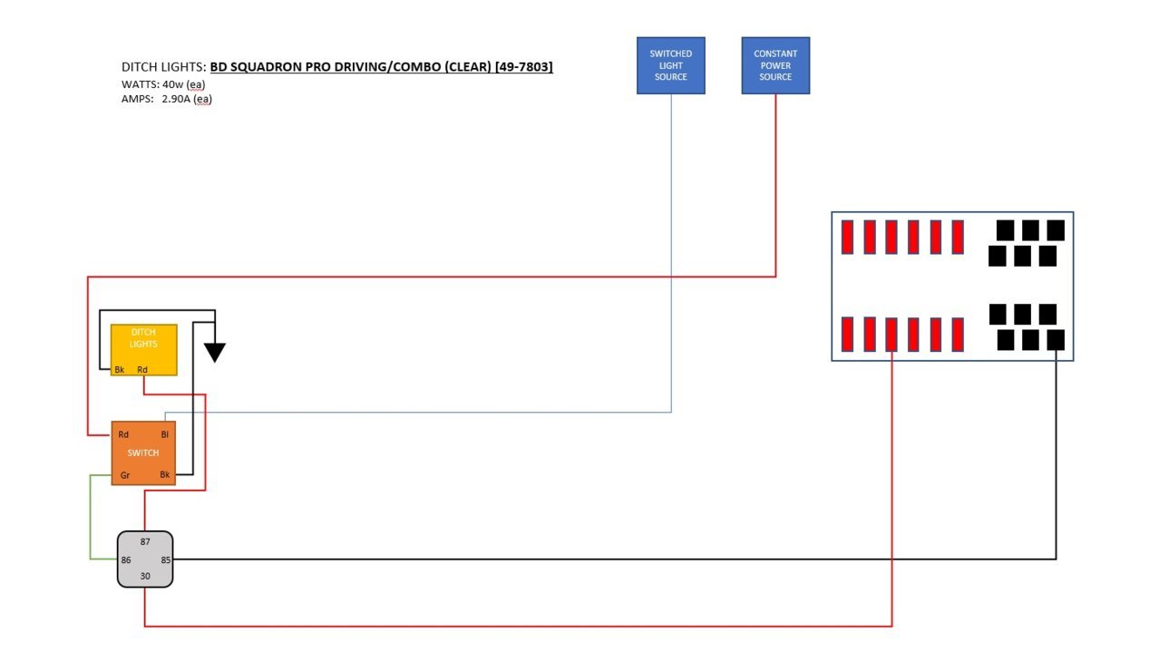

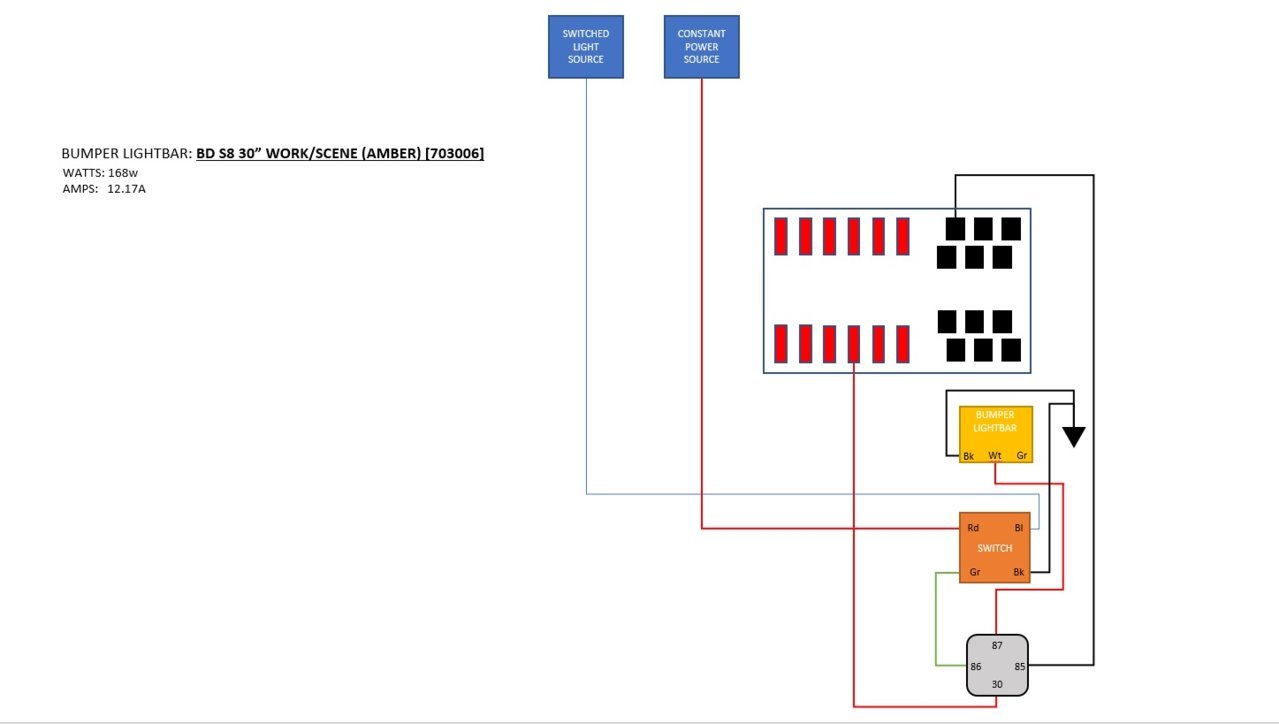

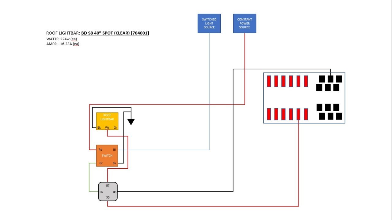

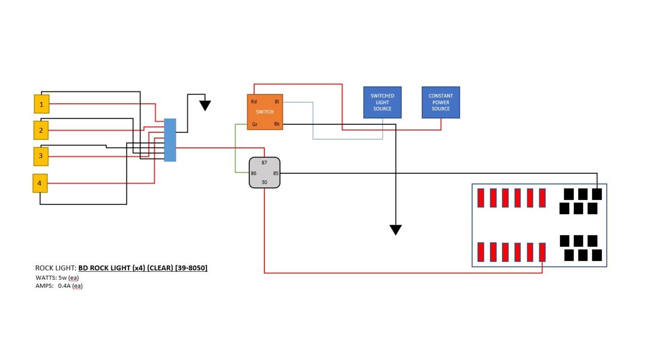

    With all the lights coming in (S8 is still OTW), I figured it’s time to start sketching out a plan:
    Components:
    • BD Rock Lights (Clear) [39-8050]
      • Watts: 5w (ea)
      • Amps: 0.4A (ea)
    • BD S8 40” Spot Lightbar (clear) [704001]
      • Watts: 224w
      • Amps: 16.23A
    • BD S8 30” Work/Scene Lightbar (amber) [703006]
      • Watts: 168w
      • Amps: 12.17A
    • BD Squadron Pro Driving/Combo Ditch Lights (clear) [49-7803]
      • Watts: 40w (ea)
      • Amps: 2.90A (ea)
    • PowerTrays Blue Sea 12 Circuit tray w/ accessory bundle
      • Blue Sea 12-circuit fuse block
      • Blue Sea MRBF terminal fuse holder
      • Busman 100A circuit breaker
      • 125A MRBF fuse
      • 18” power cable
      • 6” power cable
      • 22” ground cable
    • Miscellaneous
      • 16 AWG SXL Primary wire
      • 4-pin relays
      • Soldering equipment/supplies
      • A buddy who know electrical stuff
    Oddly enough, there really isn’t a whole lot of help with anything electrical. So I put together some general guide/wiring schematics:

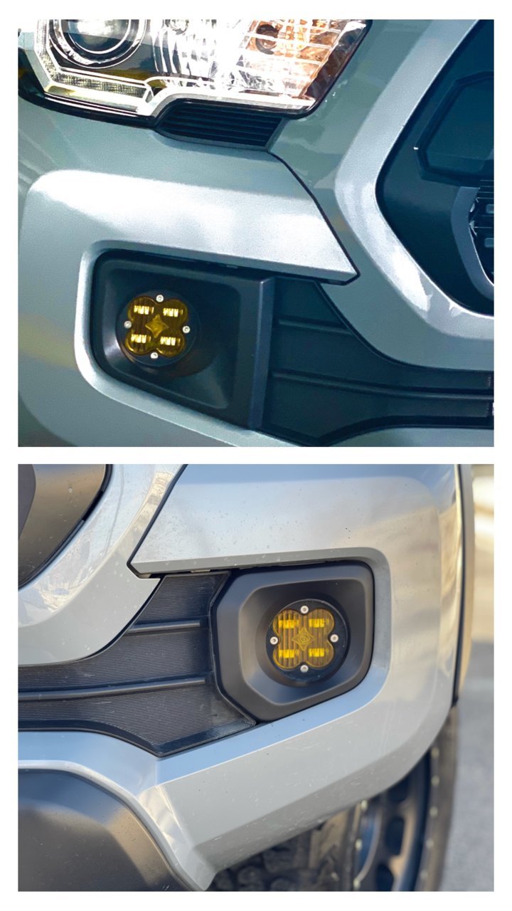

    Changed the TRD OR fog bezels for a set from the SR5.
    It’s subtle but cleaner, I think.
    jgr81, jswihart and V1cmlb like this.
  14. Feb 11, 2021 at 4:05 PM
    #74
    V1cmlb
    V1cmlb Member
    Jan 29, 2019
    #281082
    9
    California
    2019 Cement Tacoma TRD off-road
    Looks really good is it a simple change or did you have to mod anything?
  15. Feb 11, 2021 at 4:15 PM
    #75
    Apollo14
    Apollo14 [OP] EEF Brand Ambassador
    Jul 27, 2018
    #260738
    1,584
    Jonathan
    Vail, CO
    2018 Cement Taco TRDOR DCSB
    One-for-one swap.
    Part numbers:
    • 52128-04020
    • 52127-04020
    V1cmlb[QUOTED] and jswihart like this.

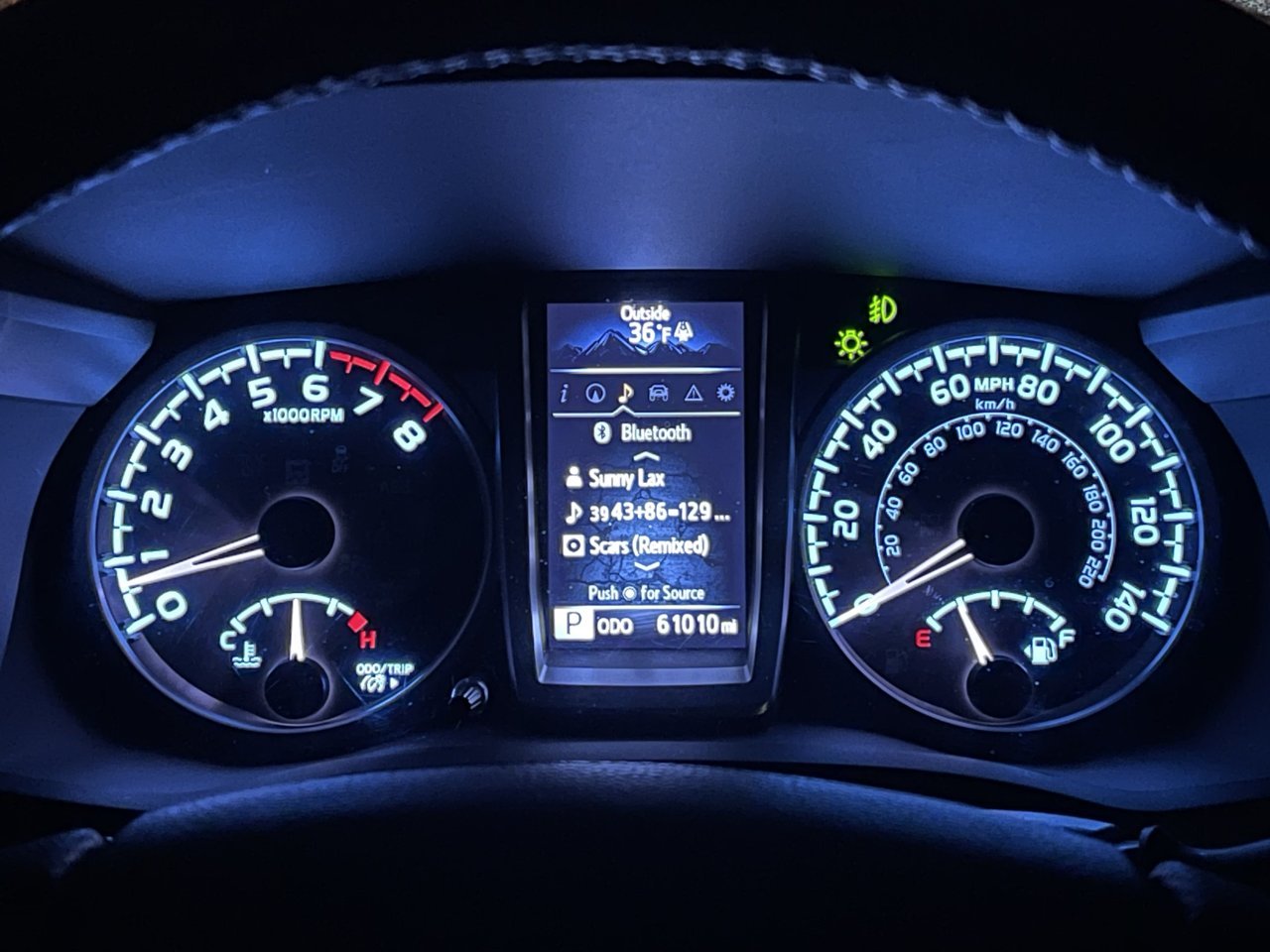

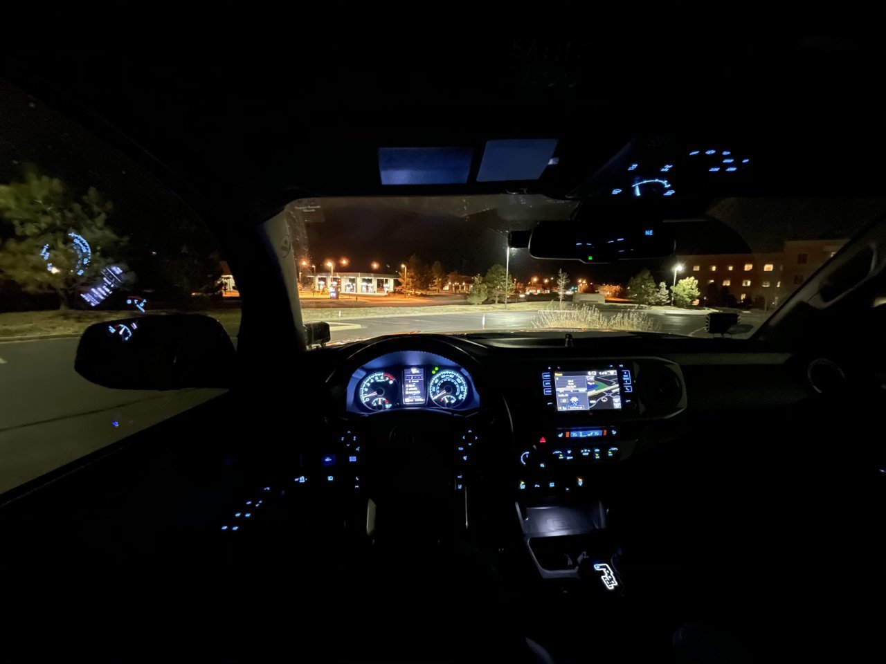

    I've got to figure out how to get my center info area in between the gauges to show music...did you have to do anything special?

    The right side arrow pad press l
    eft or right to cycle through the screens. The up and down for screen specific info/controls.
