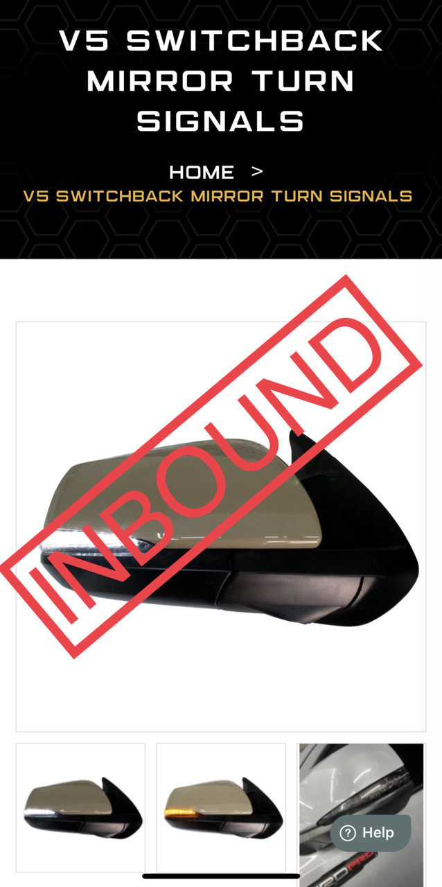

    Do you already have turn signals in the mirrors?

    yes. The were just the Regular Ultimate turn signals. They still look and work great.
    But these are “squential-y” and stuff. :cool:

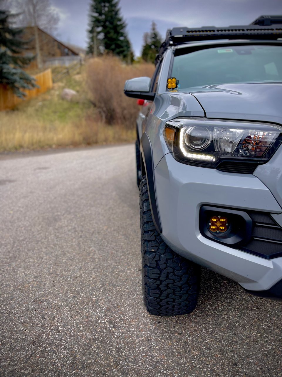

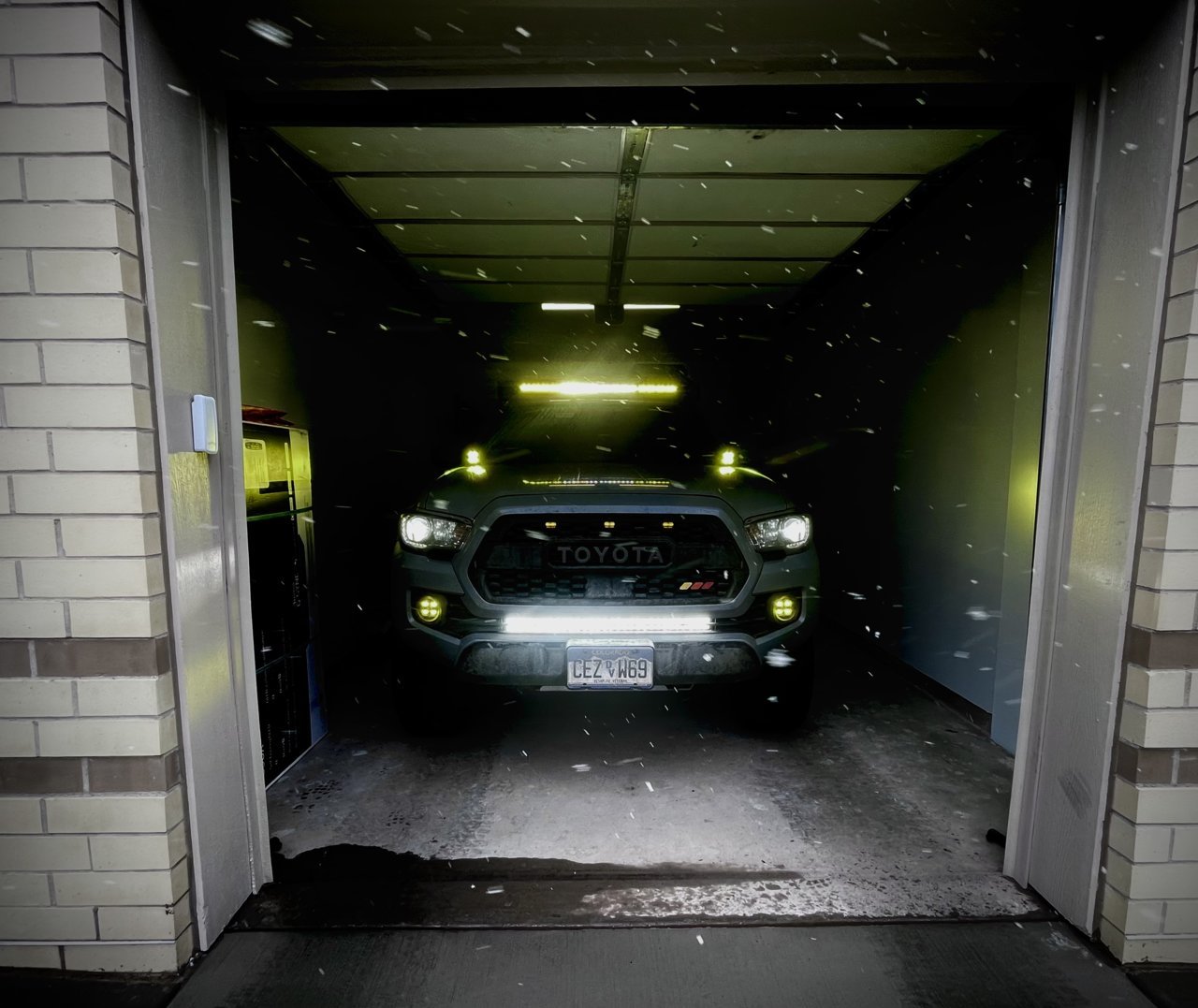

    Temps are dropping in the mountains. Highs in the upper 50s to lower 60s during day and 30s-low 40s at night. Time for a little light test as I start getting ready for winter. ❄️
    (Headlights vs full forward light blast)
    @CaliRaisedLed
    @Baja Designs

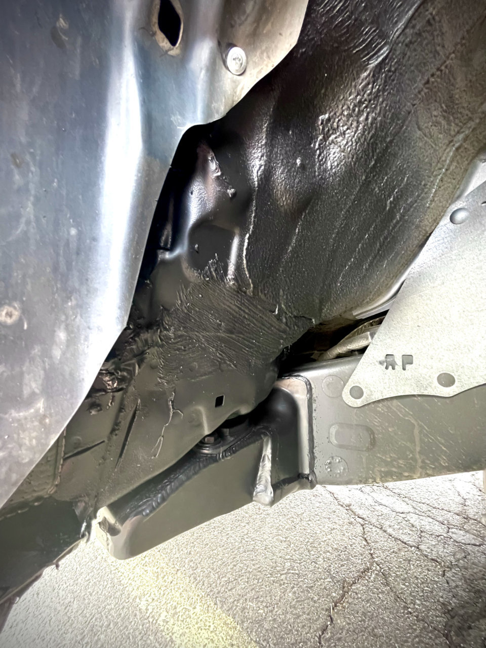

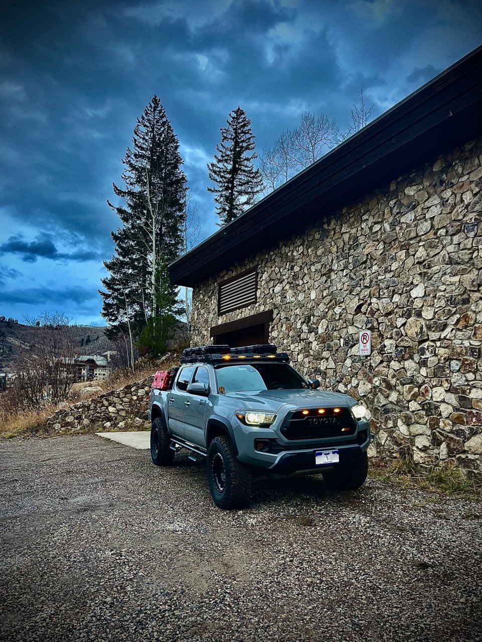

    Also stopped by @Running4Tacos for the Deaver, flip kit, bump stop install with CMC to get ready for the 35s coming in.
    :cool:
    It also seems that no matter how cool I think truck is, when you park next to Twon, you automatically lose 80 cool points. o_O

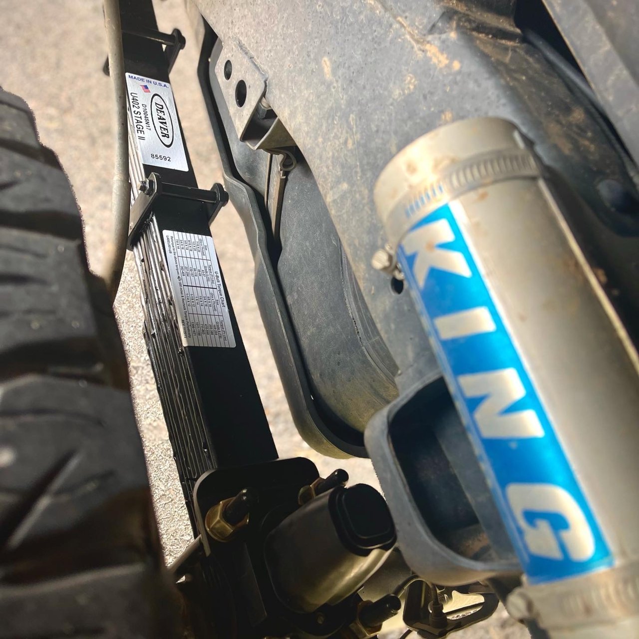

    Deaver Stage 2 rear leafs and DuroBump front/rear bumps with flip kit is on.
    Also, the CMC from @Running4Tacos looks legit. THICK welds and good coverage.

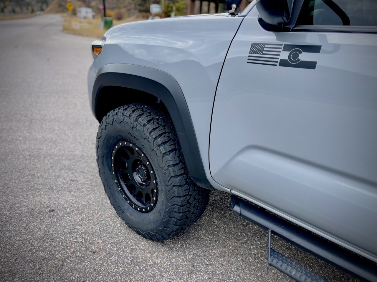

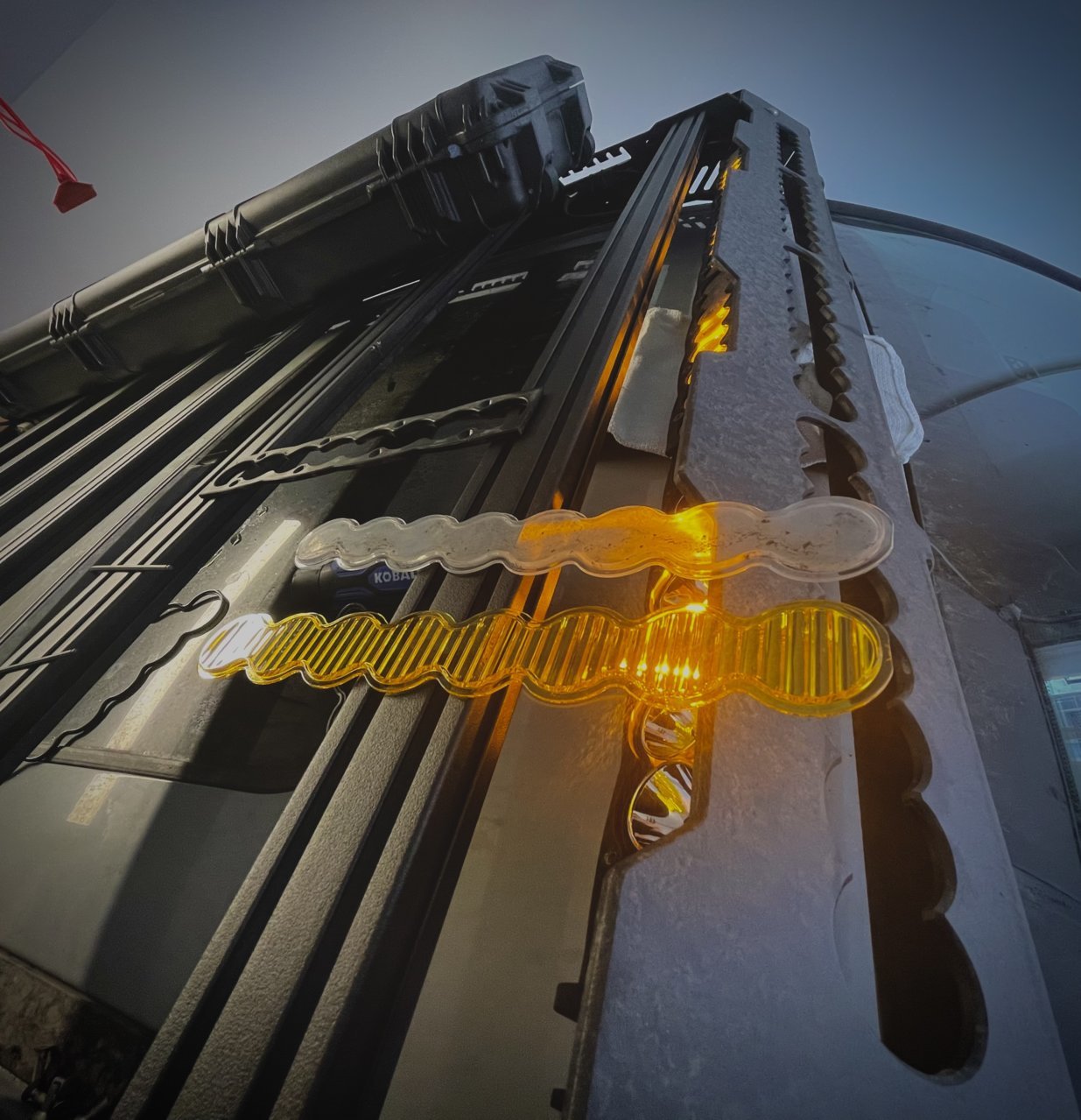

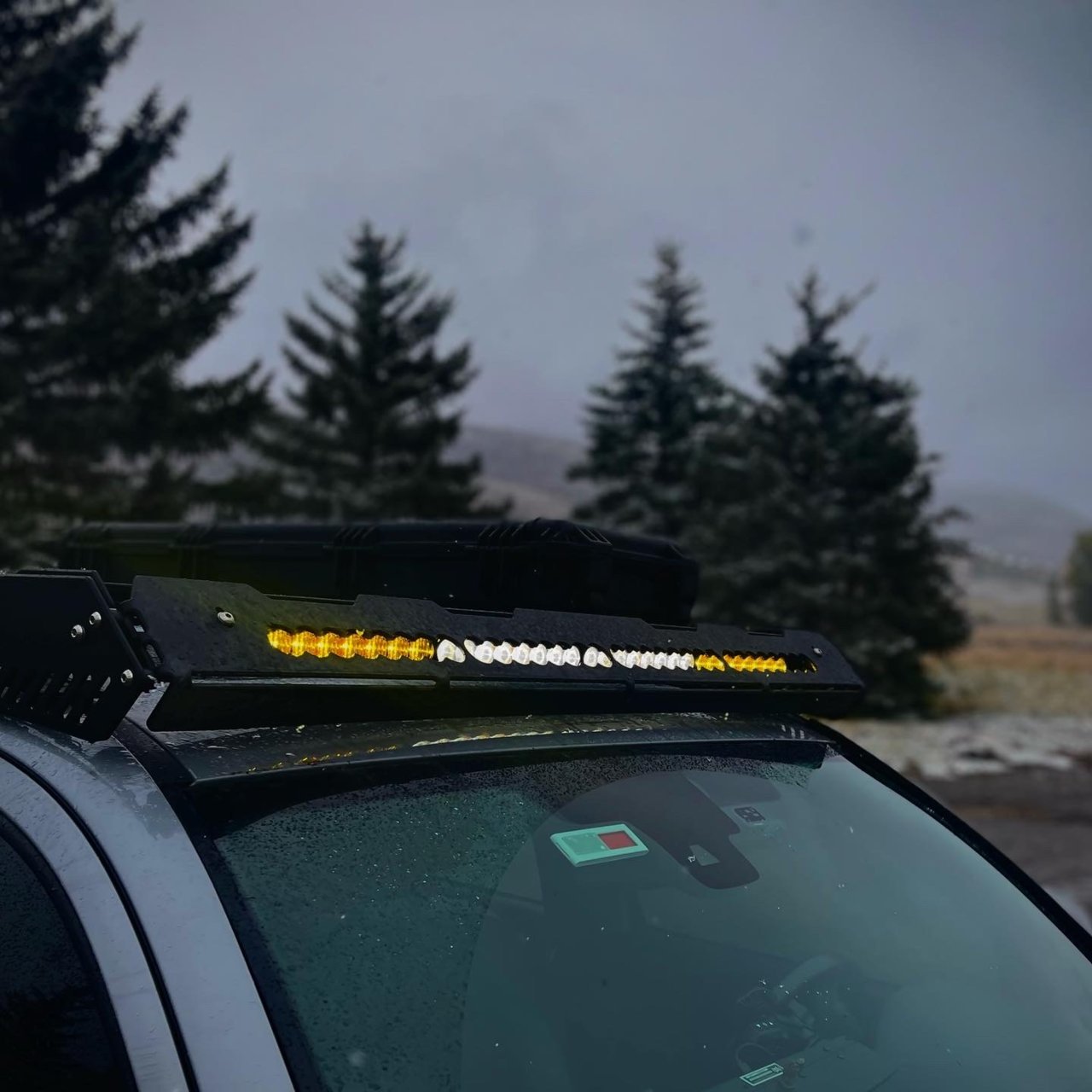

    Swapped a set of amber wide cornering lenses into the S8.

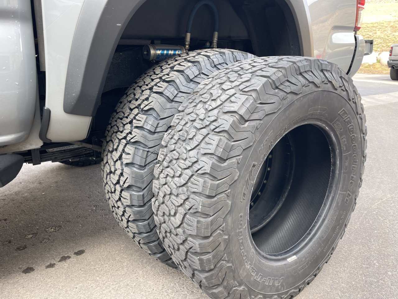

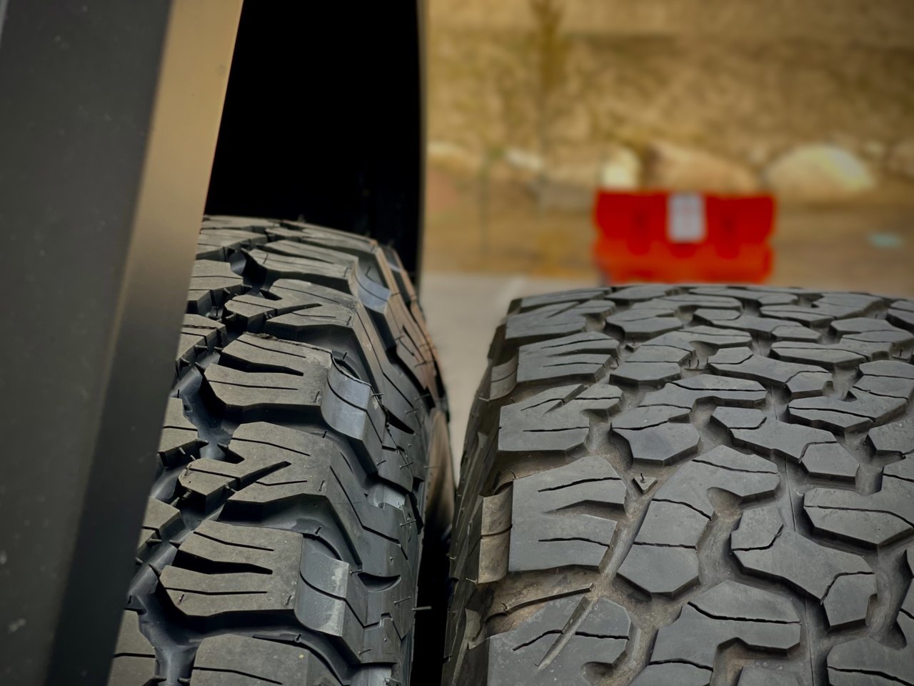

    Last day exploring Colorado on 33s. :headbang:

    Dropping some bigger stuff today….

    New tires are on. :cool:

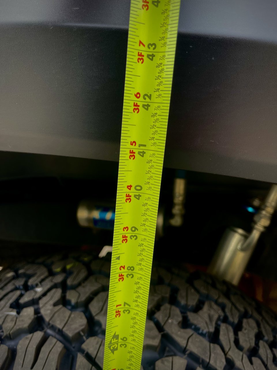

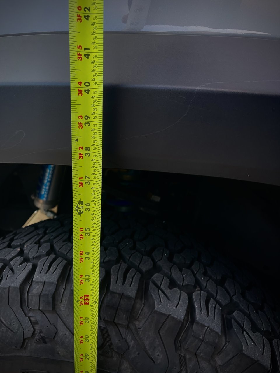

    Gonna have to push up the front Kings another inch and realign the front end but they fit pretty good except for the minor rubbing at the bottom back of front fenders.

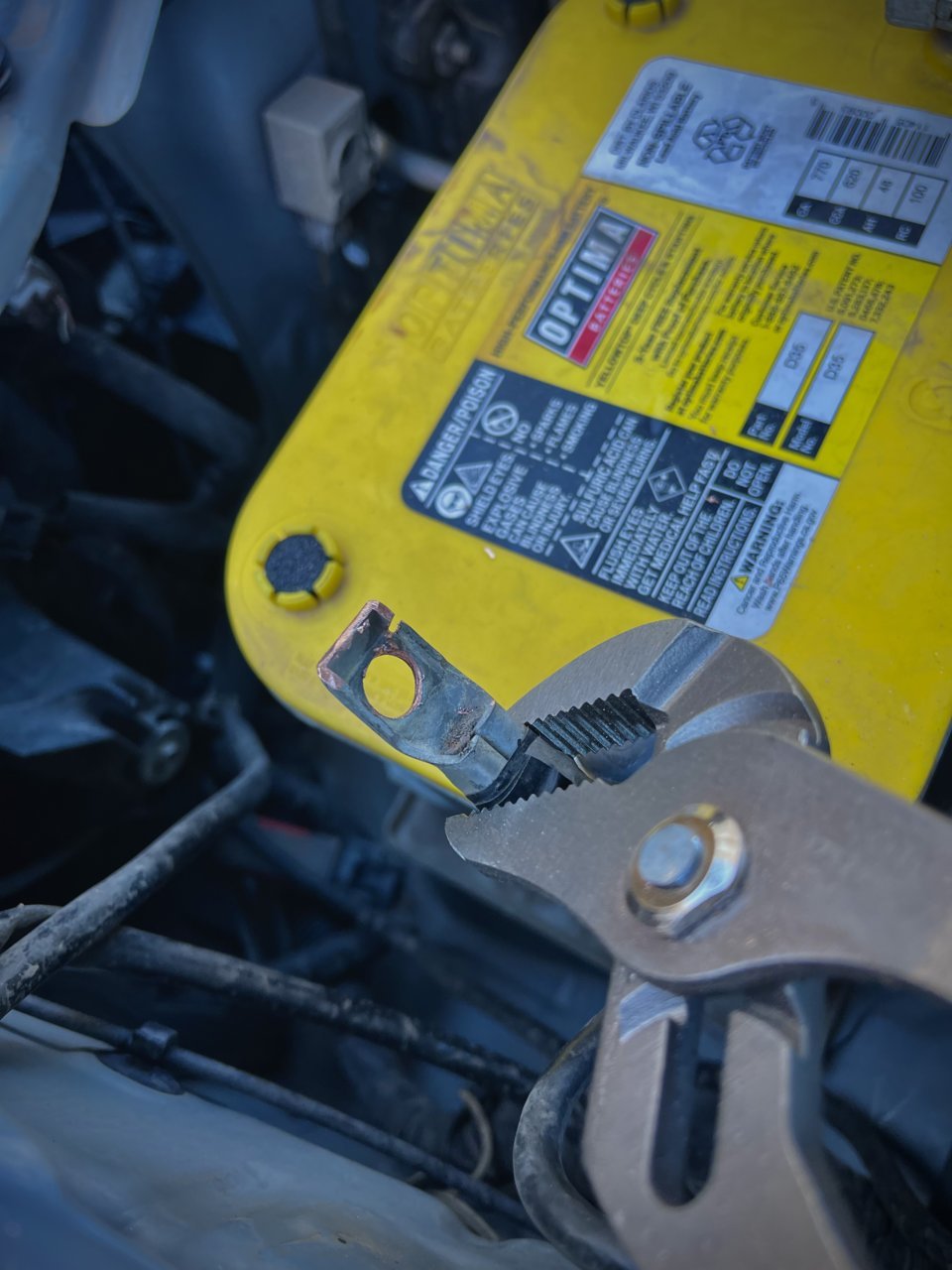

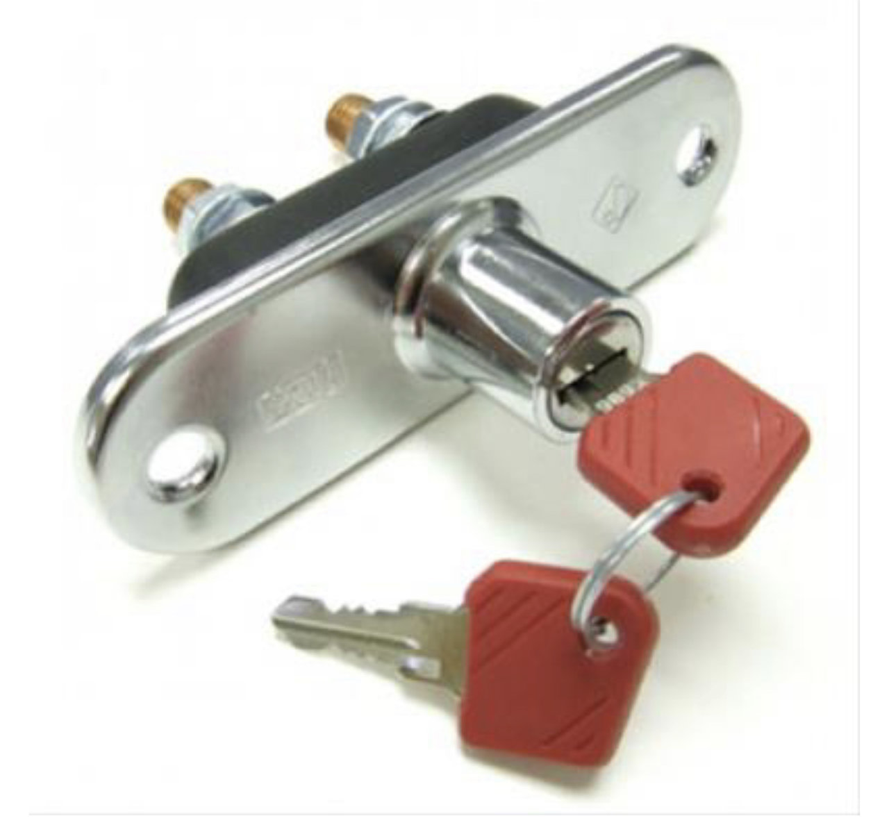

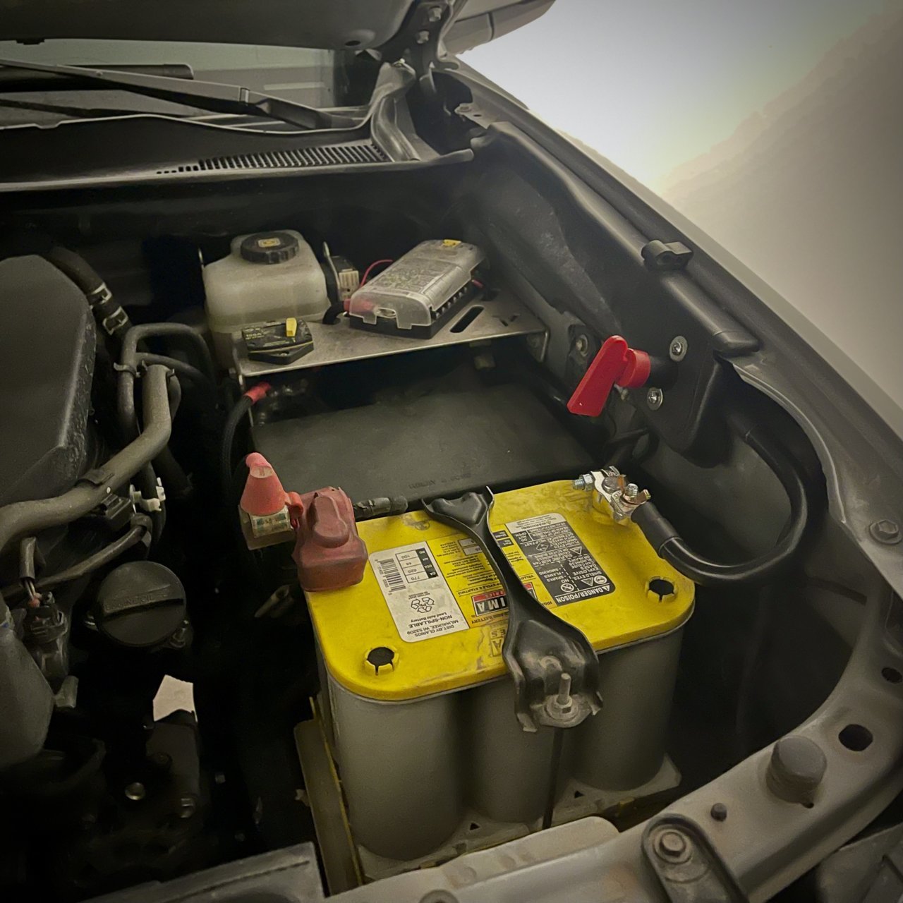

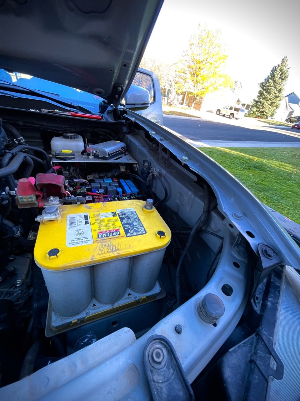

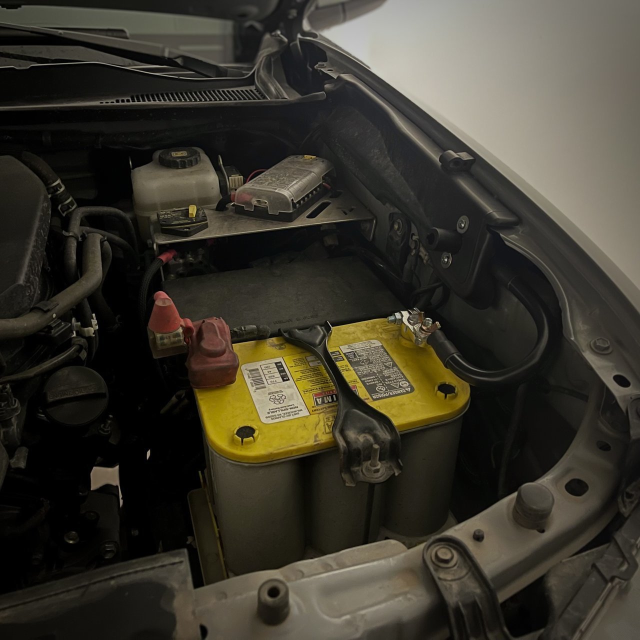

    My buddy and I worked in a little side project to help keel thrives from jacking my truck and put in another safety for an upcoming solar power install.
    We installed a master battery power kill switch. The switch was installed in line between the battery and the truck. A removable master key is required for vehicle to use the battery for start up. Basically: remove key and the truck has no way of starting up (aka thieves can’t drive it away).
    Here’s what we did:
    1. Mod/fab the current negative battery terminal post connector and relocate to one side of switch
    2. A 12” 2AWG cable was used with a new battery post connector to run from switch back to battery
    3. The switch was mounted to plastic inner fender cover
    This is just the first round fab. I plan to get a better battery, terminal connector. I think I can also make a better mount or bracket for the switch. :burp:

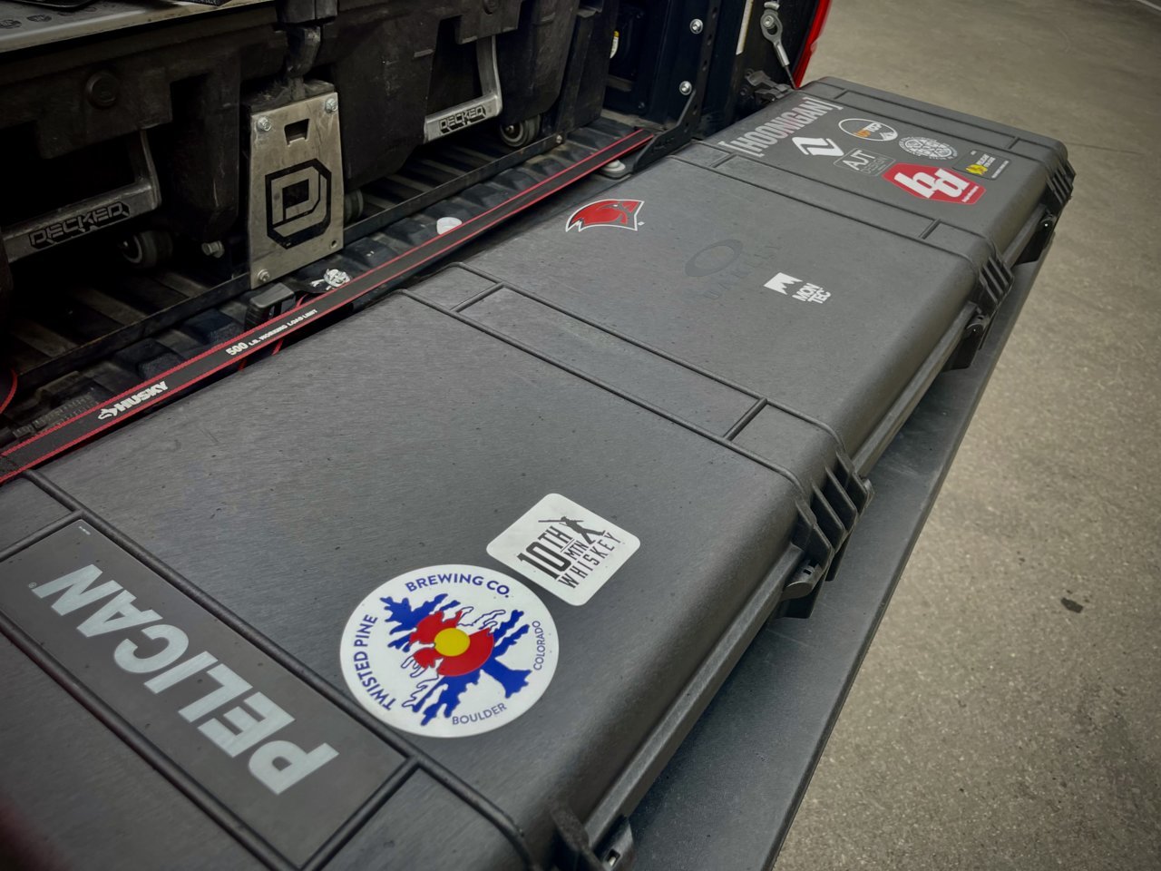

    Added a second pelican case…
