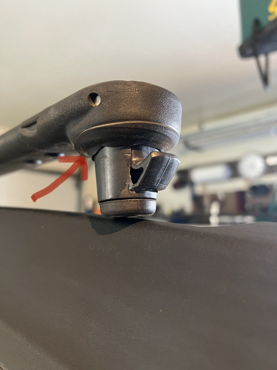

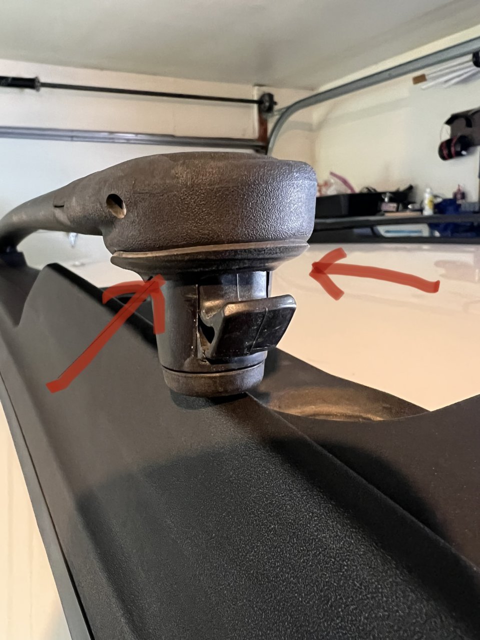

    I watched some videos of the oem rack install, and boy do the crossbeams look identical to them ones on the outback. Same latch at the free end of the crossbars. The Subaru ones are aluminum under the black coating, mine are all scratched up by gunwales. Based on my experience with the Subaru ones, they’d be perfectly fine for light and medium loads. For folks commenting that their crossbars rattle, it’s a common complaint on the subbie ones, you can tighten up the catch mechanism by fabricating a thin rubber washer to slip over the catch. It’s cut out of bicycle tube rubber.
