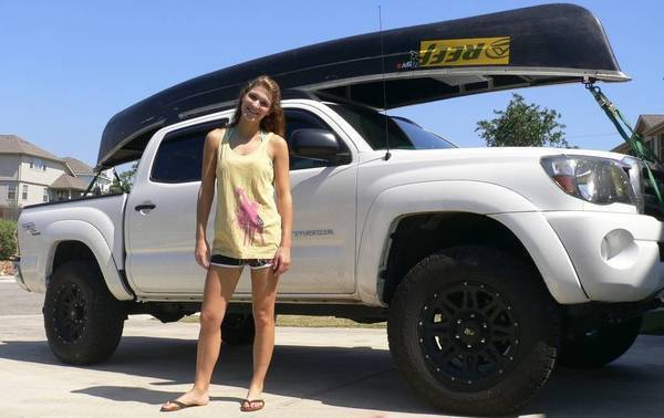

    Dude the OEM rack is actually not bad - cheap, easy install, looks a bit more natural on the truck, and has no problem hauling around my 12' canoe

    I am thinking about OEM for a 14' conoe, I currently haul the canoe on OEM racks on an 06 4Runner so I think I should be fine on my 2012 Taco with OEM as well. Question, I am thinking I will be strapping down as you have done in the pic, do you notice any flexing problems on the cab since the bed will flex differently than the cab, ie adding stress to the roof, dents, etc...?
