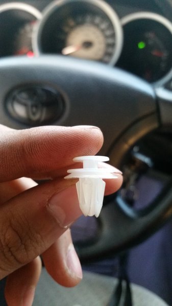

    is this the right clip I see everyone else with the yellow clip. I can't get mine to sit flush with the hood with the white clip it won't even clip on to it1463961391489-2024985634.jpg 1463961554302-469442275.jpg

    No, that white clip will not work. You must obtain the yellow clip. Theres no other way to make it work correctly.

    Do you know where I can get the yellow clip

    You have to bend the metal bracket down so that the roof rack sits flush with the roof.

    Dude, read post #14. You know, the post right before your first reply. It's all explained there. I know it's not the answer you are looking for, but thats the only known answer.
