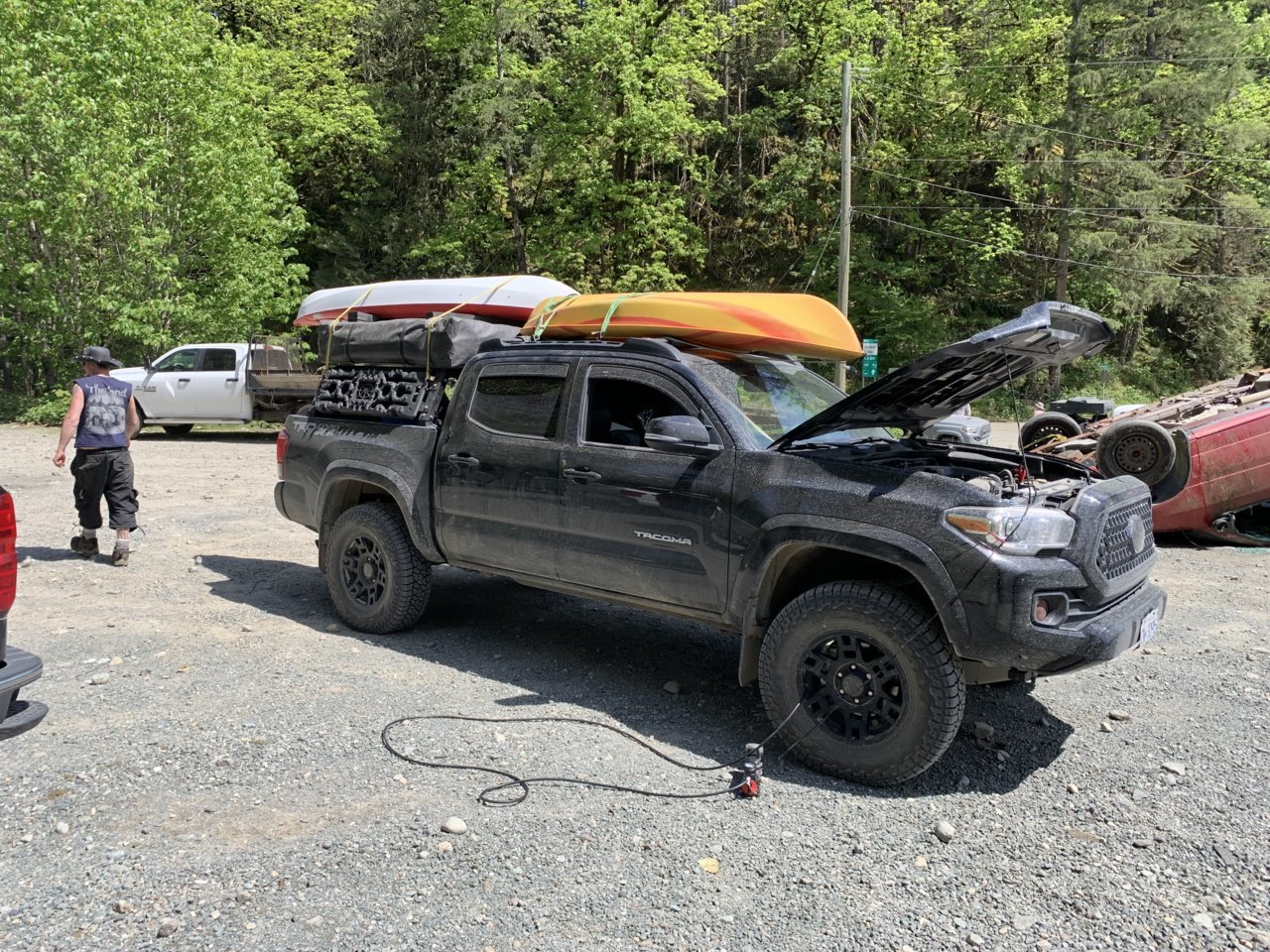

    8FC66B71-7E0D-4D98-9A24-A54A8B38B4A3.jpg I really wanted an OEM rack, but I bought my Taco (with its naked roof) off the lot. I installed an after-market Yakima, which I use for my bike and a 15.5’ kayak. It is rock-solid, roof-top cargo doesn’t budge, and I like that it comes off for ski season when skis will ride in the covered bed.
