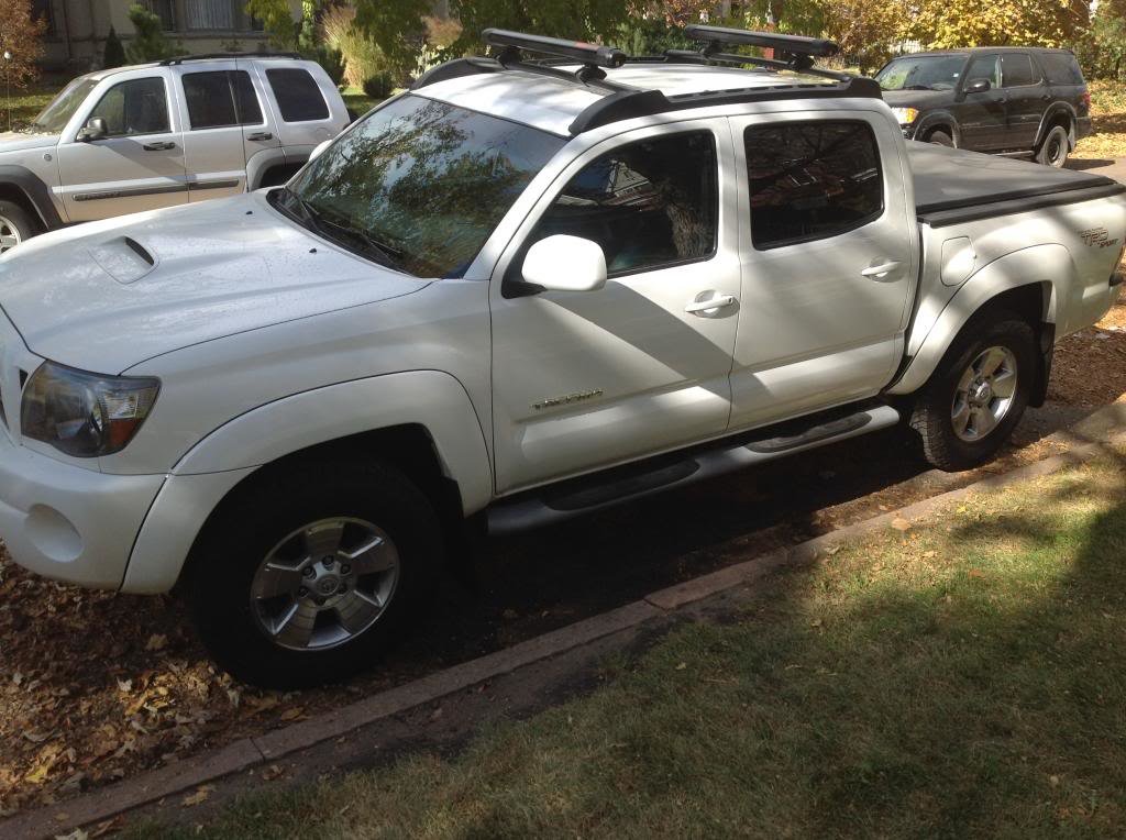

    Updating this thread for future reference, for anyone wondering the same thing. This is my truck with the factory roof rack and Yakima Fatcat 6 ski racks. A size 150 snowboard WILL fit on the rack securely. I don't have any pictures of of the snowboard and my skis on there, but if someone wants, I can do that at some later date.
    I would highly recommend the Fatcat 6. the skis and boards are held in really securely, and the double-hinge system allows things of different thickness to all be held tightly. The racks seem really high quality, and do have a lifetime warranty. I've noticed only a moderate amount of wind noise when they're on.
