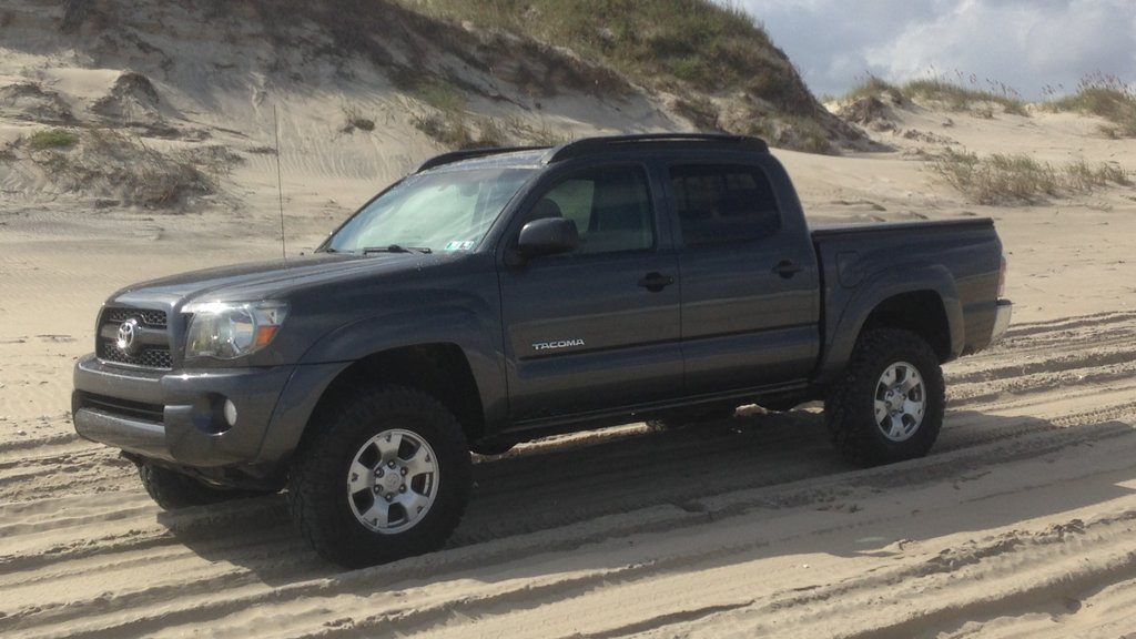

    I have 5100s all around with a Wheelers 1.5 progressive (multi-leaf) AAL. If you set your front 5100s to the third setting (1.75) and put the 1.5 progressive AAL in the rear, with the factory overload leaf, you'll have the same rake as stock.
    Not great, but this is the best pic I could find on my phone... 2" up front, 2" in rear. 265/75r16 Duratrac tires.
    D923BBBF-DB3F-422A-8052-C72181FD9C03_zps_6985b9f18b49feeb35414c44e5affbe5ae429cea.jpg
    I did not need a transfer case drop, carrier bearing drop, or extended brake lines. Like Crash said, 265/75r16 (load range C) and you'll see minimal loss of MPG and power.
