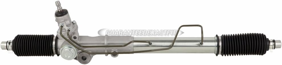

    As far as the first post goes for a lurker here, I've got a question that I haven't found a good answer to, and maybe someone here can help out.
    I'm in need of a new steering rack, and so I decided to go OEM and order from a dealer closish to me to get it here sooner. Listed on their parts.toyota.com site is a rack for $530 and I order it. I then get an email from them saying the rack I ordered is the remanufactured one, which is actually $510 with a core charge. Dude who emailed me says they've used these for 3 years and had no problems. I'm skeptical since I could buy any old reman one for half the price with a yearly exchange policy for when it starts leaking.
    So, does anyone happen to have experience with OEM reman racks? Could someone put my mind at ease?

    OEM reman should be fine. I would avoid anything non-OEM with the steering rack...the cheap aftermarket ones are notorious for blowing seals early. Even if the cheap ones come with lifetime warranty, replacing the steering rack isn't exactly a fun job

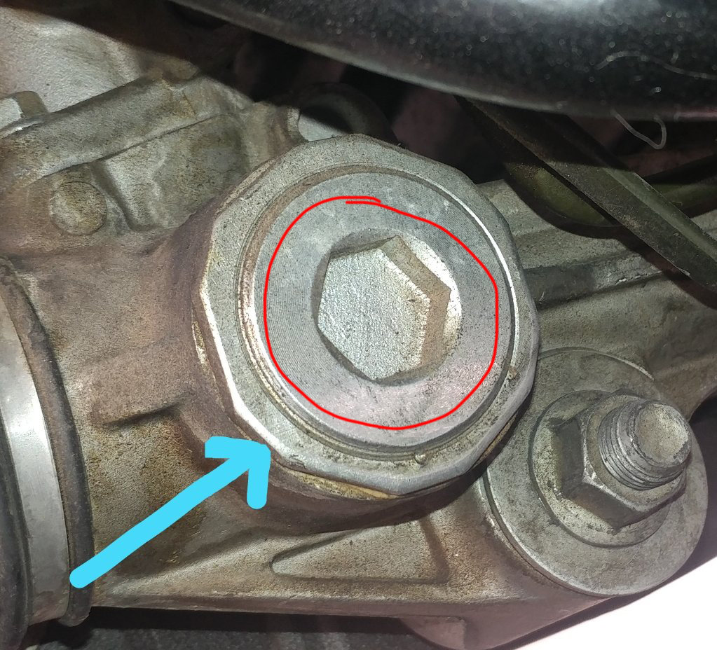

    Ironically it made adjustment impossible for me since nobody sells a wrench large enough to loosen the lock nut. I wanted to see if I could tighten up the wheel a bit.
  12. Jan 19, 2021 at 2:11 PM
    eon_blue
    Mar 4, 2016
    #180213
    69,736
    Azusa, CA
    The newer one takes a 22 or 24mm hex key, I had to order it on Amazon. Just stick it in a 24mm socket and you can adjust it that way.
    The torque spec on the rack guide is very low, like 18lbs or something like that. If it's over tightened even a tiny bit it will cause your steering to be really stiff and not let the wheel return to center. I learned this the hard way and nearly jumped a curb lol

    but there's an outer lock nut that's punched... you saying that'll move with the hex key?

    I don't know about any lock nut, you just stick the hex key in the circled part and tighten or loosen to adjust. Unless you mean taking that off and getting inside, I've never removed it just adjusted it's torque because it started weeping fluid.

    See how there's this collar nut here?
  19. Jan 19, 2021 at 2:43 PM

    Ah yeah I see, this part turns independently though. At least mine does, maybe it's not supposed to lol :notsure:

    Hmm guess I'm buying a hex bit soon :thumbsup:
