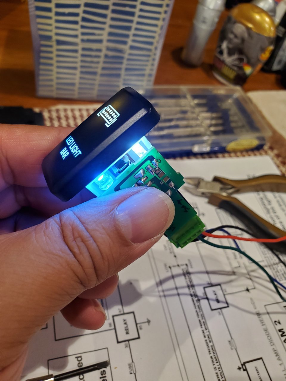

    What does the "green" switch look like? The OEM lighting for the heater is a bar of three orange LEDs.
    Maybe you could swap out the green LED for an ice blue one? It's not that hard, I did it for a dash switch.

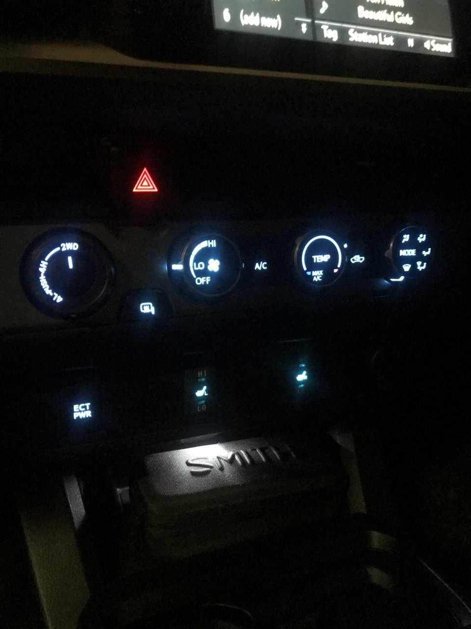

    I recently installed this kit in my 2017. The buttons are a knock off of the OEM 2014 Rav4 Buttons. They illuminate a blue that is close to the dash lights but brighter. The color matches much better in person than the picture makes it look. I may try and modify them to match the dash brightness better in the future but for now this works.

    https://www.amazon.com/dp/B07YKL2HBK/ref=cm_sw_r_cp_apa_fabc_fX86FbE3NGTMK?_encoding=UTF8&psc=1
    Right here - Treedix LED assortment for 8 bucks. "Ice Blue" is a hard to find color! The Treedix is a 5mm assortment, I had to go to Ali Express for the 3mm ones. Took 3 months, but luckily the 5mm fit so by the time they showed the went in to my LED drawer. :)

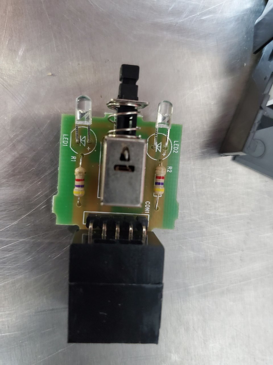

    For the ice blue you might want to go with 10k ohm, that will reduce the brightness down to a more "OEM" level. The ones you see in the pic are too low and the LED too bright. I don't mind bright for the ON indicator but the ambient lighting needs to be toned down.
    Just my $0.02!

    Are you saying to replace those 4.7k resistors with 10k? Or add the 10k in series? I'm a big fan of OEM look. I don't like how most aftermarket buttons don't have an OEM color option.

    NVM? If the backlight to the graphic is blue and the settings are orange which is fine. Assume it's some sort of bar graph. Maybe you could take a picture and tell me where you got it from.

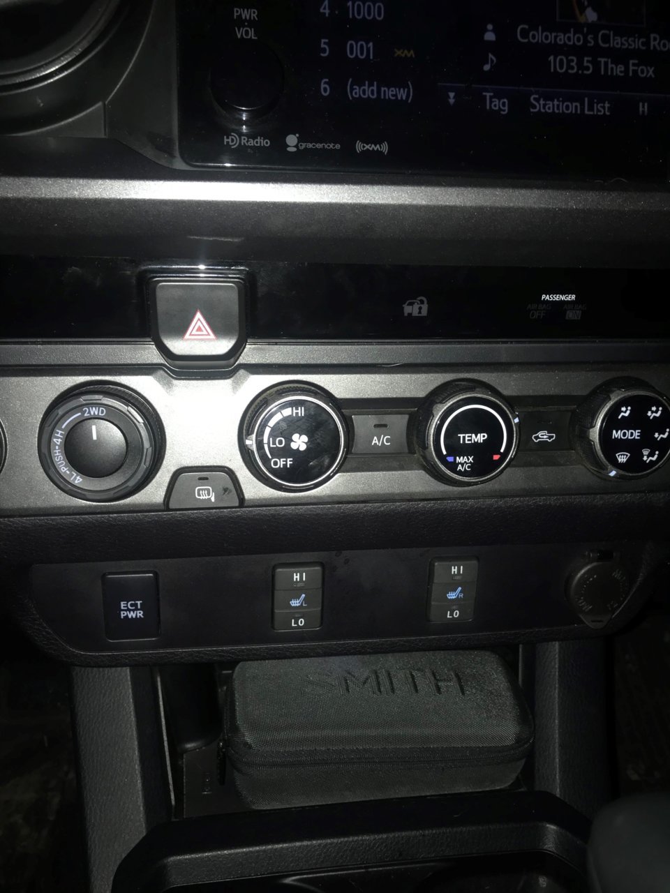

    I could be wrong but I believe all the packages that included the heated seats also included the dual zone climate control. At least that is how I remember it when I purchased my 17'. Which makes since because the dual zone display is integrated with the heated seat setting.
    Here is what the 3rd gen Tacoma factory switches look like.
