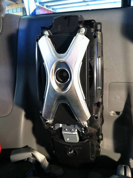

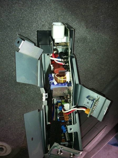

    The Crossover box on the Flux Capacitor

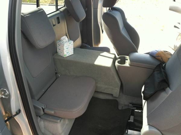

    The Subthump.com 2010 Access Cab subwoofer box. 8 or 10 inch subwoofers supported.
    Flux Capacitor with the cover off.

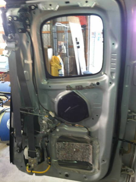

    Passenger access door with plastic cover over unused speaker mount.

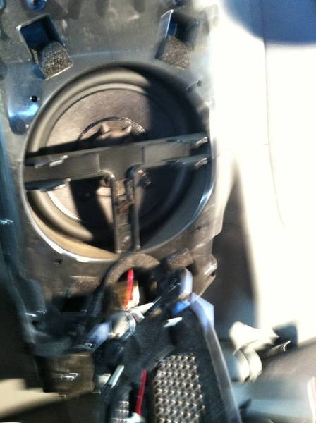

    5 and a 1/2 inch subwoofer from the Flux Capacitor.
