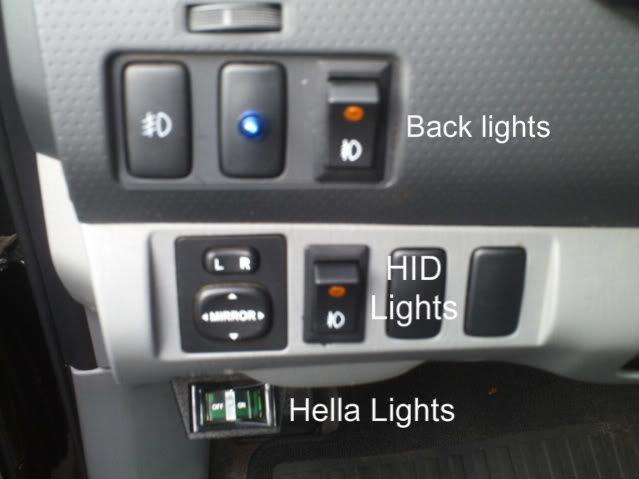

    These are my switches the ones with the amber light went to the dealer and ordered them there $18 a switch part# 00550-35976 there was trimming and the switches you posted will have minor trimming as well.

    Here is my set up,
    Left is lights behind grill
    Middle is free
    Right is for bed light

    How bright are those LED's on the switch. I have had some that will light up the whole cabin. Are those pretty dull?

    Mine are not that bad, if you turn both of them on you have a little glow, but nothing to bother you while driving.
    You can also turn them the other way, have done both but I like this set up for day time driving.

    Longbow you and another member is why i chose that switch looks good.

    Don't know about that one, but the one's I installed had some minor fitting.
    First one was the hardest, just figuring out how much to trim, other than that a breeze to do......

    longbow did you have to do any modding to fit those switches in the blank slots? or did they just pop right in?

    I know i had to trim a little^^^

    Well not knowing the first one I installed I trimmed more, (heavy toothed file) the others was very minor. Took about 10 minutes on the first, the the last about a minute or two.
    The pull down pocket on the left will fill with filings, so make sure to remove and clean out when done. I found out the hard way, all my gate
