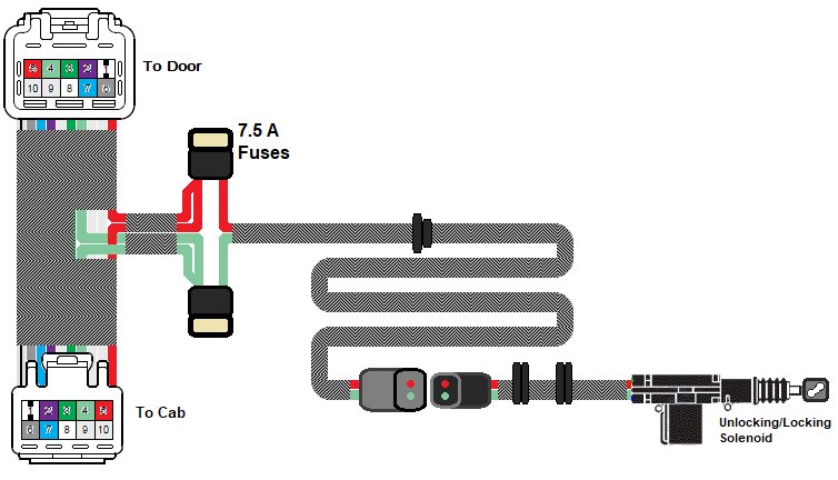

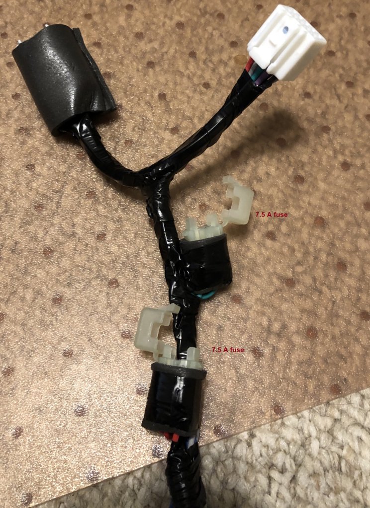

    caribe makaira
    caribe makaira Well-Known Member
    Feb 13, 2011
    #51121
    11,811
    Caribbean, Puerto Rico
    05 PreRunner TRD Offroad AutoTrans
    Hood Struts, My version Fogs always ON, Map & Overhead Light Mod,
    2 fuses OEM
    MrMustacho likes this.
  2. Dec 4, 2024 at 4:51 AM
    #22
    MrMustacho
    MrMustacho Well-Known Member
    Sep 28, 2021
    #378276
    161
    This is perfect, thank you!
