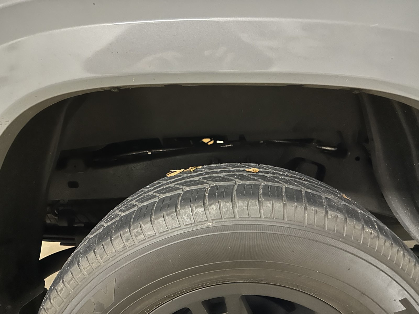

    Installed the OEM tailgate lock using YouTube instructions since it doesn’t come with any in the kit. I noticed that the wiring gets paired and zip tied with the wire loom running along the top of the frame down the passenger side which makes the new wiring (specifically the heat wrap part) very visible from the back wheel well.
    Did I run it incorrectly? Did anyone else notice this after install?
    thanks!

    here’s a pic of what I mean.

    There's a pdf of the official install instructions around TW somewhere. I followed them when I installed mine, and yes I can see the harness high up in the wheel well.

    I see mine too

    I installed mine, and it is slightly visible too.

    Thanks all! Sounds pretty normal and I didn’t mess up the easiest install ever. Phew! Gonna hit it with some fluid film black in those few spots you can see it.
    Interesting thought about cutting this harness for unwanted unlocking… hmmm

    I can see mine too....I was going to move it because it bugged me at first, but then life happened and I really don't pay any attention anymore.

    mine was visible I adjusted it

    Once it gets coated in dust from driving, it won’t be shiny enough to stand out anymore.

    I noticed mine after the install. If I was doing it again, I would have rattle canned it before install. Now I just don't care enough to do it.

    Same - when I first installed it bothered me how you could see the silver foil stand out so much. One of these days I plan to hit it with some rustoleum spray to make it less visible but honestly, I stopped noticing it haha.
