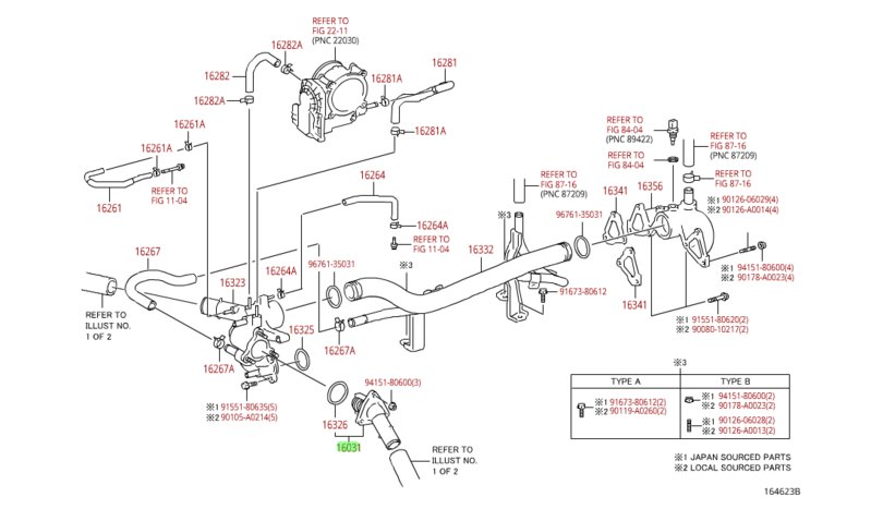

    Toyota sells the thermostat for the 4.0 Tacos with the inlet. # 16031 at the bottom of the page.

    Yes, it's an integrated assembly--you cannot buy "just" the thermostat...

    Yea I learned theres a housing with it and whatnot, thanks for confirming that though.
