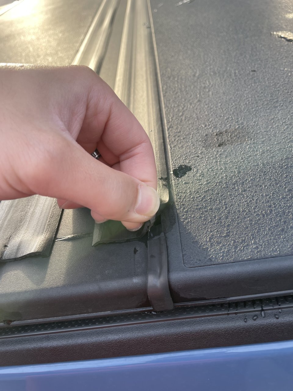

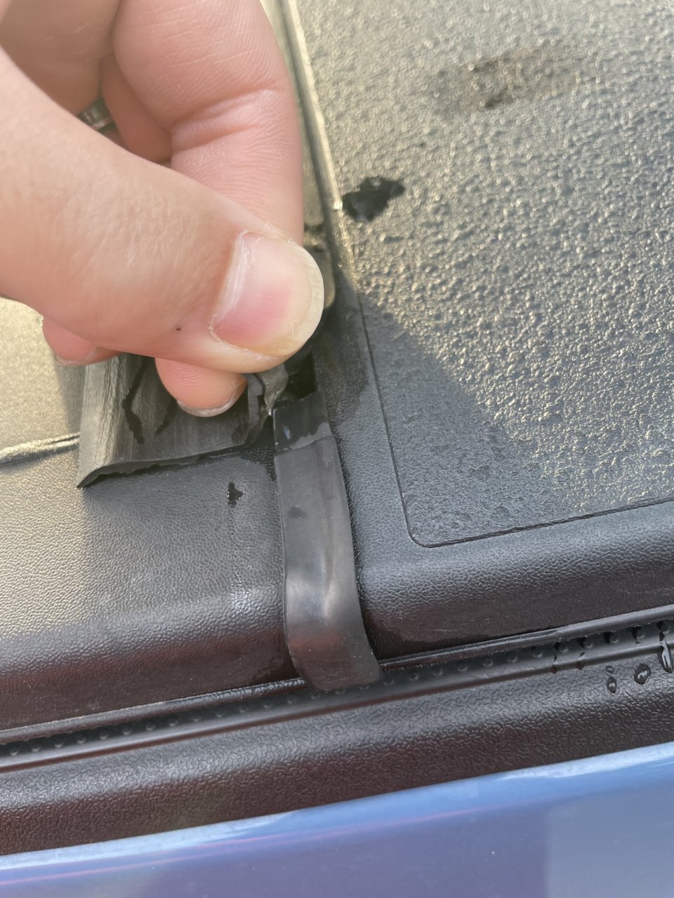

    I got a leak from my oem tonneau bed cover. The pictures show where the leak is coming from. There is a small hole underneath where I have lifted the "gasket". What would be the best way and product to use to seal this up?

    Maybe try some black rtv sealant? or a rubberized glue. They have flex seal for just about everything else, but never had any luck using it myself.

    I was thinking about black rtv sealant but I wanted members opinion on this to see if truly black rtv sealant is the best way to go about this.

    Yeah, I was under the same impression. There was heavy rain last night in Houston, TX. I came out this morning and open up the tonneau cover and my bed had a lot of water in it. I look for where the water possible could have came from and I discover the “gasket” area was where the water was seeping in through.

    Maybe plug up that hole with some butyl tape?

    Butyl tape works well. Shapes to how you want it, stays elastic and can easily be removed.

    I might do that then. Thanks

    I got some off Amazon for like 6-8 bucks and it’ll be more than you’ll need in a life time.
