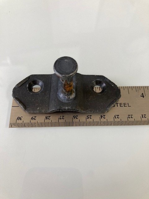

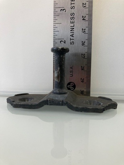

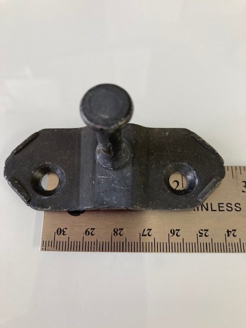

    I also have all the necessary hardware minus the two rubber gap fillers at the top front of the box. I'll sell you all of it if you are interested. See my previous post with photos above.
    3-1/4" long overall mounting base
    2" center-center on the mounting holes
    13/16" from the edge to the center of the mounting holes
    1-1/4" wide overall mounting base
    1-11/16 overall pin projection from mounting
    5/16 diameter mounting pin

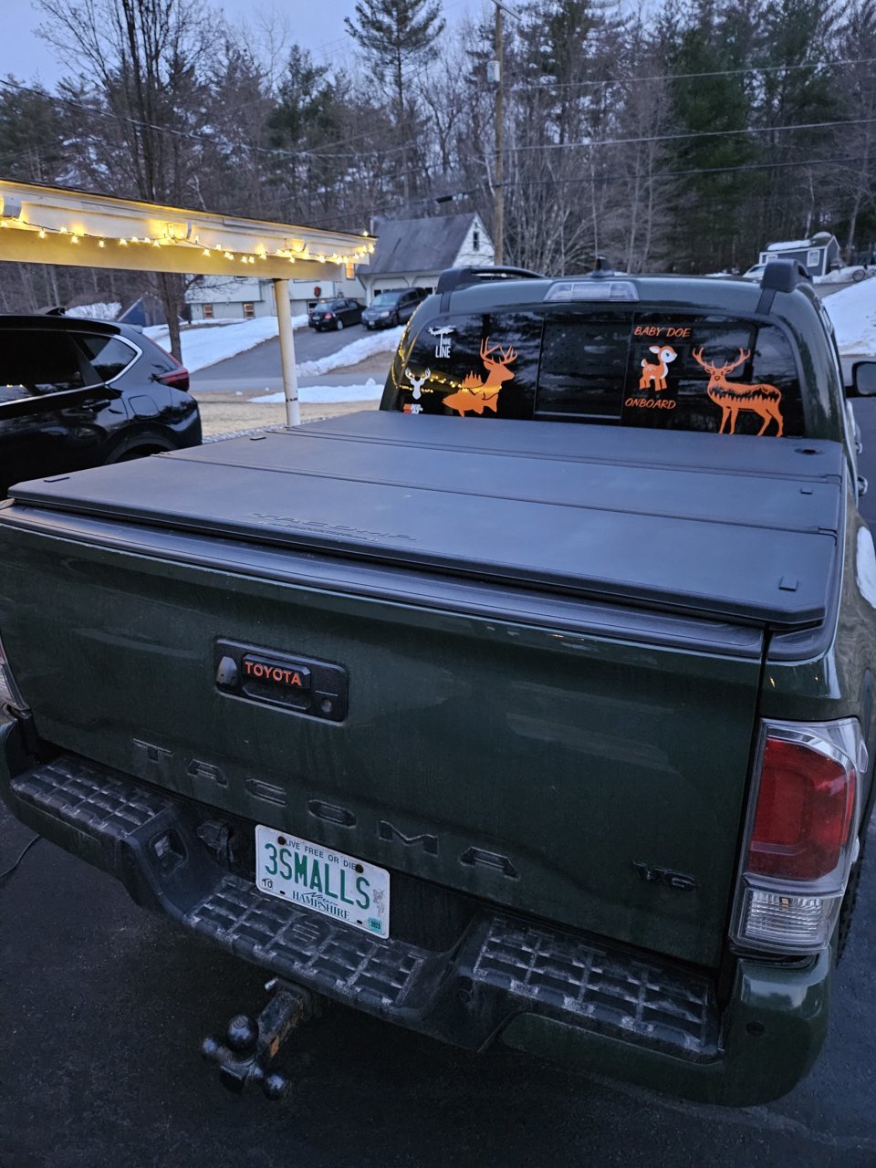

  19. Mar 22, 2023 at 5:26 PM
    #219
    TSmalls89
    TSmalls89 Technologically Advanced Redneck
    Mar 27, 2013
    #100700
    1,031
    Tyler
    Merrimack NH
    2022 Tacoma TRD Offroad
