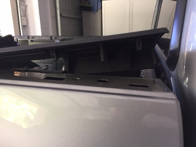

    To remove plastic bed rail to access Threaded mount holes. Bed rails pull off, I started on rail closest to cab and pull straight up and work your way down to tailgate.

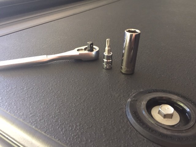

    Tools needed Torq bit T-27 and 12mm socket for the bolt.

    I was able to get all the mounting HW with the cover. I was unable to trade plastic bed rails because seller had put on a bed shell. Cutting plastic rail was easy, just make sure not to over cut and make opening to large.

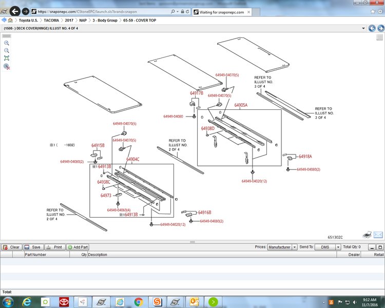

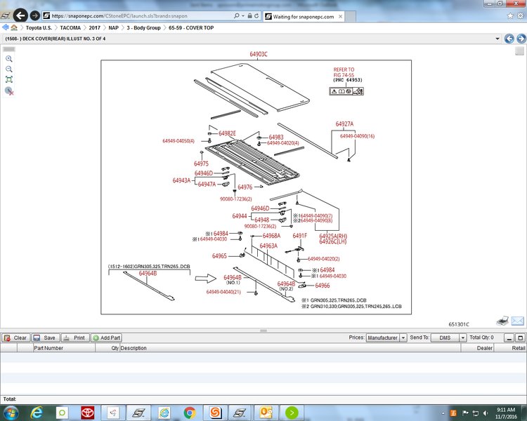

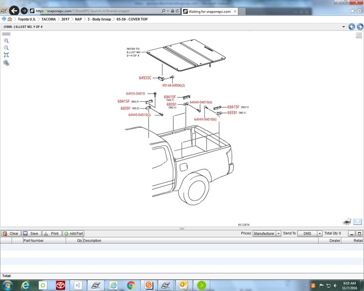

  12. Nov 7, 2016 at 10:00 AM
    #32
    Spare Parts
    Spare Parts Well-Known Member
    Sep 9, 2016
    #196811
    13,807
    Southern Maine
    2022 Off Road Premium 4Runner Lunar Rock
    I spoke with a few parts departments at some localish dealerships. The mounting hardware is about 350, rails run 150 each, so about 350 to 700 if I want to install. It is a 650 dollar option from the factory, not worth it in my book. One guy said he priced out everything needed once, it was about 2500 bucks he said. I am going to give back the cover to the guy who gave it to me, I don't feel right selling it, but if some one is interested I will pass on info to him.
    here are some parts diagrams

    Don't make the cut two large. There is a black plastic piece/cover that covers mounting hardware. The bed rail sits over plastic cover holding it in place. I'm referring to pic #3 on first post.
