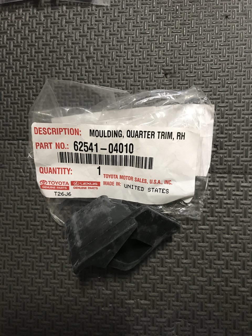

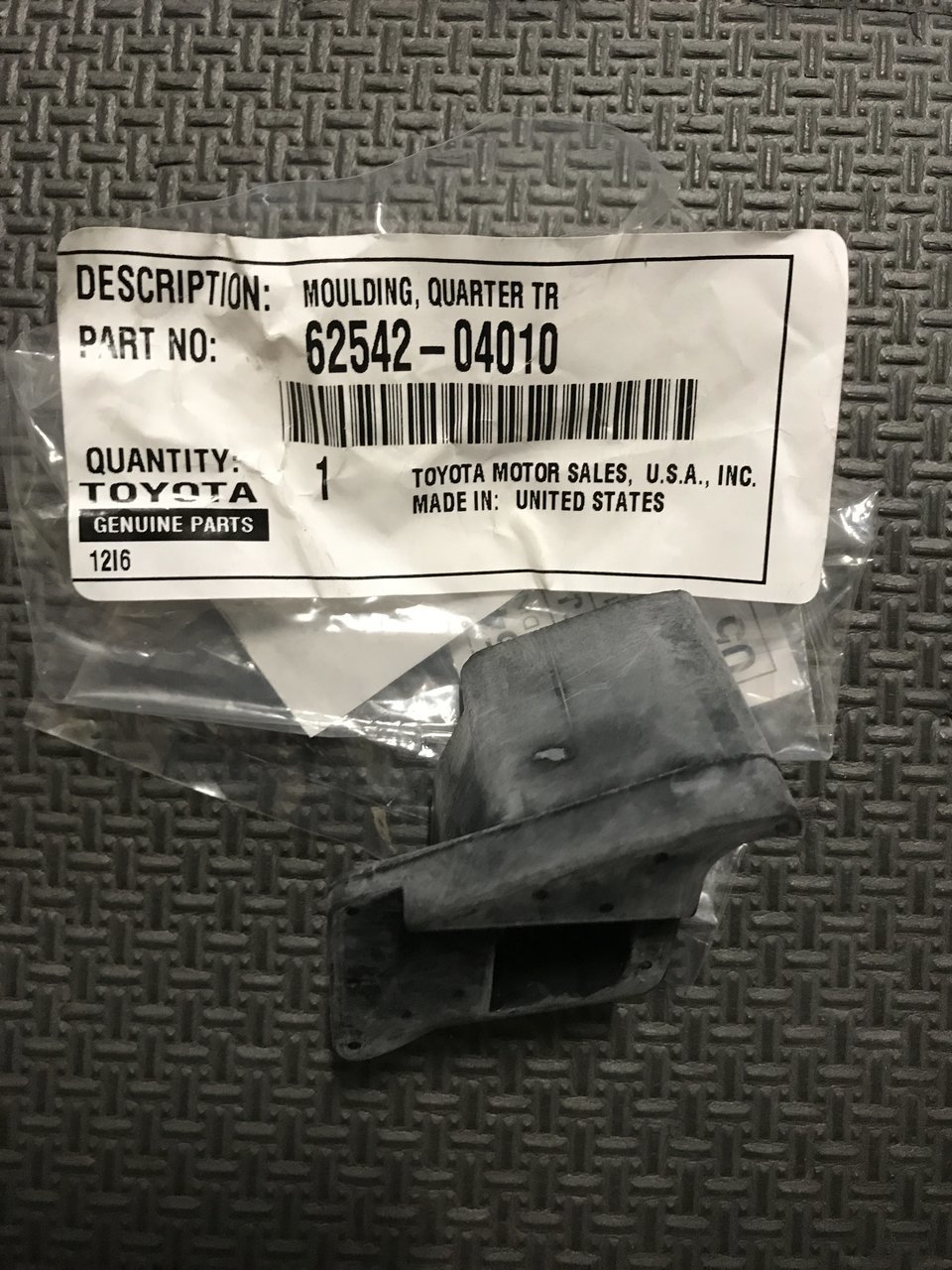

    I think I have the part number for the passenger side. The rubber seal will be backwards if you order 2 of them. The seals are removable with a torx bit if you peel back the rubber.

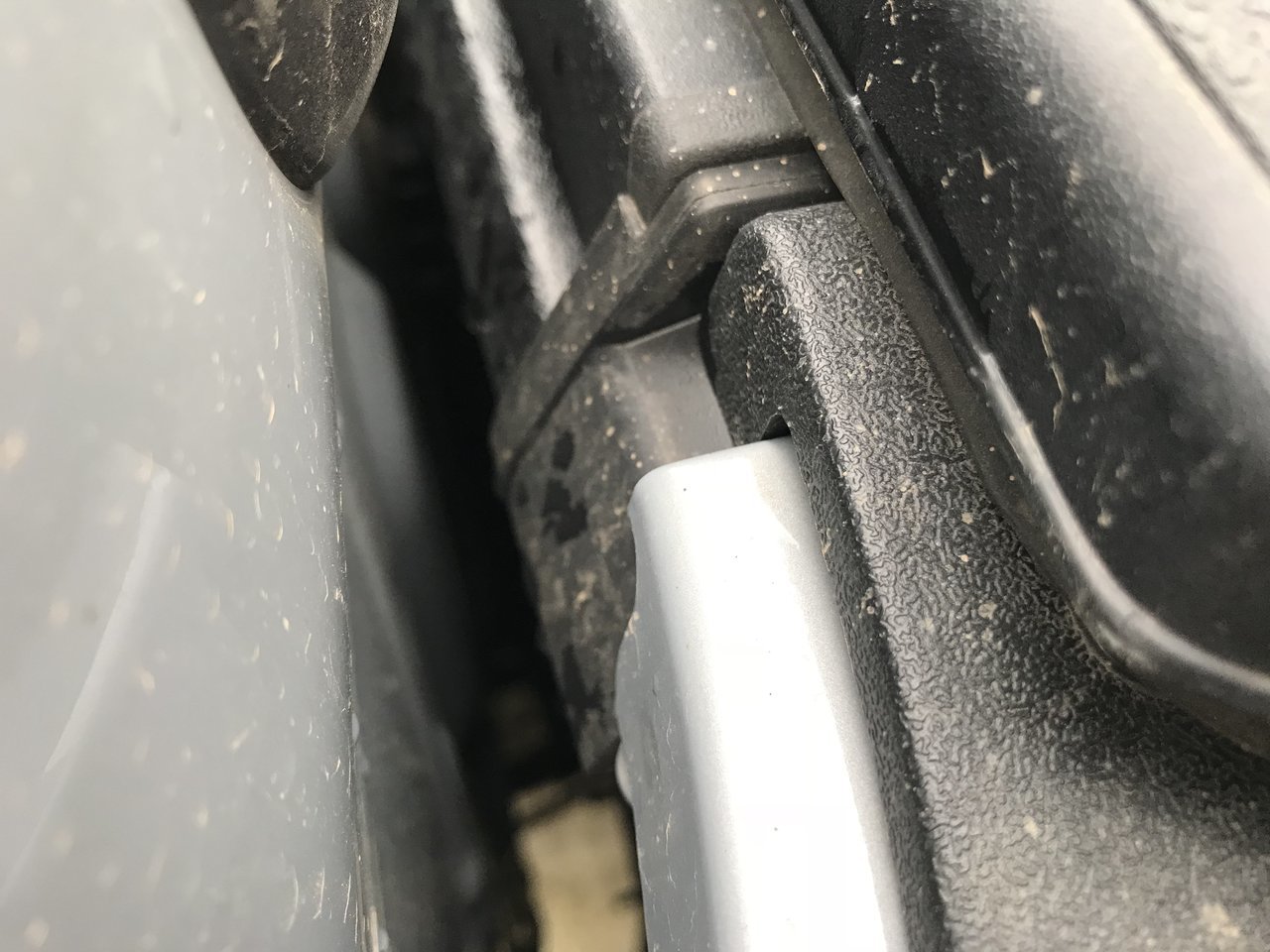

    Could someone please post a pic of how the rubber plugs are installed at the cab? I can't figure it out
  9. Dec 16, 2017 at 11:33 AM
    #69
    cemented
    cemented Well-Known Member
    Jan 11, 2017
    #207255
    1,901
    Cole
    Portland, OR
    2017 TRD PRO Cement AT Maggy 84mm OTT
    I don't have any pictures of them installed at the moment, but they do fit. The part that slopes faces forward towards the cab and the small lip at the bottom of the slope hangs over that front edge. You have to trim the front of each rail underneath where the rail and rubber plug come together and touch. I know this is really hard to read, but I hope it makes sense.
    I will attach some pictures to let you know which one goes to which side:
    Foushee likes this.
