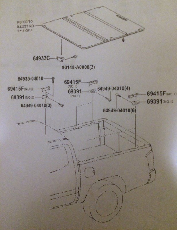

    So I am about to pick up an OEM bed cover for $80 with no hardware. I am just wondering if this list is correct and if I am reading it correctly. The number of how many you need is above the part number?
    Also I am guessing only 1 of the very first item on the list since it looks like it matches the other 5 in the second part? Whats the difference between the first and second part on the list?
    Lastly, the 3rd and 4th item says just one of each but aren't those the actual pegs the cover sits on and wouldn't you need 6 total? Along with that the 5th item looks like the part that goes in the middle of the back of the bed? wouldn't you only need the one?
    If this is the correct numbers obviously the second two questions are kind of moot but I was just trying to visualize the diagram of the parts in my head...

    Yes there are six mounts total secured with twelve bolts, but the front passenger side mount is different than the other five. That's why you have the 5 and 1 quantities for parts. That list is about everything you need. The last part on that list is the bolts for the front of the header rail to secure the centering pin, you need 2 of those. The only other part missing is the bolt that goes into that front passenger mount, which IIRC was like $80 from toyota.

    I'm going off this diagram to look up the parts needed, I see the front passenger side is different than the other 5. But what bolt are you talking about? Is it the (64935-04010) part number?

    The list I came up with based off that Diagram was:
    69442-04010 (x5)
    69442-04030 (x1)
    69415-04020 (x5)
    69415-04040 (x1)
    64933-04010 (x1)
    64949-04010 (x12)
    90148-A0006 (x2)
    64935-04010 (x1)
    sivill likes this.

  15. Sep 12, 2018 at 11:23 AM
    #95
    Kirbstomp1287
    Kirbstomp1287 @MilSpecTaco
    Jan 23, 2018
    #242213
    278
    17’ Inferno SR5 V6 DCSB XP
    Sweet, that helps a bunch! Thanks!

    Yes
    That seems about right, only other thing would be the front seals for the header rail, but they aren't necessary. They help keep a little bit more moisture out, but still not 100% watertight.
