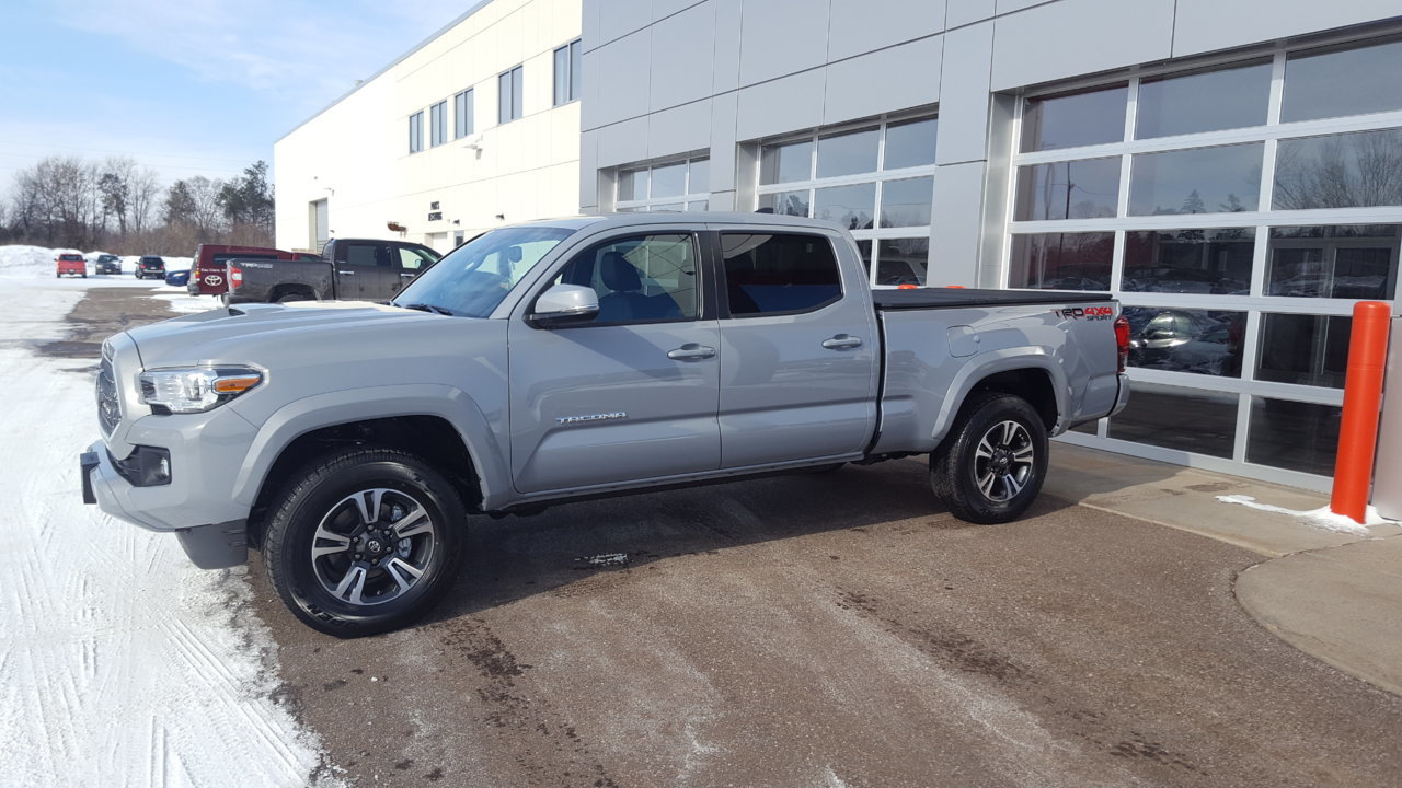

    I saw the earlier post about the precut bed rails 66248-04070 and 66249-04070. From looking around, it looks like these are for the short bed? Does anyone have the part numbers for the long bed versions? Thanks!

    There is no OEM cover for the long bed, so there won’t be any pre cut rails for it.

    na8rboy 18 DCLB Sport Cement
    Jun 3, 2012
    #80024
    3,675
    WI
    18 DCLB SPORT CEMENT
    What? Here is a long bed with OEM cover.

    cemented
    cemented Well-Known Member
    Jan 11, 2017
    #207255
    1,901
    Cole
    Portland, OR
    2017 TRD PRO Cement AT Maggy 84mm OTT
    Uhhh what??

    It was discontinued, it no longer is available, and I’m pretty sure they never made the bed rails for it, just cut them.
