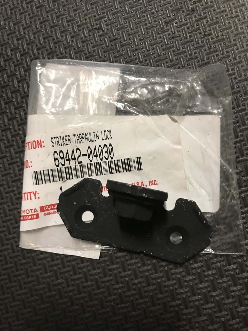

    Does anyone have the part number for the bolt on the passenger front side? The “safety bolt” per say. I ordered part number 64935-04010, but it looks nothing like the bolt I’ve been seeing people have.
    Thanks,
    Max

    #131
    cemented
    cemented Well-Known Member
    Jan 11, 2017
    #207255
    1,901
    Cole
    Portland, OR
    2017 TRD PRO Cement AT Maggy 84mm OTT
    The bolt is like $80 from the factory or something stupid like that. Other people have purchased the same size bolt, but I forget the size off hand.

    What is the part number for the right front passenger bracket? On the Toyotapartsdeal.com site when I type in
    69442-04030, it comes up with the “striker” that looks just like the others. But this is supposed to be the one that holds the safety bolt.
    Max

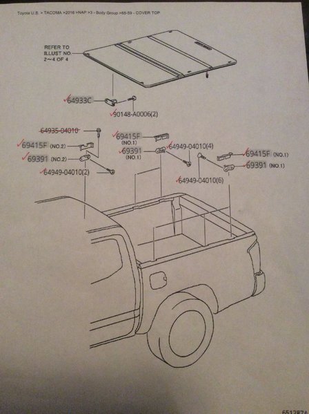

  13. May 12, 2019 at 1:56 PM
    #133
    cemented
    Jan 11, 2017
    #207255
    1,901
    Cole
    Portland, OR
    12D96EA1-2023-48DE-94D2-E73B422C8CCA.jpg 0B975740-2B07-4D3A-98D7-3CE8B9D96F04.jpg

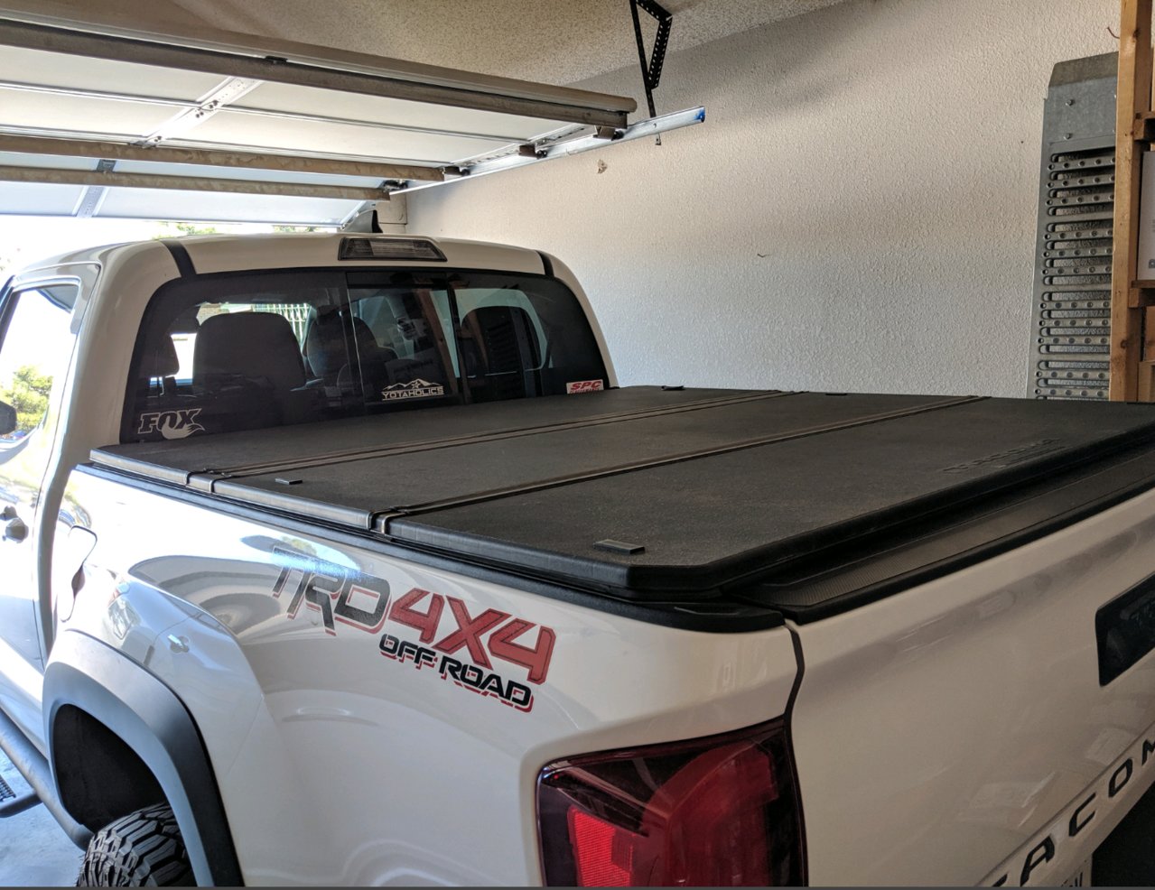

    Screenshot_20190725-132454_1.jpg @DVS1 Thank you for the write-up! Used it to install one today.
    :cheers:
