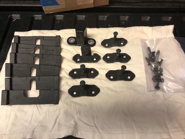

    Hardware should come with cover. Post #32 from @Spare Parts
    Mention price from dealer and part numbers on diagram.

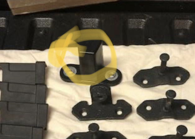

    What’s the part number for this piece? It seems different then the 94933C piece?

    devenob[QUOTED] likes this.

    If you are in Canada:
    PK3B1-35J5H
    If you are in the USA:
    64901-09010 - Panel, Tonneau Cover Front
    64902-09010 - Panel, Tonneau Cover Center
    64903-09010 - Panel, Tonneau Cover Rear
    64904-04010 - Hinge, Tonneau Cover Front
    64905-04010 - Hinge, Tonneau Cover Rear
    66248-04070 - Cover, Bed Side RH
    66249-04070 - Cover, Bed Side LH
    64949-04020 - Screw, Panel to Hinge (Qty: 24)
    64949-04070 - Screw, Panel to Hinge (Qty: 20)
    64915-04010 - Cap, Front Hinge RH
    64916-04010 - Cap, Front Hinge LH
    64917-04010 - Cap, Rear Hinge RH
    64918-04010 - Cap, Rear Hinge LH
    64949-04080 - Screw, Cap to Hinge (Qty: 8)
    64933-04010 - Pin, Tonneau Cover Front
    90148-A0006 - Screw, Front Pin (Qty: 2)
    69442-04010 - Striker, Tonneau Cover Side No.1 (Qty: 5)
    69442-04030 - Striker, Tonneau Cover Side No.2
    69415-04020 - Cover, Striker No.1 (Qty: 5)
    69415-04040 - Cover, Striker No.2
    64949-04010 - Screw, Striker (Qty: 12)
    64935-04010 - Bolt, Striker
    62541-04010 - Moulding, Trim RH
    62542-04010 - Moulding, Trim LH

    Does anyone know if you need the pre cut bed rails for aftermarket covers as well? Not sure if that’s a stupid question or not lol
  19. May 29, 2020 at 3:50 PM
    #159
    DamGuide
    DamGuide Well-Known Member
    Nov 29, 2019
    #312054
    674
    Nooga, TN
    2020 TRD Offroad
    I believe the OEM tonneau is the only one that uses this striker style, I don't think any aftermarkets use these. So no, you don't need to cut your covers. All the aftermarkets I have seen have their own hardware for installing the strikers without removing the bed caps.
