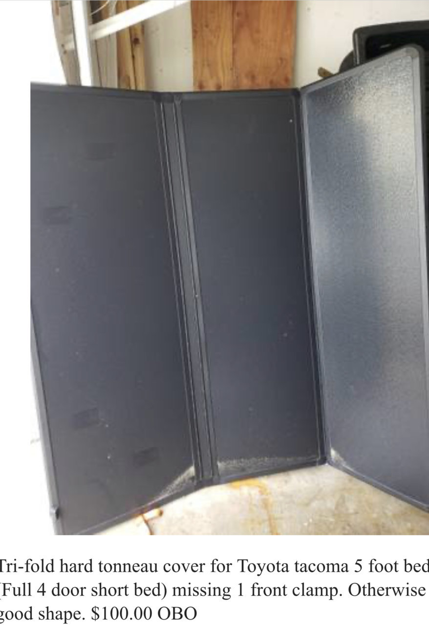

    377
    Anyone know the cost of the clip he mentions is missing? Curious to see if it’s worth getting
    Edit: sold after 20 minutes of being posted

    2020 TRD Offroad
    That’s not an OEM anyway

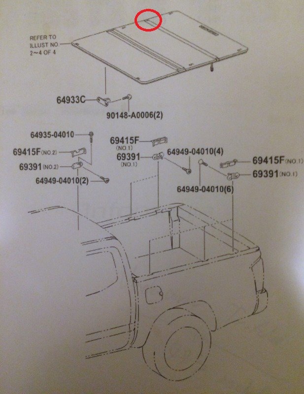

    2020 TRD Pro
    I'm in a similar situation, I found the plastic piece broke off, on the rear passenger side (the smaller hinge closest to tailgate). Is that the same one you took a picture of (64917-04010)? Crap, it looks like it's discontinued, at least on https://www.toyotapartsdeal.com/

    #168
    cemented
    cemented Well-Known Member
    Jan 11, 2017
    #207255
    1,901
    Cole
    Portland, OR
    2017 TRD PRO Cement AT Maggy 84mm OTT
    There is a different number for the passenger side. I can’t recall what it is at the moment.

  11. Feb 13, 2021 at 9:40 AM
    #171
    noleafclover1337
    noleafclover1337 New Member
    Feb 13, 2021
    #356000
    2
    Jeff
    Tacoma 2021
    [​IMG] Part No.: 69442-04030
    [​IMG] Part No.: 69442-04010
    What is the difference between these two parts? They look identical and I see no differences in the diagram.
  12. Feb 15, 2021 at 9:11 AM
    #172
    noleafclover1337
    Feb 13, 2021
    #356000
    2
    Jeff
    Tacoma 2021
    I don't think this parts list is correct. I ordered based off this and I had too many of these (example, this should be qty 1):
    5
    [​IMG] Part No.: 64933-04010
    Also didn't have enough side pins (ordered only 1 of those based on your list). Did this copy/ paste incorrectly?
