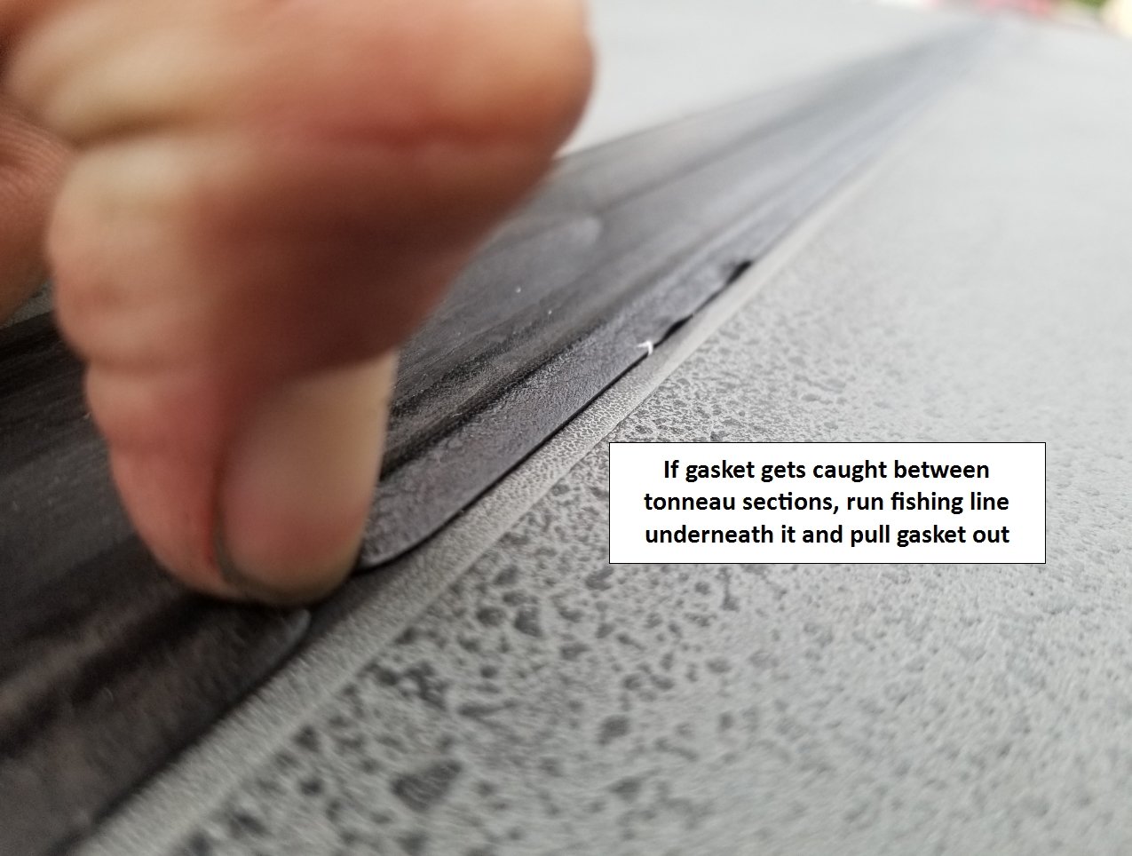

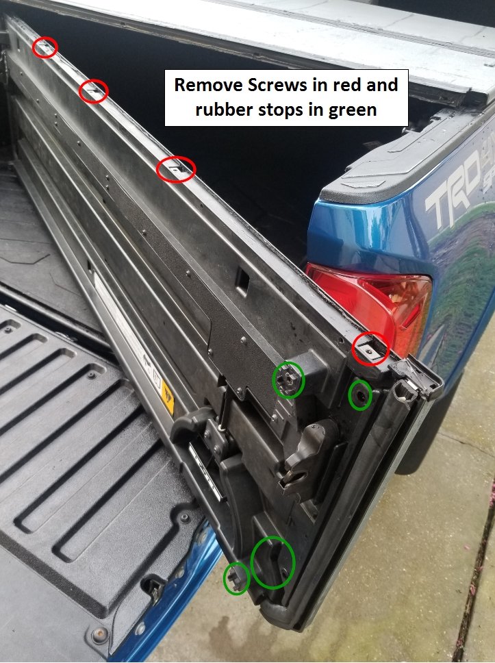

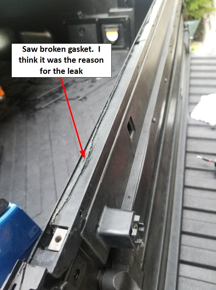

    I had the same issue and was able to drain the water. I had to removed the rear section of the tonneau as well as a few rubber bump stops. Water poured out when I leaned the 1.jpg 2.jpg 3.jpg section on its side. I replaced the tonneau then the bump stops and did not hear any water splashing. I’m don’t think it matters what order you do this in. I did come across an issue with the top rubber gasket when reinstalling the tonneau section. It kept getting caught between the two sections but I slid some fishing line under the gasket that was stuck, pulled it out and the gasket snapped back to position. Similar to how they install gaskets on windshields.
