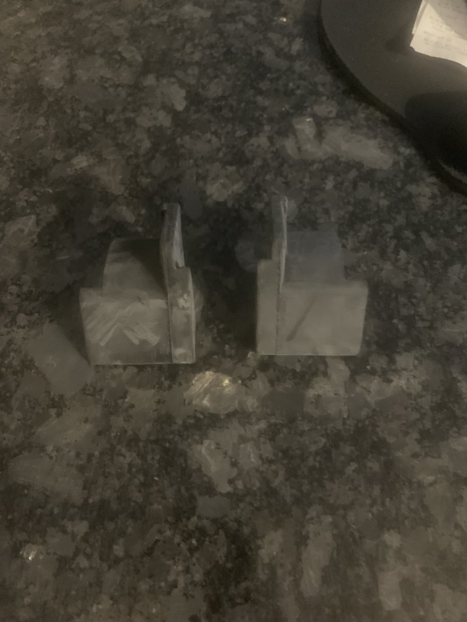

    Hi everybody, just put the Tacoma Tonneau cover on today all good expect 2 extra rubber bumpers or stoppers were included with the hardware not sure where or what they’re for? Any insights ?D21708B0-5EB3-4610-9866-7021C5F311C3.jpg

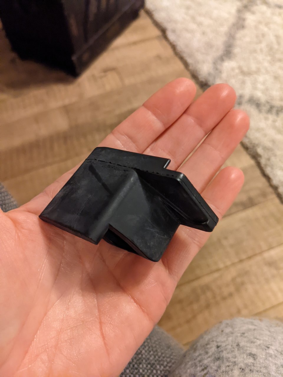

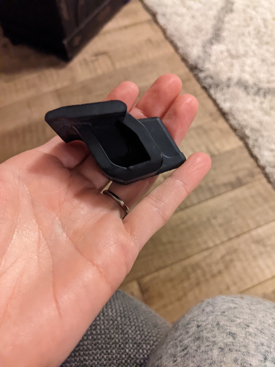

    B2AEEF08-1792-44BC-A5F2-827CAE717F3B.jpg CB67D93B-A2F2-41AB-8AF5-B552B0F7A17F.jpg
    My lovely other half figured it out. These must go on at the cab end of the bed at each corner or your cover will leak. If you’re putting a new cover on make sure these puppies are there..

    What he said, tho I've no idea how they fit. Bought mine used off a friend. My rubber pieces sat in cup holder till I removed the tonneau yesterday to put on my new bed rack. Lol

    They fill the gap between the header rail and bed rail covers.

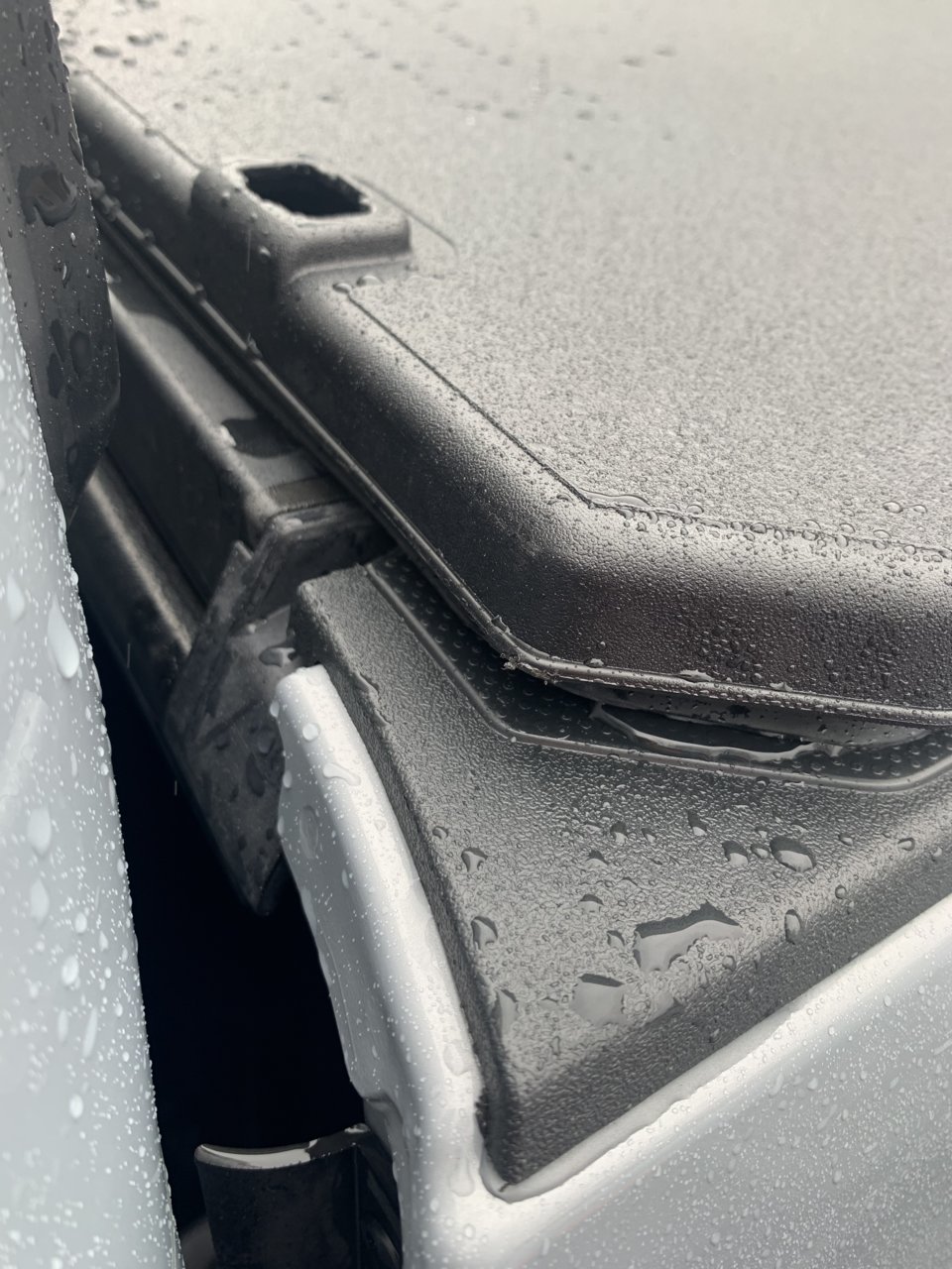

    Windy and rainy yesterday and today had water coming in from more than one spot you can see daylight from inside top left and right corners maybe OEM cover nah tha best??FB797BA6-1A5A-41F0-ADDA-FA6DF000DBC9.jpg4297A30C-615A-4063-ACE4-0CC7D690CB08.jpg
