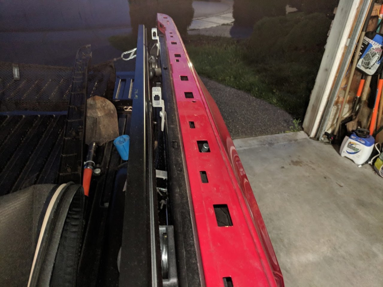

    The side rails snap tight. I had one off to do a difficult version of the rear diff breather mod:
    Adding foam might be too thick? What gets tossed around is to use metallic sealing tape to cover as many holes as possible and then use some silicone caulk as a seal. This is usually done to keep the rails from wearing on the painted surface when using a canopy and was more of a problem for the 2nd Gens.
    That said, I don't see much if any water getting in under the side rails.

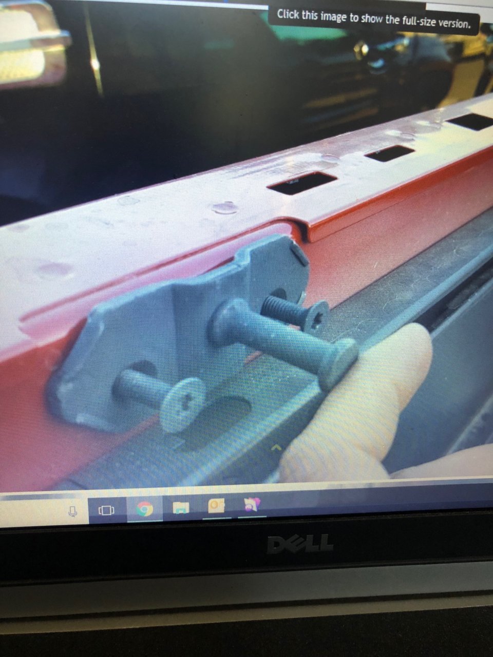

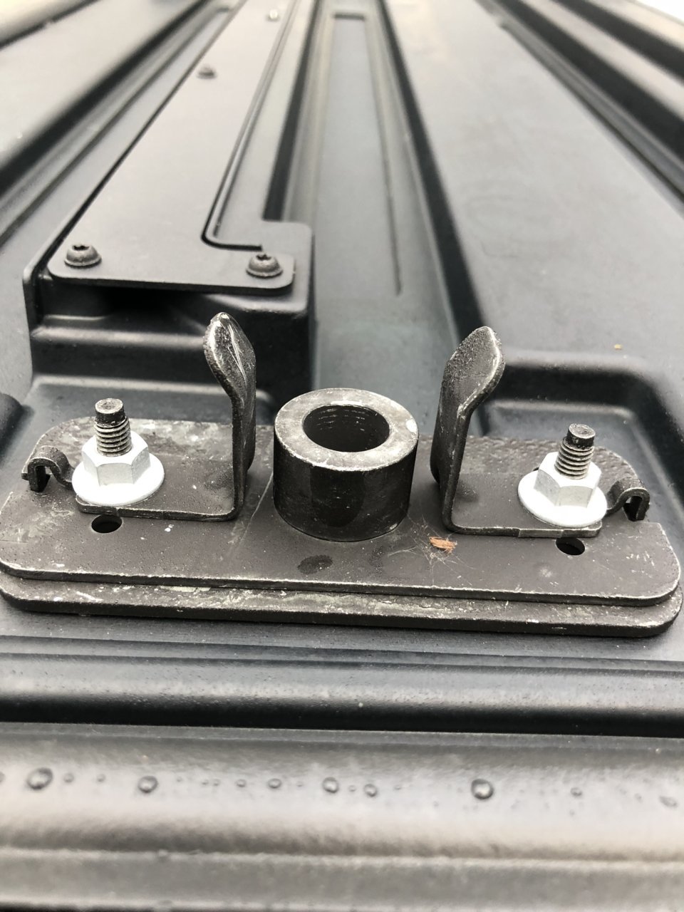

    So after the service department told me there was no way to adjust the cover, i looked at it a little closer and decided that i could make it tighter. before anyone mentions it, I do know about the double click on the latches, the above pictures were after the double clicks. i decided to alter the latch post by turning it upside down, and drilling new holes. the post i am talking about is in the red tacoma picture. that is not my picture, i found it on this forum but i dont know who to give credit to. and that picture is not of the part after i altered it. sorry i didnt take a picture. but essentially what this did was pull down the cover 1/4" or so which then appeared to seal it up. no more light came through when i looked under the cover. IMG_9698.jpg
    I also had to shorten the cylinder on the other side, that the security bolt passes through. the picture of that assembly is again, not after i trimmed it, this is how it looked originally.
    IMG_9727.jpg the

    oops...i skipped a step. before any of the above attemps. the first thing i did was pull apart the latch next to cab on the driver side and removed the spacer that was underneath. this had minimal effect, and actually caused the latch to have some trouble latching as the spacer actually provides some clearance for the working parts of the latch. without, the moving part of the latch was too tight to the cover to move freely. sorry, no picture.

    Strange, The cylinder spacer for the bolt on mine was too long as well. Grinding it down a little helped make the front seal ...Not sure why they made it so long, it defiantly made the front pop up and not seal.

    Thanks sandtaco...i tried grinding it, and decided it was more efficient to saw the end off with a reciprocating saw. not saying it was the correct decision...just documenting my own thought process.

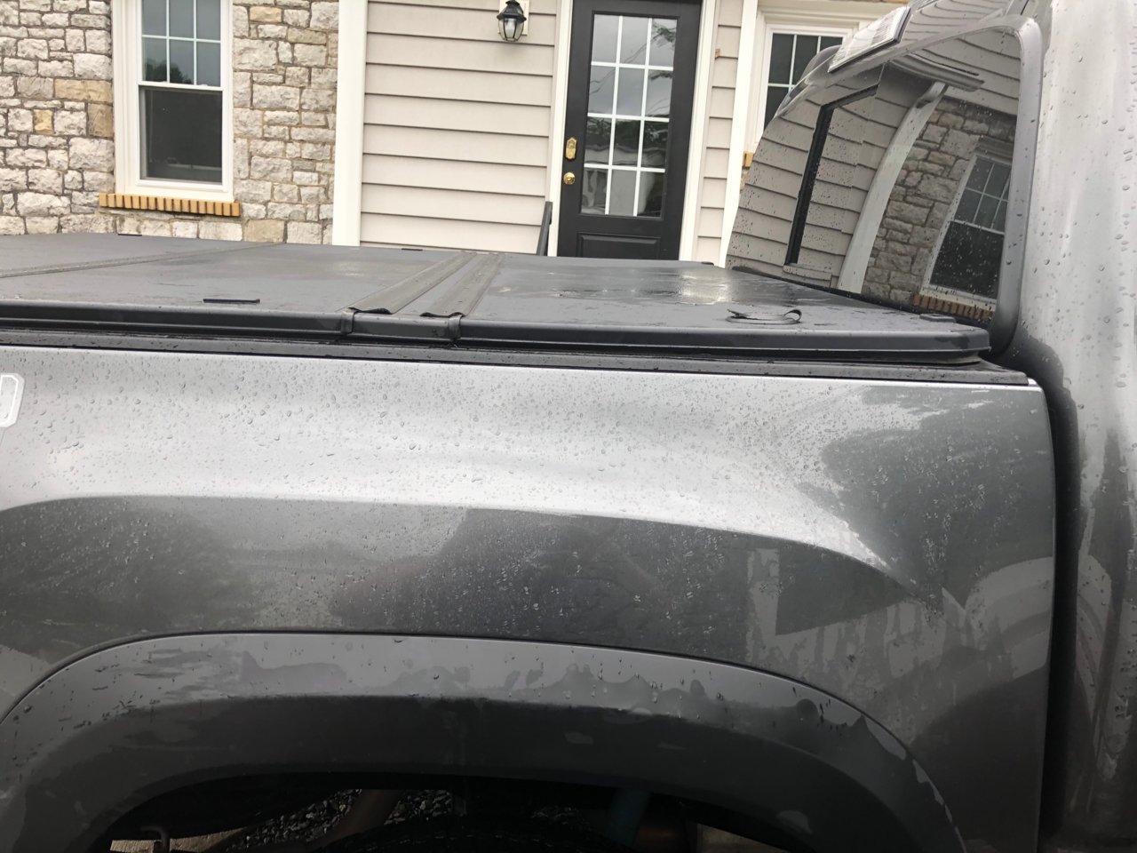

    OK, so now i have fiddled with the latch to no avail, successfully pulled both corners next to the cab down tight, and siliconed under my bed rails...also siliconed the gap between the bulkhead rail and the side rails. still had just as much water getting in. I then took a closer look at the bedrails, and decided that the texturing (the little raised dots and tracks) must be preventing the seal on the cover from actually sealing properly. like if the rail was smooth, it would seal better. so the next thing i did was run a 1/4" bead of black silicone down the legthn of the bed rail. i marked exactly where the seal of the cover would meet the rail, and center the bead so instead of meeting the rail, the seal would meet the bead of silicone. I was super high on this idea, but i never actually got to test it. i let the silicone set up for 24hrs before i put the cover back on. after having the cover back on overnight, i had to open it and as you can imagine, the silicone all came up with the cover. I though about trying butyl tape next, or letting the silcone cure for a few days, but decided that it probably would have the same effect and decided that even if i was able to get it last a little longer before pulling up, did i really want to be periodically reapplying silicone or butyl for the next 300k miles?

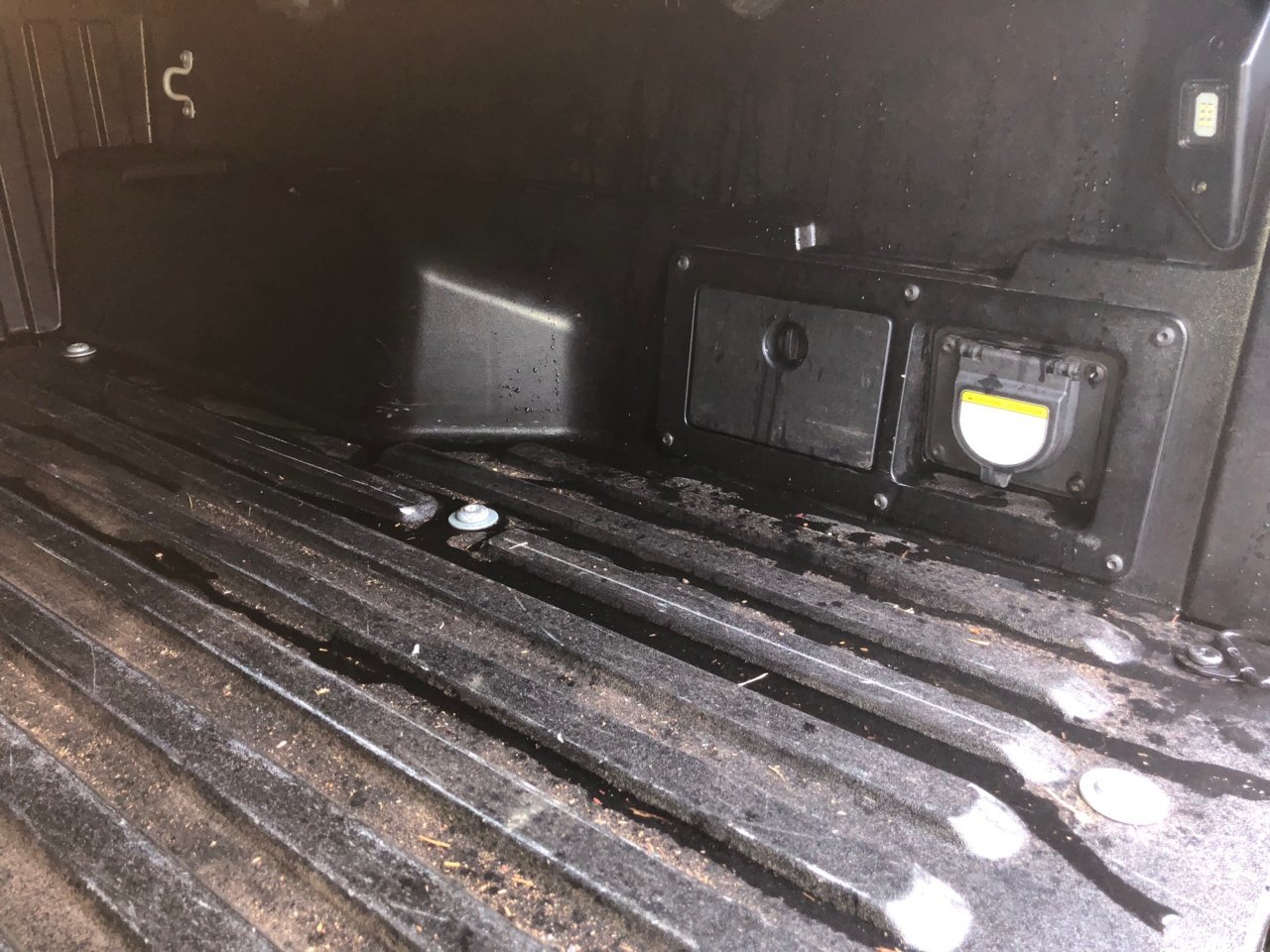

    last night we had steady (but not heavy) rain. as tonered mentioned, i did in fact crawl insider the bed with flashlight and looked around for more infiltration points. i saw water dripping in everywhere two panels met. not so much in the middle of the bed, just along the rails. so i am now satisfied that i have identified all the points where water can get in, but i have no desire to try and engineer a fix for the joints leaking. if anyone else has somehow managed to fix these areas of concern, i would be all ears. IMG_9854.jpg IMG_9856.jpg IMG_9859.jpg IMG_9861.jpg
