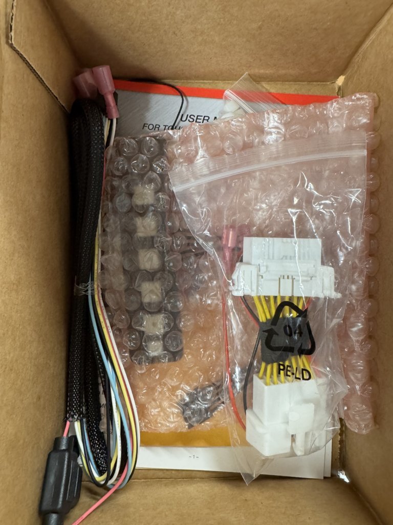

    The Part Number for just the Keypad Kit is:
    00016-00606-DL
    It can be purchased from sparks parts for around $150
    There is a "installation kit" available for another $150, but it is not necessary what so ever. So save your money.

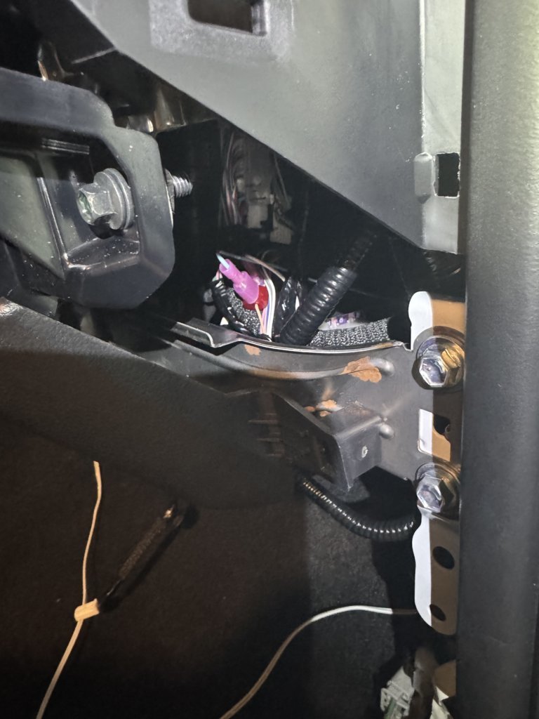

    2. You will see the kit comes with an adapter to tap into 12V Positive and Negative feeds from the OBD port. Install this just like the instructions indicate. No cutting or splicing is needed which is nice. And it fits right into the kick panel. And it's fused.

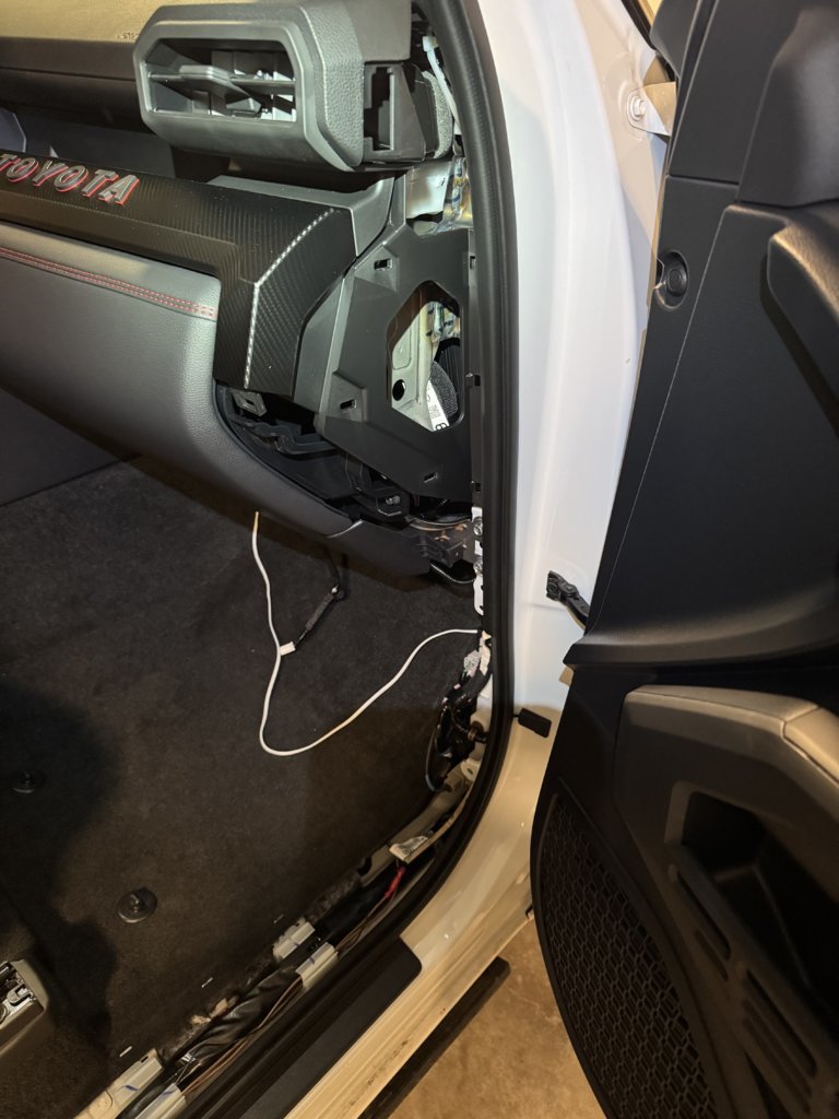

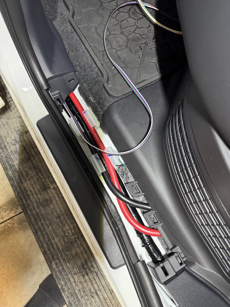

    3. Next, finding an ACC Power wire to tap is also rather simple. The kit instructs you to use a wire for the power mirror, but the harness for this wire is deeply buried on the 4th gen taco, as are most others connectors I found out. So I elected to tap off the AUX1. The wire is easy to get to, and a nice gauge to avoid any damage from the T-Taps provided with the kit. The wire color is Lavender with a GREEN strip.

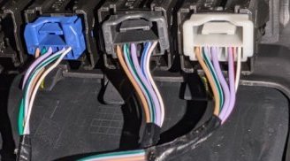

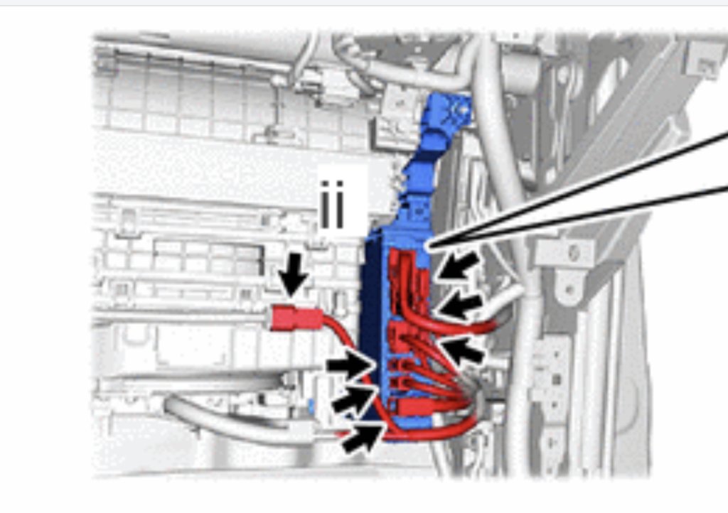

    4. Now, finding a site for the LOCK and UNLOCK signal is a bit more tough and this is the part that took me the longest. The EASIEST harness I found to tap into is actually behind the passenger side dash panel. Seen in the photo. You can easily reach your hand in and pull the BOTTOM black harness out and down to access it for tapping into. The harness needed is J61 seen in the Toyota illustration below. The LOCK wire is Tan, the UNLOCK wire is BLUE. I then ran the two wires under the middle of the dash to the drivers side. I was familiar with this path from my RC Power running board install. You can watch this install video and see how the wires are routed across to the driver's side.

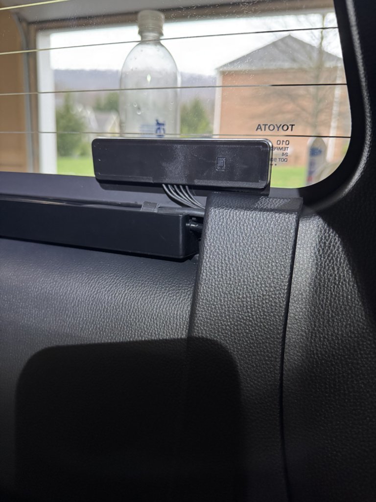

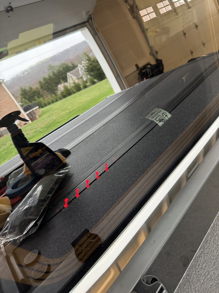

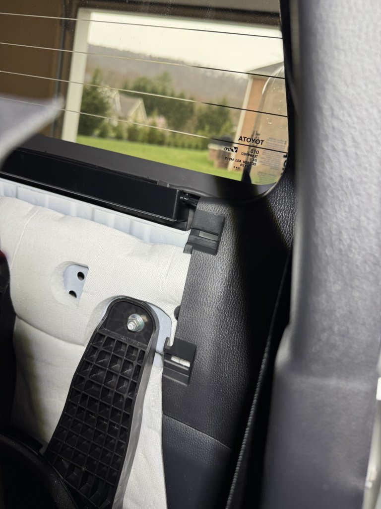

    The hard part is done. Now just choose where to mount your keypad and follow the Kit instructions closely. I elected for the rear window in the horizontal position as shown. I did have to cut and extend the 5 signal wires that come out from the keypad. I used a 5 wire bundle I found on amazon. The colors even match enough to not get confused. I routed this wire down behind the rear seat back panel, and across the two door sills to the driver's side dash where you join all the tapped connects.

    Man, this is awesome. Thanks for doing the leg work on this. The only real question is knowing which connector is J61. I understand you can reach your hand in there, but from that schematic, it looks like it’s a maze. thanks again!

    so when you look in there there will be an ECU with 5 connects going into it. Two big ones on the left hand side. And three smaller on the right. All stacked vertically.
    The bottom third one on the right is J61. It is black in color.
    mthopton[QUOTED] likes this.

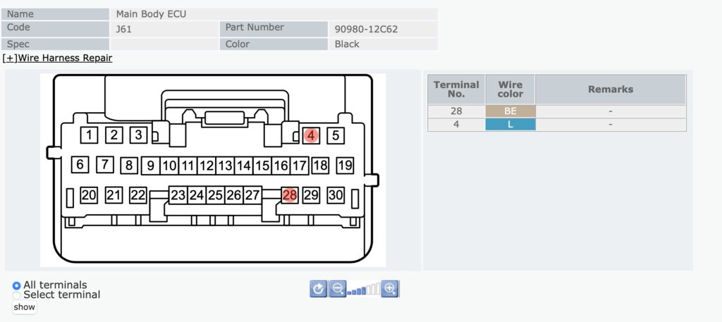

    Also, for J61, you want to go for pins 4 and 28. Not sure if there are other wires of similar color, so this will make sure you are tapping the correct wires.

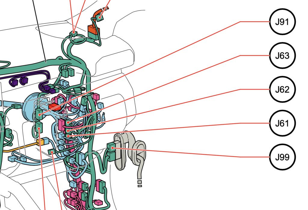

    the object in blue is the "ecu" and you can see J61 is on the right hand side at the bottom. NOT the left hand side.

    All the taps required are available on Driver's side door...:burp:

    Lavender and green is hot...:stirthepot:

    You're right! I went out and double checked and I am tapped into Lavender with Green stripe. Main post has been updated. Good catch!
