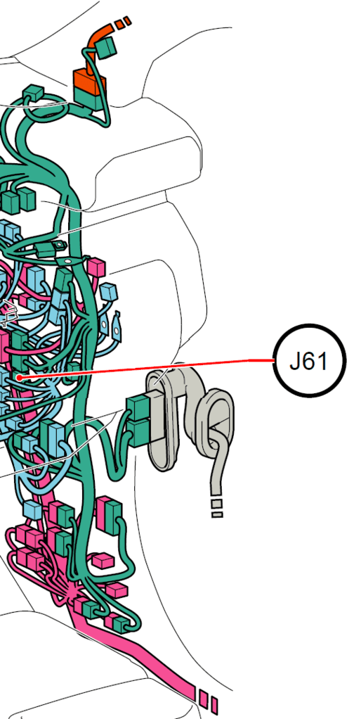

    Just printed the instructions and going back thru your post and reading again for clarity. I do like the idea of mounting in the back window, I may go that route as well.
    The diagrams of the ecu and j61/62 connectors aren’t super clear to me, especially as you describe pulling it down to make connections, but I’m sure it’ll make more sense once the panels are removed and I can see in there. The pic you posted of the wire hanging in the floorboard of the passenger side, particularly. I assume that you stripped off 3-4’ of the white & blue from the Amazon bundle to run over to the passenger side for lock/unlock functions and that white wire is what’s dangling in the floorboard pic.

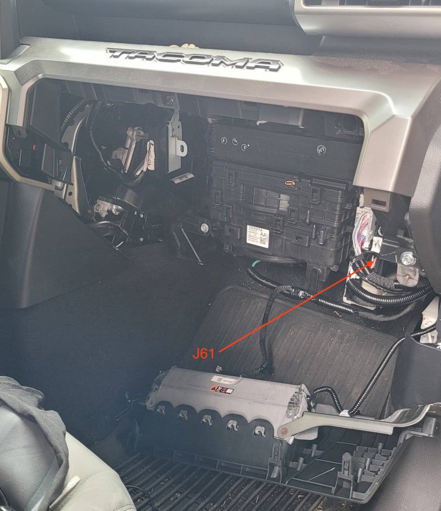

    Once you get in there with a panel off you will be able to eyeball the different connectors, and finding J61 will be easy at that point. The diagrams will help you get a lay of the land once you see all the wiring looms and connectors.
    That photo just posted is a perfect example to see where the ECU box and connectors live. But you do not have to drop the glove box to get to J61 which makes this so nice.
