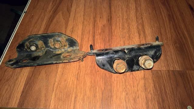

    If you look around on here in one of the regional forums near you, or on craigslist, you can likely find an OEM tow hitch for 100-150 bucks. Oftentimes they come with a bumper attached to them as well as others have replaced with an aftermarket steel bumper. Its not a hard install at all, i recommend doing it yourself. I added one to my 2.7L truck since it didnt come with one to the factory. Just be sure if you are buying used that you make sure you get the L shaped brackets in the picture below that tie the sides of the hitch assembly to the bottom of the frame. I got my hitch and then realized i still needed these, luckily another member on here helped me out and i was all set up. The install isnt bad if you have an extra set of hands, or a good racing jack. Ive uninstalled and reinstalled mine a couple of times. Piece of cake, just a heavy item since the receiver hitch and the bumper bolt on together (the trucks without a receiver hitch from the factory use a couple of brackets to hold on the bumper and the receiver hitch replaces this bracket which is why the hitch and bumper are sometimes sold as one piece).

    I just put one on and don't have the brackets.
