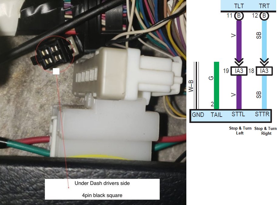

    Hey All, I'm considering acquiring a 2018 SR5 access cab with the 2.7 4cyl, automatic transmission from a family member. The truck does not have a receiver hitch or tow wiring. If I acquire it, I'll need to set it up with a hitch and wiring so I can pull my small aluminum boat (small single axle trailer, no brakes, 4 flat wiring).
    I know, I know, you can get one of the Curt or Hopkins T-connector wiring harnesses on Amazon for like $50. I've had bad luck with the internal components of the t-connector boxes melting and causing electrical gremlins that I had to track down on my 2003.
    So on my 2013 I was able to find Toyota part PT725-35120 for the trailer wiring. PT725-35120 had everything I needed from the dash all the way back to the 4-flat wire plug at the rear of the truck (flasher, relay, fuse, cable ties, etc). I was able to find a PDF of comprehensive install instructions that looked to be from the FSM. I am very happy with this kit so far and it has given me zero issues. The install was completely plug and play and with all genuine OEM components. I much prefer this route over the connectors that are wired into the tail light and would like to go this route if I can, on this 2018 truck if I acquire it. I haven't cut a single wire on my 2013 and any electrical stuff has been with OEM parts and plug and play. I'd like to continue that with this 2018 if I get it.
    Has anyone on here installed OEM tow wiring on a 3rd gen truck that wasn't factory equipped? It seems like PT725-30250 may be the applicable 3rd gen kit, but I can't seem to find anything online about it. There's no pictures of it on any dealer websites or ebay. I'd rather not spend $300 just to find out it won't work for me. Curious if anyone else has gone down this path and found an OEM solution?

    Search the Taco you're going to acquire, find this:
    then we can continue answering your inquiry.
