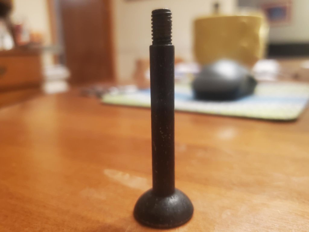

    What did you use as a replacement for the "swing arm bolt" ? This is next to impossible to find!

    I don’t recall replacing those.

    Something like this will probably work. It is nothing more than a shoulder bolt so you just need to make sure of the length. You can also look on mcmaster-carr.
    ZSPEC M6-1.0x59mm Shoulder Bolt, 50.5mm Shank Length, Titanium
