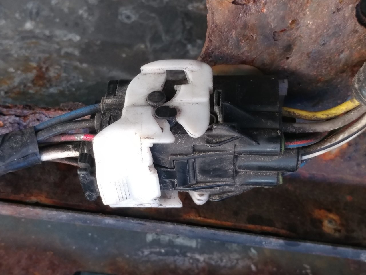

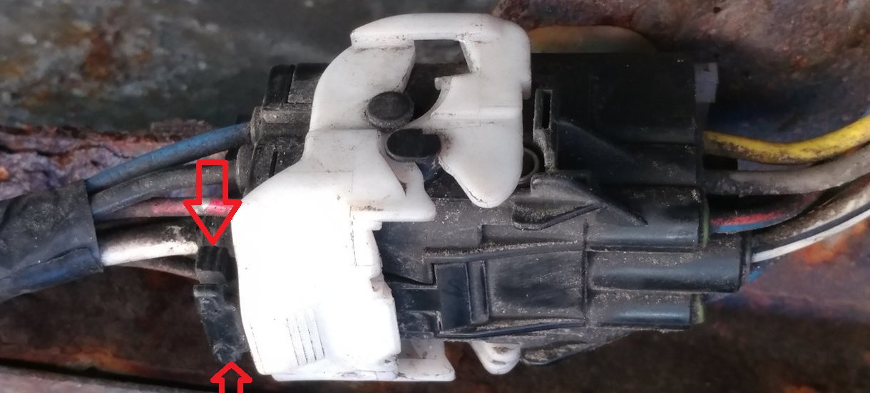

    2007 Tacoma Trailer Hitch Electrical Connector.jpg My 2007 Tacoma OEM trailer hitch is badly rusted. Today, I prepared to remove the hitch but I have run into a problem. I have not been able to unplug this electrical connector. Any advise on how to unplug this electrical connector would be greatly appreciated. Thanks in advance!

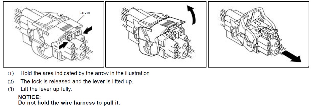

    Maybe this way:

  3. May 25, 2020 at 6:36 PM
    Techguy1329
    Techguy1329 [OP] New Member
    May 25, 2020
    #329264
    2
    Very Good! Thank you very much.
