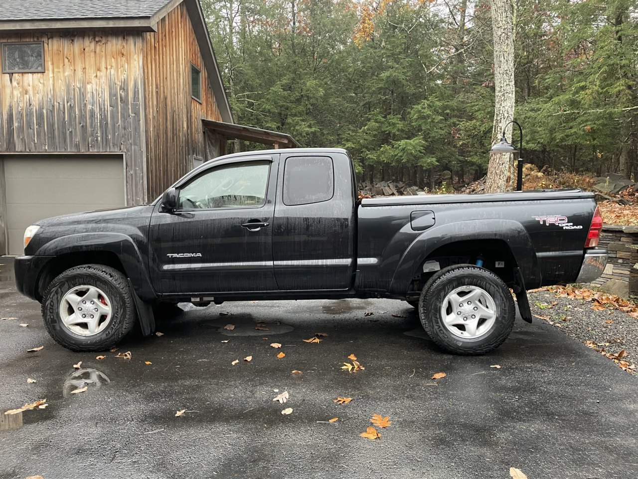

    Last December I bought an '07 TRD, which probably still had the OEM struts/shocks. A few months later, the driver's side strut snapped while the truck was fully loaded, squishing the coil over. The rear driver's side leaf got bent backwards, either from the load or the unbalanced suspension. So, needed new suspension all around. I went with 4600s/Moog coils and what were supposed to be OEM height rear leafs from General. They weren't. I now have about a 2" lift in the back and stock height in the front, even after several months of settling.
    To your question, the ride is OK. My '03 had a much better ride and feel for the road though with OME 880 coils/Rough Country struts and shocks, but that may be more due to the smaller from factor.
