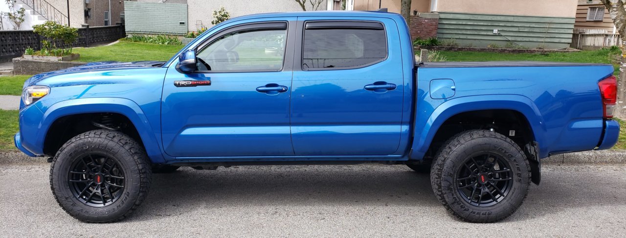

    I chose the Eibach Pro-Truck Stage 2 kit with 1" rear blocks. I like that the front coilovers are adjustable on the truck if I add a bumper or anything later on. I also liked the quality and price. The Stage 1 kit is similar to the Bilstein kit, using clips to adjust the height.
    I have about 5000kms on the set up and am happy with the look and ride quality. 20220531_145634.jpg
