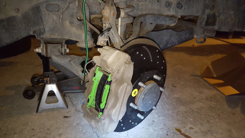

    I went with ebc green stuff and the slotted and drilled rotors.

    2003 DCSB TRD OR
    How do you like it on the Tacoma? I've run that setup on my BMW and really liked it. That is likely the route I will go on the taco when the stockers wear out.

    Only got about 600 miles on them, so far i like them, the fact my steering wheel doesnt dance everywhere is good enough for me lol
