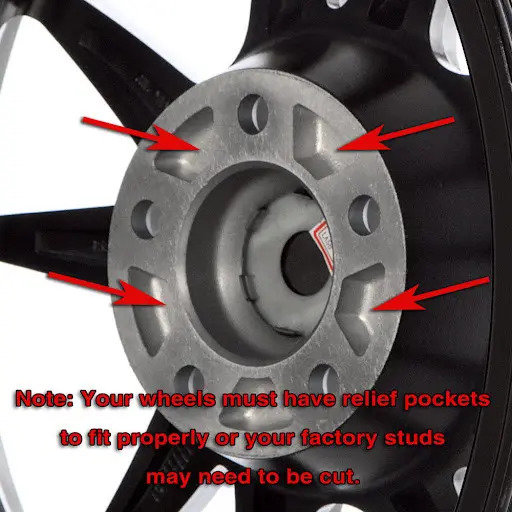

    Looking to make a list of OEM wheels that have a relief on hub that can accommodate a 3/4" spacer. My intention is find an oem 15mm offset wheel that can take a 3/4" spacer without needing to grind the lug studs. With a 15mm offset and a 3/4" spacer the new offset would be -4. This is really close to optimal to fit a 285 with very little modification.
    I know the following wheels do not have this relief.
    4Runner TRD ORD
    Do any OEM 15mm offset wheels exist like this?

    Wheel spacers are for situations where you don't want to spend money on new wheels. Makes no sense to buy new wheels AND spacers vs. just buying wheels with the target offset.

    Agreed... Unless you had your heart set on a new wheel, I would just look at SCS. They have plenty of wheels to choose from that are direct fit. They have reasonable prices if the fitment isn't exactly -4 you could always get a 0 ET and 1/4" spacers .. that would be pretty close

    Just an FYI, pretty much all modern OEM cast wheels will have the relief pockets. It's the depth of the relief that varies from wheel to wheel.
