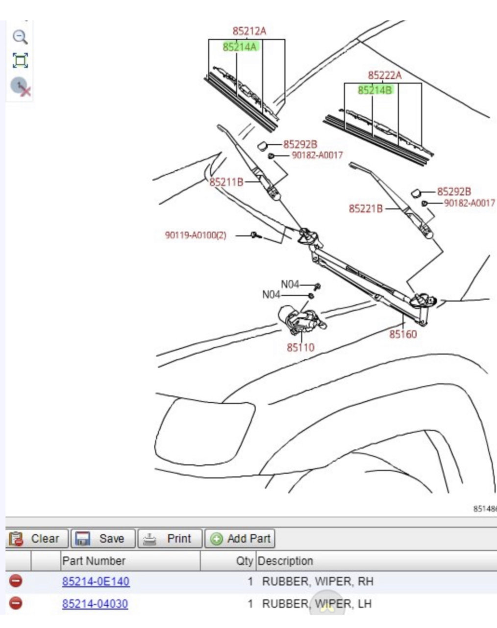

    Has anyone ordered 85214-04030 recently from the dealer? It seems to be listed now as "Not for Sale" at the online dealer I use.

    Is there a left and right are they the same?
  7. Dec 13, 2024 at 9:22 AM
    #27
    Sasquatchian
    Sasquatchian Well-Known Member
    May 30, 2018
    #254922
    722
    Not the same. One is slightly longer than the other.

    The OEM Wiper Blade/frame part numbers for anyone else interested that may want to do this. I have the Insert parts numbers around as well. I'll dig them out and update this post when I find them.
    85212-04031 Passenger 21" (RH) Wiper Blade
    85222-04030 Driver 22" (LH) Wiper Blade
    Note: The above part numbers are right from the Toyota parts number sticker on the plastic bag they came in. Purchased in 2022 or 23) I mention this because I have seen different parts numbers for them. Same thing for just the inserts. Verify the part numbers with a dealer before ordering.

    Were these assemblies for the '14 in your profile?
    Thinking they should fit my 13 as well. I'm a big fan of OE refillable assemblies. My truck was lightly used when I got it, but the original stuff had already disappeared.
    Edit:
    Putting those 2 numbers from the pic in Google brought me to Amazon, parts from Fred Haas Toyota of Spring Tx
