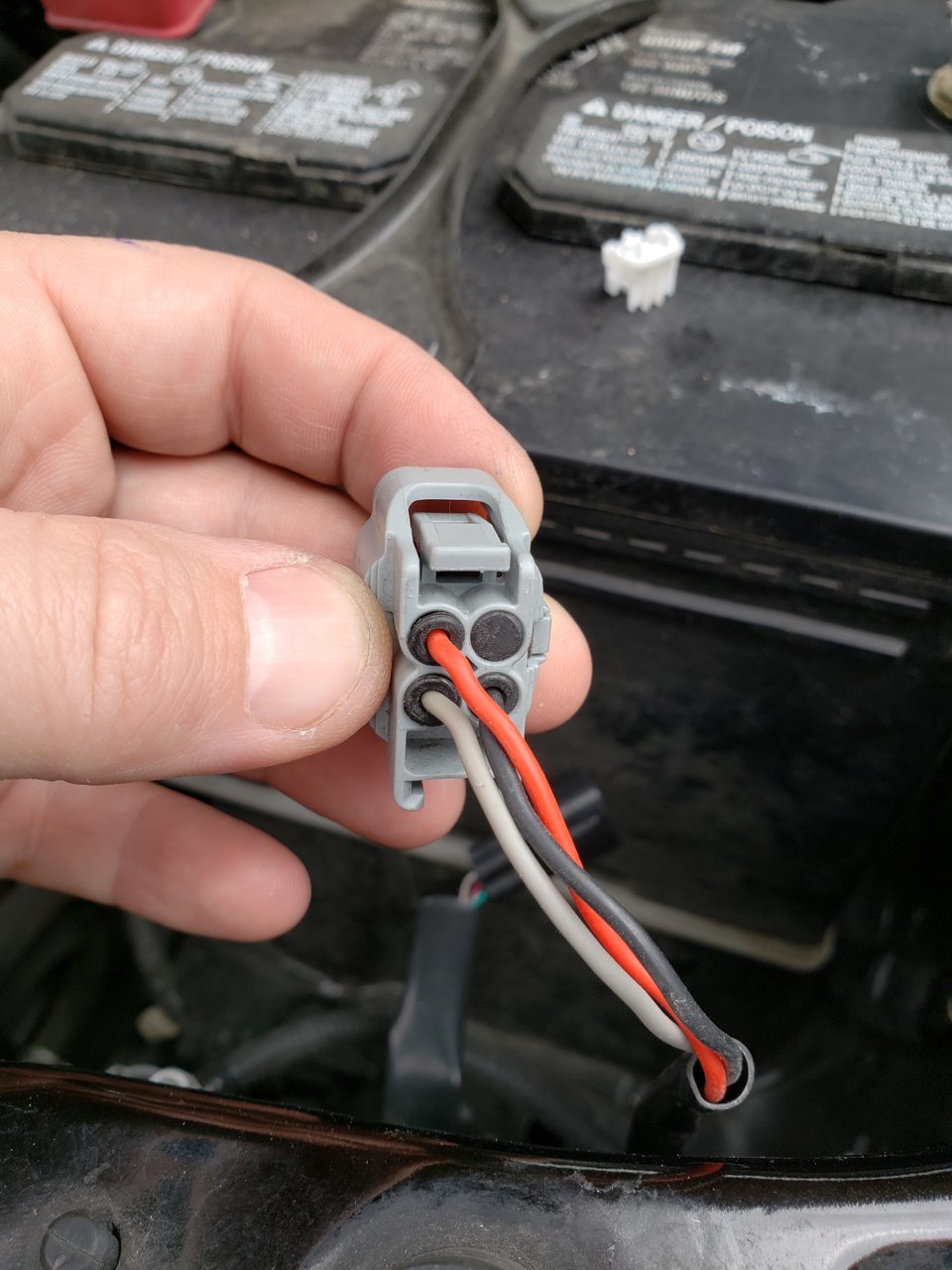

    Do you happen to know what each of those wires is for? I'm sure black is ground.

    Here is what I have for the oemassive harness (same for passenger side)
    Here is what I have for the oem harness
    I didn't do a card like this for the passenger side, but here is the wiring:
    White/Black - Ground
    Green - DRL (auto)
    Blue - Parking
