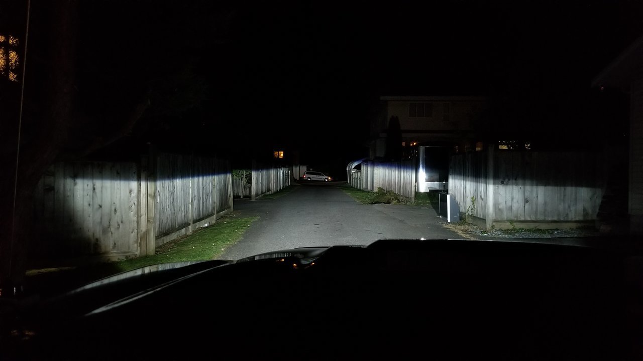

    How was the light output/cutoff?

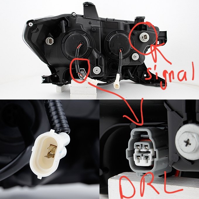

    Couple things with the chords, for one thing the drl chord on the housing never fit the socket for my truck. I believe you’re gonna need to order an after market attachment to connect those two together. Another thing, not sure if your guys tacomas come with 5 lighting chords but the new housing comes with 4. So one of your chords on your truck won’t be used. Not sure if it’s safe to drive with the extra one just dangling out. I’m no tacoma expert, but these were seriously a waste of time. But if anyone knows a good place to get blacked/smoked out headlights please lmk! Again do not buy these headlights!

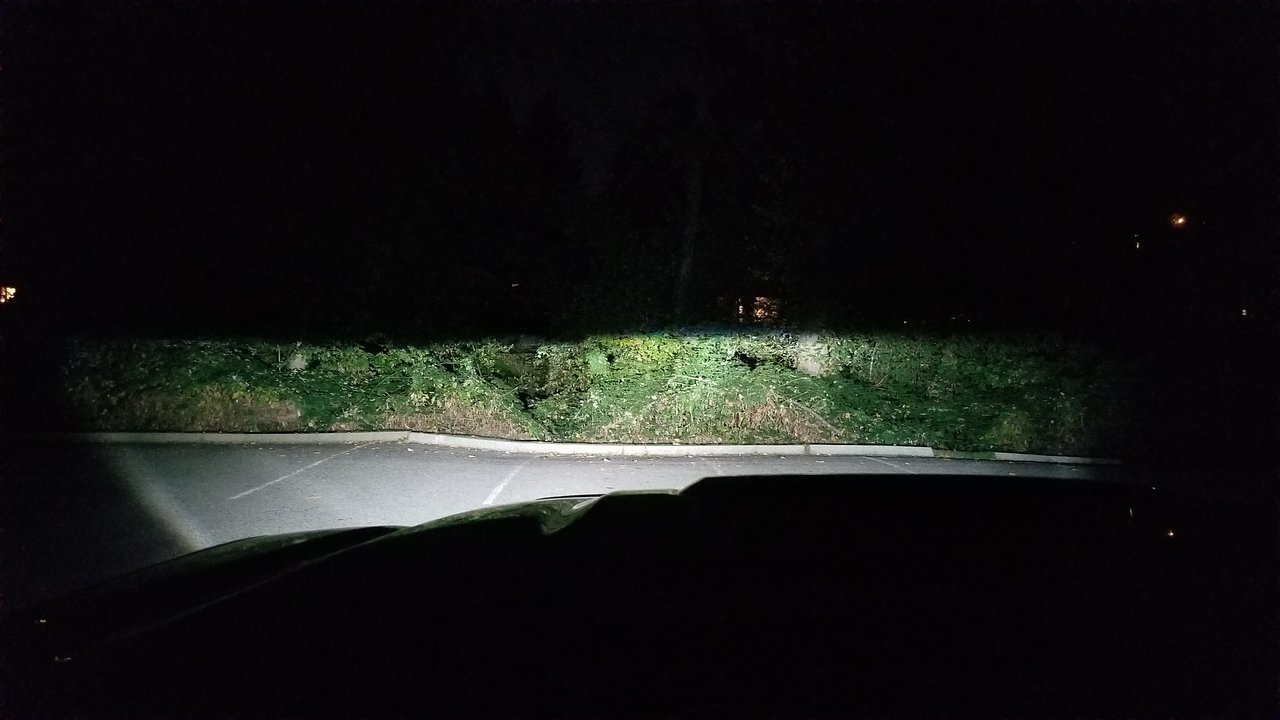

    20171003_211459.jpg 20171003_210738.jpg I'm running the oemassive lights and currently love them. All the plugs worked perfect. Yes the glue was stuck to the packaging but I have had no issues with moisture in the lenses. I'm running 55w HID in them. Have attached some pics of the output. Nice cutoff line and output

    are those lights only from the LED daytime running light, or you have your low beams on?

    How did you connect your lights to your truck? Did you need an after market socket to connect to the drl?

    This is my low beams

    Everything connected no problems. What are you having issues with? Did your truck have factory white drl?

    I’m having trouble with the drl. I just called anzo usa and the guy told me I had to cut through some wiring and reconnect them to my old drls plugs on my old housing. He said he recommended a mechanic to do it. But he said anyone who orders these lights will have to do it. How much outputs on your headlight did you have? 4 or 5?

    Send me a pic of the back of your lights that you got. I had to-do no modifications to the wiring to get these to work. Did your factory lights have the white DRL led

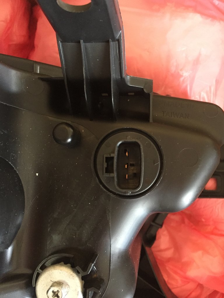

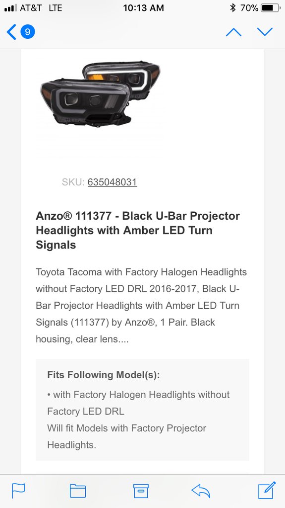

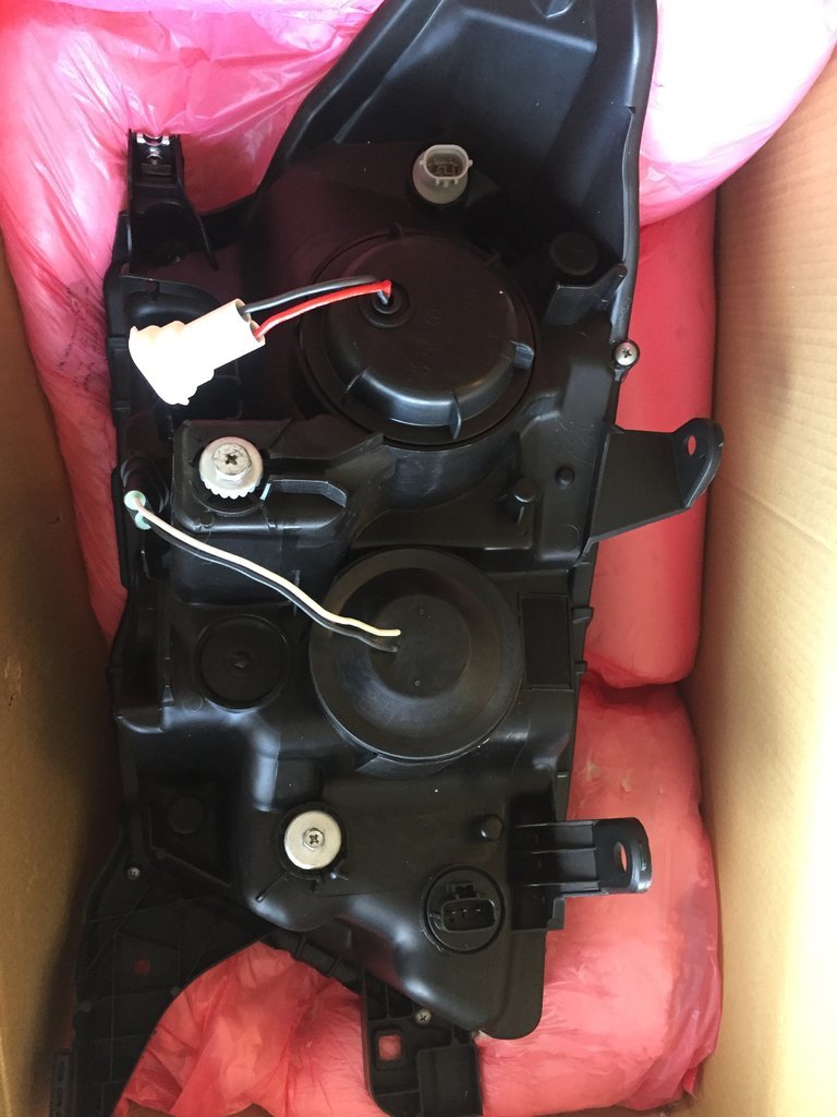

    Yeah will do later. Your whole setup is different from mine. This is what I ordered. I’m not sure which ones don’t connect but I’ll get a picture in when I get back from work.

    My turn signals are totally different

    Those appear to be for the SR5 models.
    (No DRL LED harness) and the turn signal socket is 3 pin (because SR5's use turn connector as DRL too)
    All other models are 2 pin
