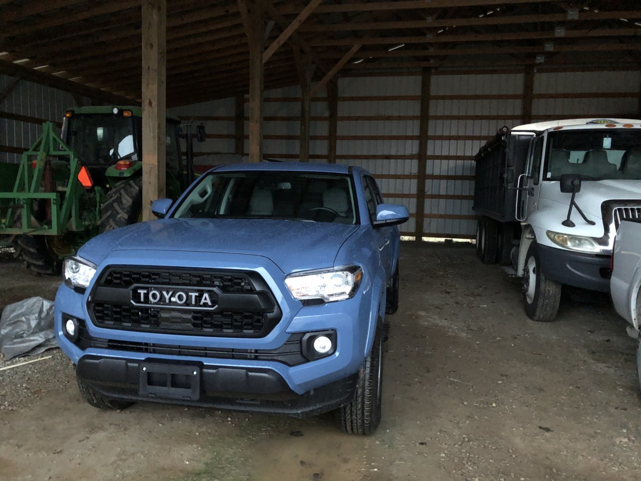

    i got the OEM trd pro grille. Long story short I installed myself now I have a TSS malfunction. What should I do? Anyone else had this happen also my tire pressure won’t read DBE3D8B7-1ED6-415E-AC49-3E49D8FFCBB7.jpg

    Did you drive it a bit? It takes a few blocks to register

    No it was practically dark when I got finished and my girlfriend was over I drove it maybe around 700ft

    Stupid question but did you plug the sensor back in? Check that it’s all the way plugged in as well. I did that with mine at first, left it unplugged and wondered why it wasn’t working. Then I kept getting the error in rain or snow until I bought the Pro garnish piece, and all is well now.

    I initially forgot it turned on. Turned back off and reconnected it l. Same error as disconnected.

    Was it raining or snowing when you first drove it?

    Like I said before I really didn’t drive I originally said it was 700ft but it was more like 500. But yeah it’s been raining all day but I did put the garnish on as well.

    Gotcha, yea mine was fine right away, but some have had to drive it for a while before it “recalibrated” and went away. Hopefully you get it sorted.

    I guess ill drive around before my dealer opens tomorrow and if it doesn't clear I will take it like a man and get bent over backwards at the dealership

    not to mention it doesn't make sense why the tire pressure isn't reading either but I guess it may have something to do with that

    Pull battery and reset first

    Just the positive post I assume.

    Sorry that was dumb just kind concerned. I realize put battery just mean pull power. But is there any reason why that would do anything or is the computer always on even when there is no key in the ignition?
