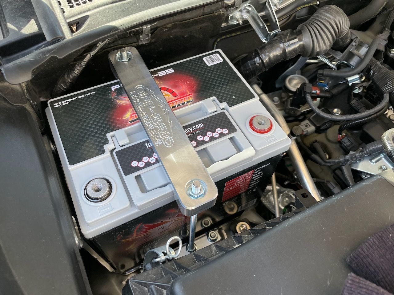

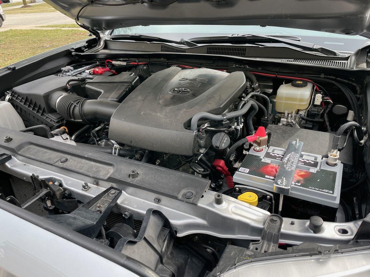

    I totally recommend the product. Quality fit and finish with everything. :thumbsup:

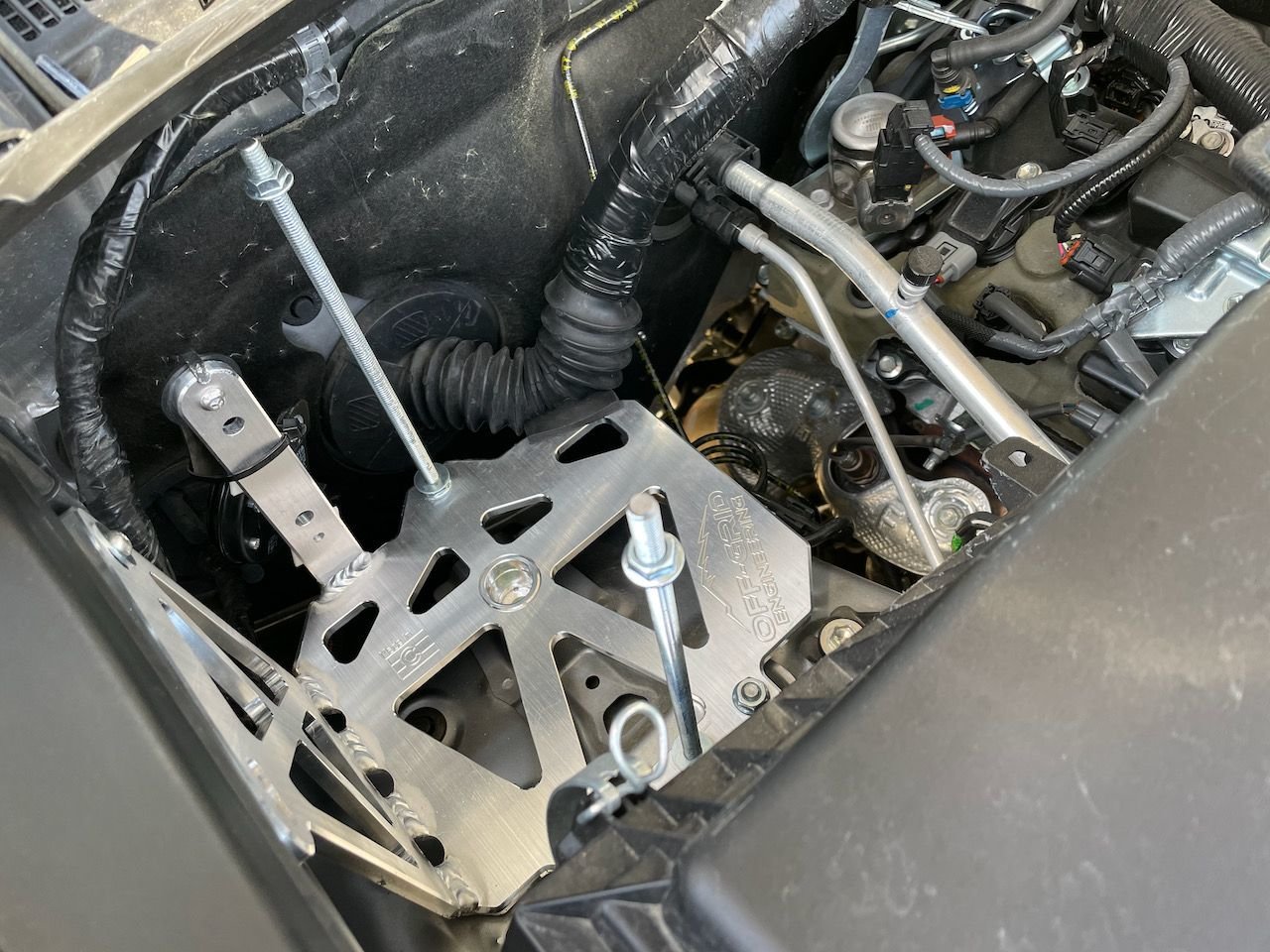

    I moved it to the bracket on the back of the tray. I think I had to bend the bracket a bit, and used a provided screw and a zip tie. I also had to push the wiring harness back and I put some padding against it and the tray. It is a tight a fit.
    Otherwise, the wiring harness and the main tray with the relay was perfect.

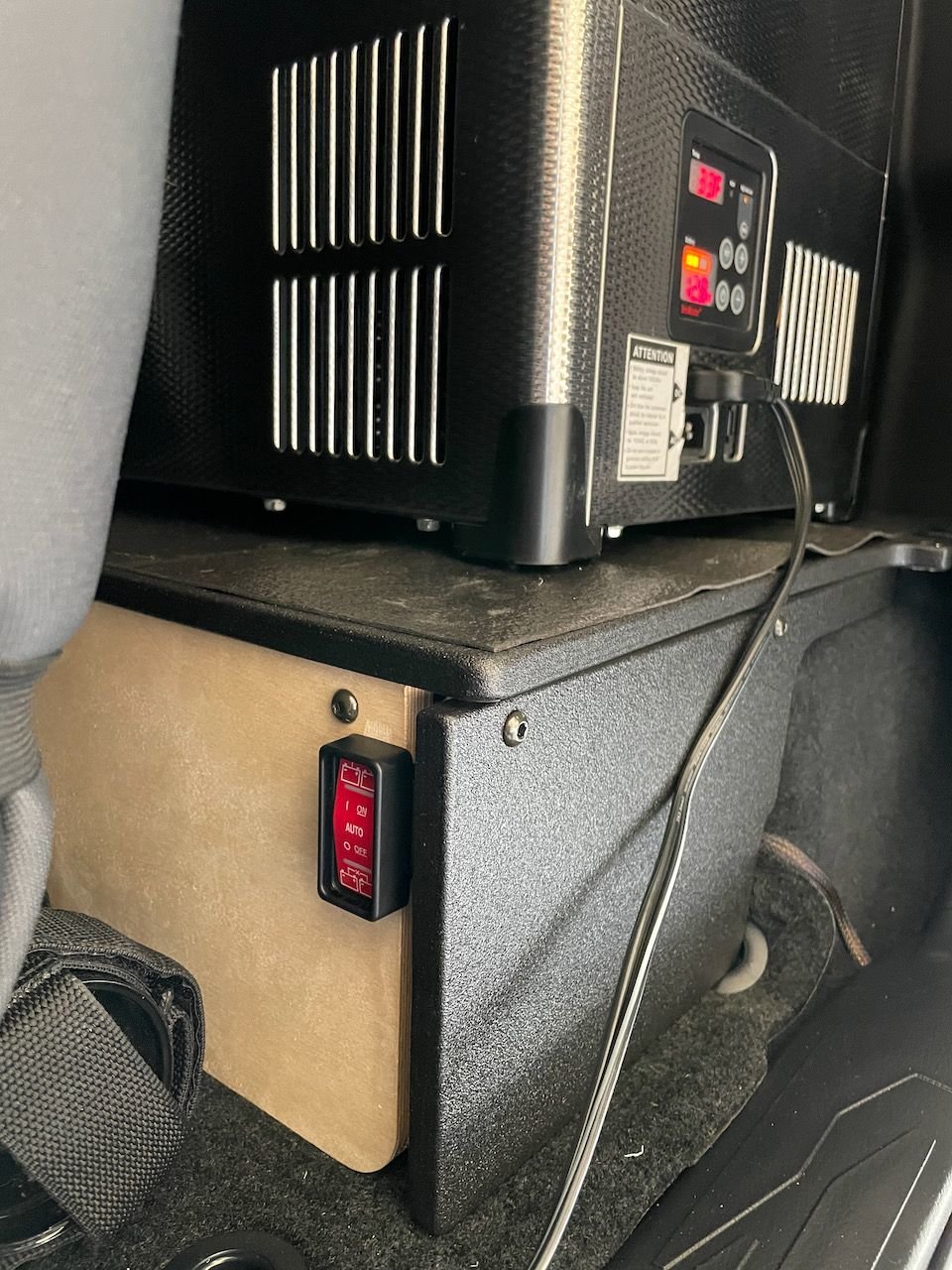

    I then ran the relay's switch through the firewall and mounted it below my fridge (on the side of my Goose Gear platform). I have an Anderson plug from the Auxiliary battery to my fridge. I don't run the fridge all the time, but it's great for trips (I just spent four days camping ... no ice required!). The fridge cools down quickly if I want to put something in it and keep it cold.
