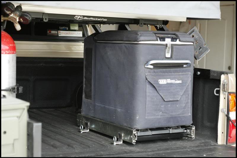

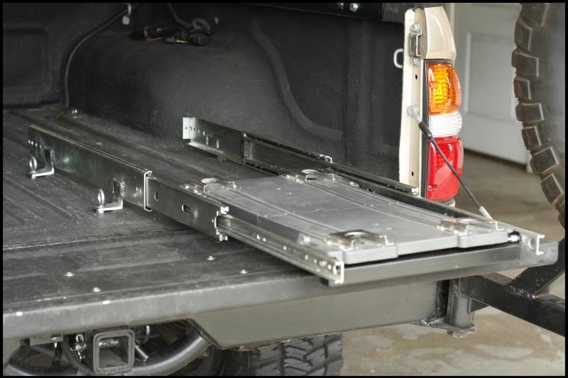

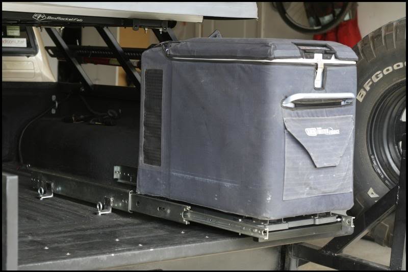

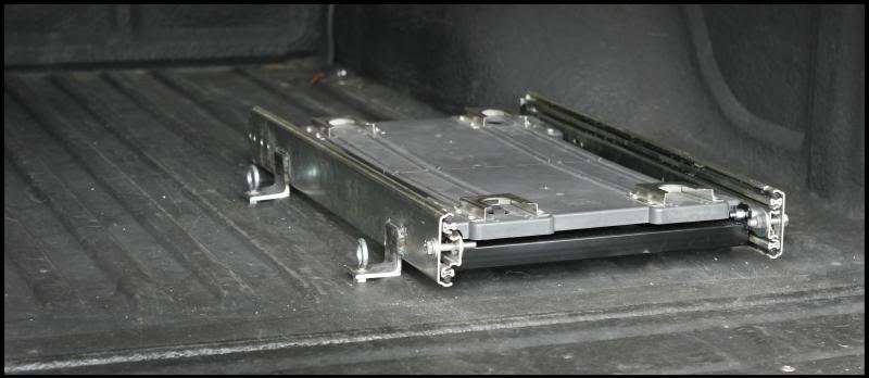

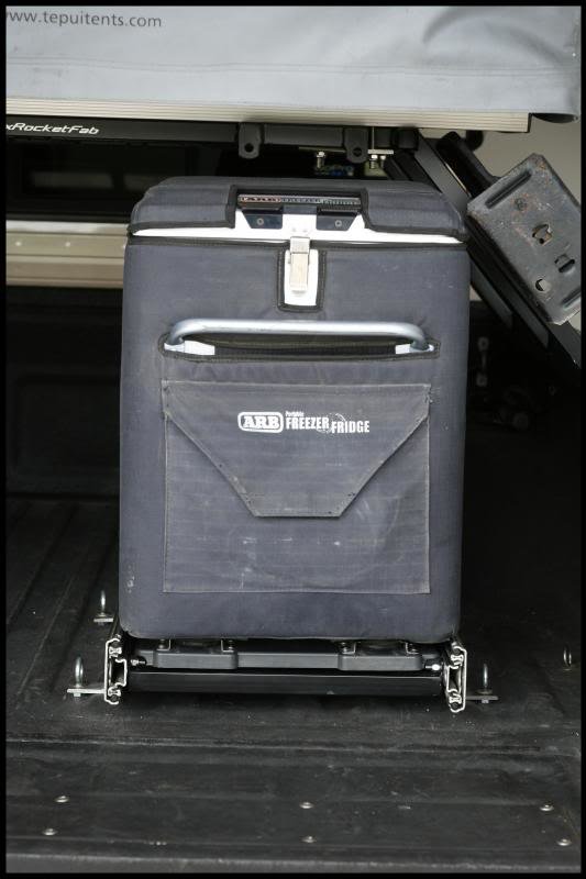

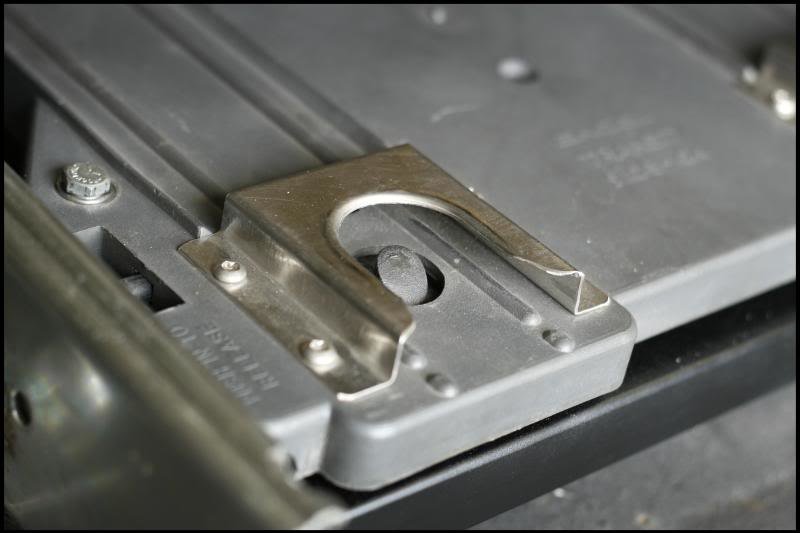

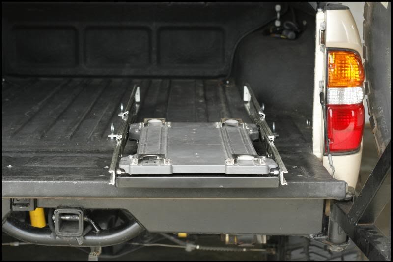

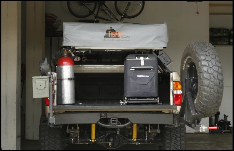

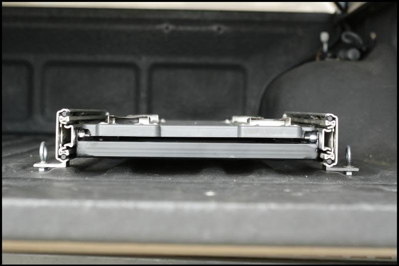

    I built my own slide. I found some HD slides at a local warehouse. I've had them for about 10 years but never used them until now. I built a basic frame from some 1" square tubing and mounted by Engen Transit lock to it and attached the slides. It's bolted to the bed floor with some eye bolts that act as extra tie downs.
    getting used

    Looking good!
