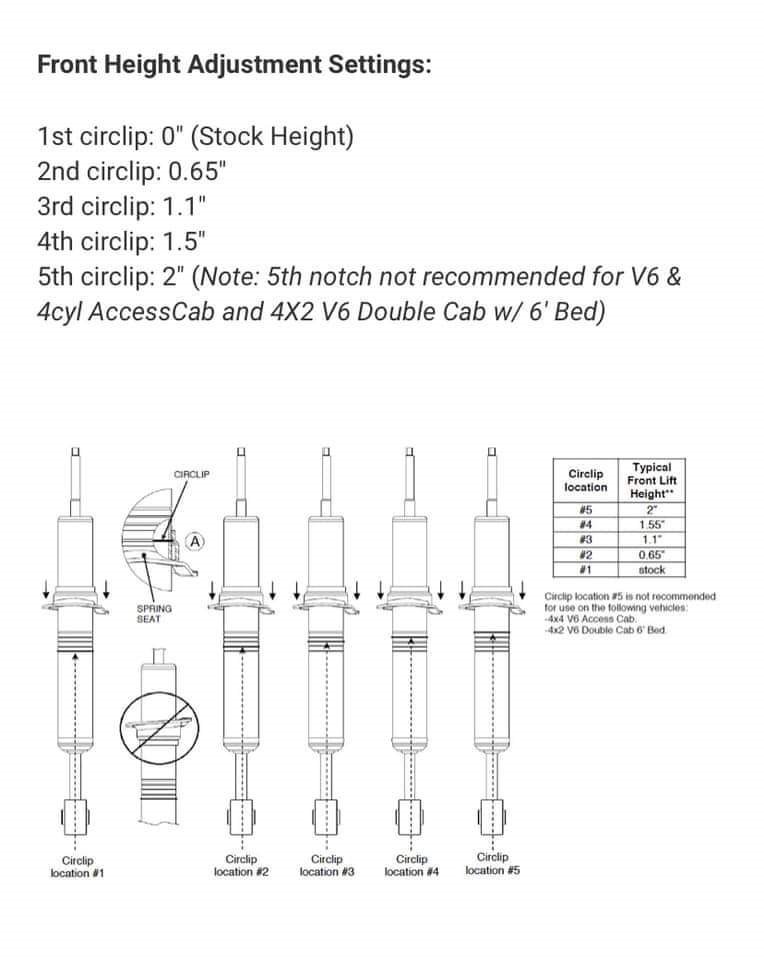

    Gents,
    Just noticed that position #5 (2”) is not recommended for access cabs. Can anybody confirm? I understand the truck would not be as heavy but would love some real world advice on the effect or lack thereof. Hoping to get this installed Wednesday as rain is forecast for the next few days. Many thanks in advance!

    You are correct. But #4 @ 1.55" is pretty close to 2". Do it, do it!

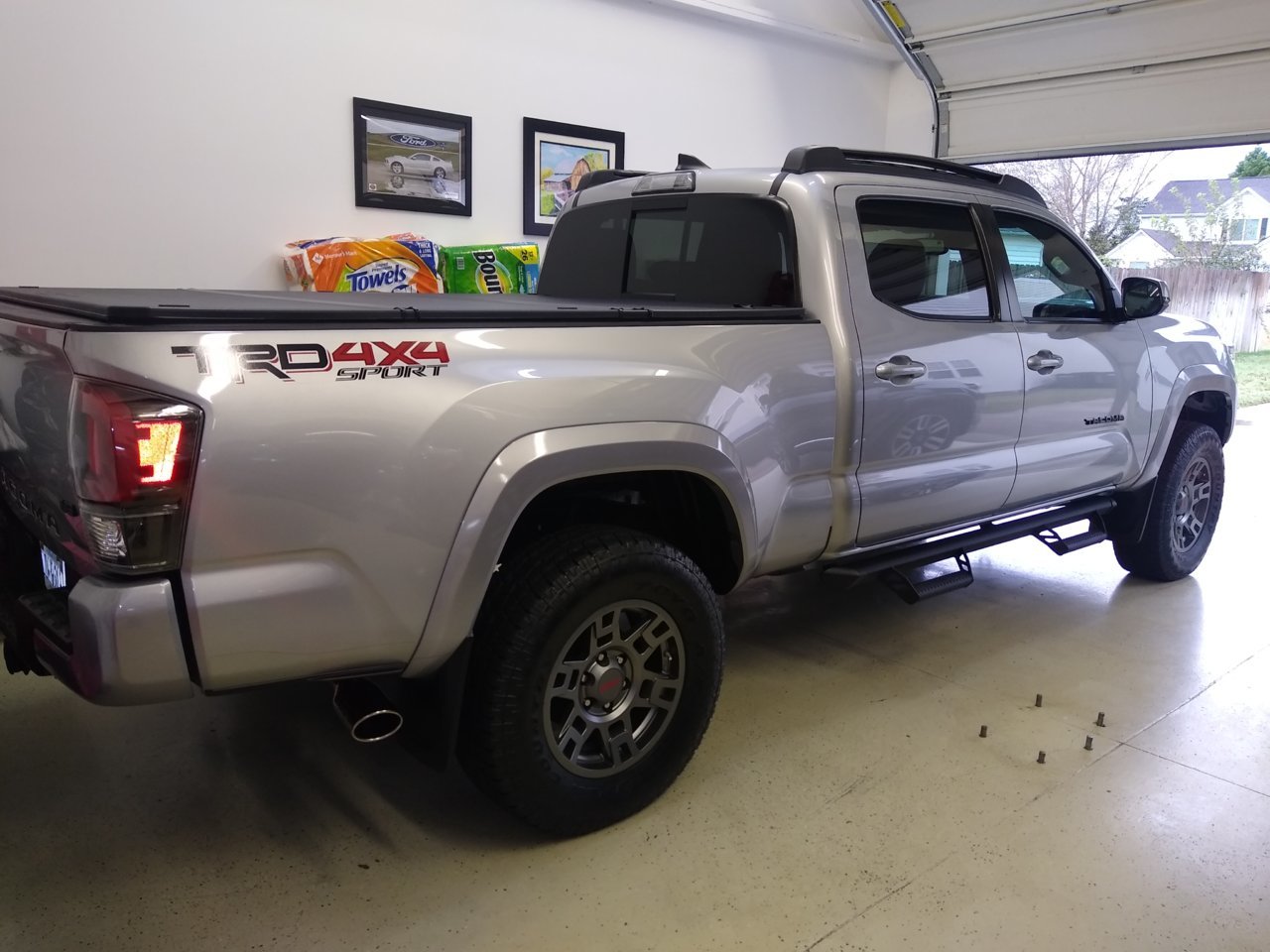

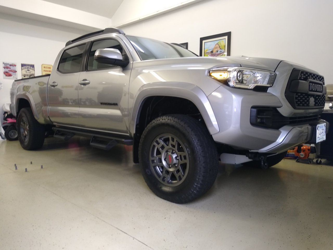

    I didn't have any vibrations, everything was done at one time, added it per the advice of a few fellow members here and the owner of a well known off road shop that's been doing the best work for many years here in our area. I did develop a vibration at 58 to 62 mph but a wheel weight was lots during the first 100 miles and was rebalanced and it's been perfect for close to 4 years. The front diff drop and rear carrier bearing dropgot everything back to spec and it was a preventative move like the ecgs bushing also. I did a 1/4 shim for the lean and also the sumo bump stops were later added. Awesome ride and very smooth, vibration free and with the Toyo at2s SL rating kept the rubbing issues and calibration perfect. IMG_20221004_091950628.jpg
