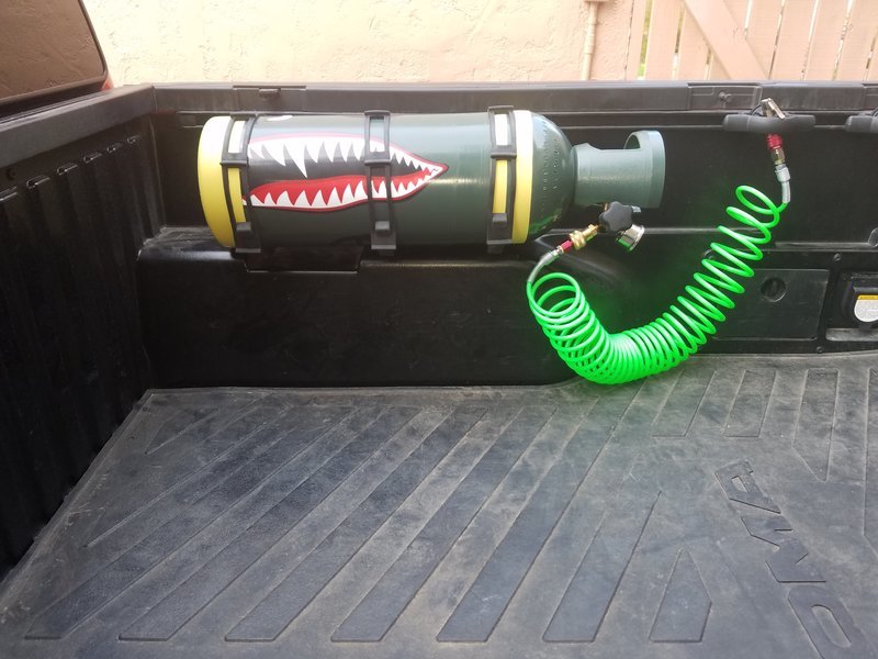

    I run icons too and will say that airing down takes out the vibration of washboard roads better than any coilover can. I usually run between 12-15 psi in those situations. A good Co2 system will fill your tires back up in about 20 seconds a tire. I built my own for much less than the ready to go systems.

    If you're adjusting your tires that much, is it really worth paying the premium for Co2 vs regular compressed air?

    Well it's about $25 for 20lbs of co2. That 20lbs will fill a 33" tire about 80 times. Co2 is stored as a liquid so there is a ton of volume in a 20lb tank. Since it's a liquid there also no reduction in pressure as the tank gets lower. Co2 is also slower expanding gas so it's actually safer than air in a compressed state.
    I also have an ARB single piston compressor that is in backup status now. It would take that compressor at least 15 minutes at least to fill 4 tires from 12 to 32 psi and not to mention it would get hot enough to to blister your skin. The co2 will do the same job in a couple of minutes and no moving parts to burn up. For me it's totally worth the convenience and in the long run might even save $ considering I won't be burning up any OBA compressors. My .02

    Ballpark me a number on your tank set up that shit is dope. I can't use my Walmart air compressor/jumper cable set more than the one time I bought it for. It was a waste of 45 bucks. Unless you need a jump.

    So I have a good friend in the beverage industry that was able to get me the 20lb tank for free. I then bought the 0-250 psi regulator for $130 from wheelers offroad. They also have a fixed 150 psi regulator for about 50 bucks if you want to keep cost down. Then airline and fittings cost me 15 bucks on Amazon and add another 15 bucks for spray paint and masking tape for the unique paint job. I also spent about 30 bucks on the large tank quickfist to mount it in the bed. You can check craigslist for beverage co2 tanks and I asked the guy at the fill station about converting aluminum co2 fire extinguishers to a gate valve and the guy told me it was possible but would need a hydrostatic test ($25) after the conversion. You can find old co2 extinguishers much cheaper than a beverage tank.
    Much cheaper than a similar power tank setup which runs $540 and just as effective.
