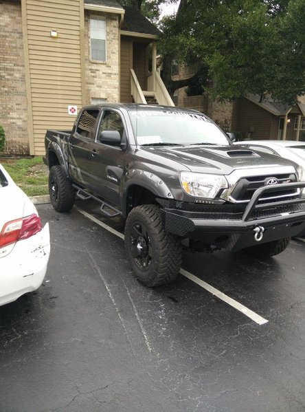

    Was just wondering if anyone has a similar truck with some off-roading experience that could tell me what I am and am not capable of with my Tacoma PreRunner. I'm not looking to go driving through anything crazy, but I would like to know what I should avoid if I don't want to get stuck. I have taken it to the beach several times and haven't had any issues, but I think I'd like to step it up a notch maybe.
    Thanks!

    Off topic! But that's mean looking bumper !
    Never seen one

    My brother in laws company manufactures those bumpers, front and rear. Toughcountry.com of you're interested! And thank you by the way! It looks really good on my truck I think.
