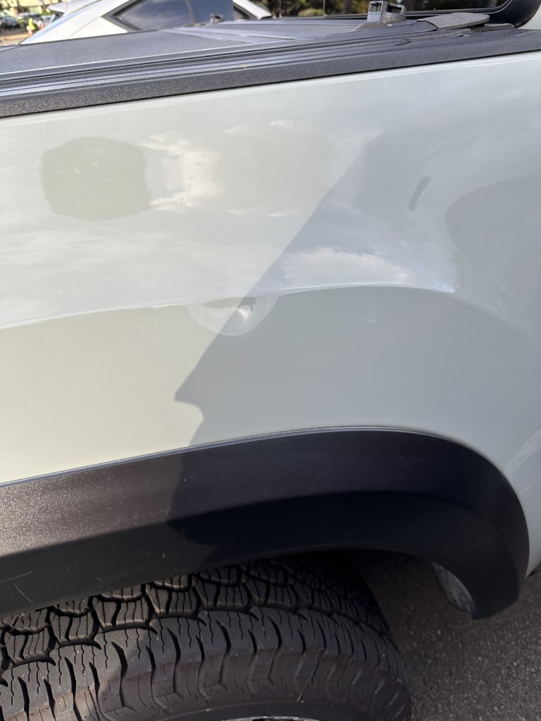

    In order to get behind rear panel, do you have to take off fender?

    Pic would be helpful. If damage is on the rear quarter panel, you can lay on the ground and look up into the cavity between the body panel and the bed without removing fender liner or flare. Of course location of the damage would determine what has to be removed to repair it

  9. May 5, 2025 at 1:01 PM

    Stupid, I threw a bad throw and hit my own truck.

    Oh man being on that body line, it’s going to be difficult to get out. To access that area you’ll need to remove the screws holding on the fender liner/flare and pull the liner, but the flare should be able to stay put. The OEM liners are really thin and will probably be a bear to get back in I would imagine

    Thank you, so stupid yeah? Never tried paintless dent repair, excited to see how it works. I've seen some amazing work from paintless dent repair guys.

    OP, don’t take anything apart take your truck to a good PDR tech….
    That will be an easy repair for a good PDR shop.

    Most likely they will not need to remove anything they’re plenty of access points.

    Could you remove the black trim on the top of the bed rail? There are holes under that I’m sure they could work from.

    PDR like others have said, they are magic. I had an Acura and got a dent on the top back of the trunk lid, right in the creases. When the PDR guy was done you could not even see a hint of where it was damaged. Amazing what they can do. As far as access, they will decide the best way to approach the repair.
