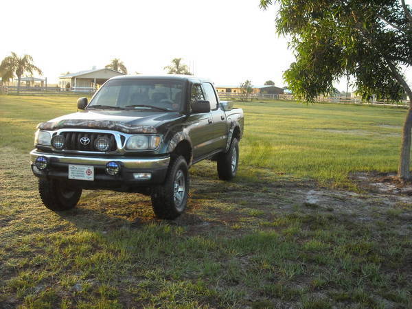

    offroad fog and lights,pa,rough country suspension kit 2.5 inches,and leveling kit in the front.bilstein 5100,4X 150 watt lights
    I attached to elbow brackets from home depot and purchased four u bolts to mount them on the grill along with drilling 3/8 hole for the lights to mount on to the total cost was about fifteen dollars. [​IMG]
  11. Aug 24, 2009 at 7:12 PM
    vinster8
    vinster8 [OP] Well-Known Member
    Nov 21, 2008
    #10926
    75
    San Diego, CA
    07 PreRunner 4x4
    So Far BHLM, CB Radio
    hmmm i like that idea, ill try that once i get my new truck
